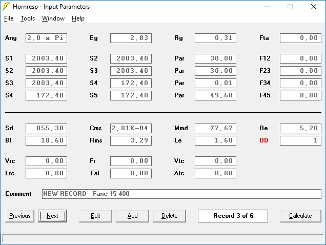

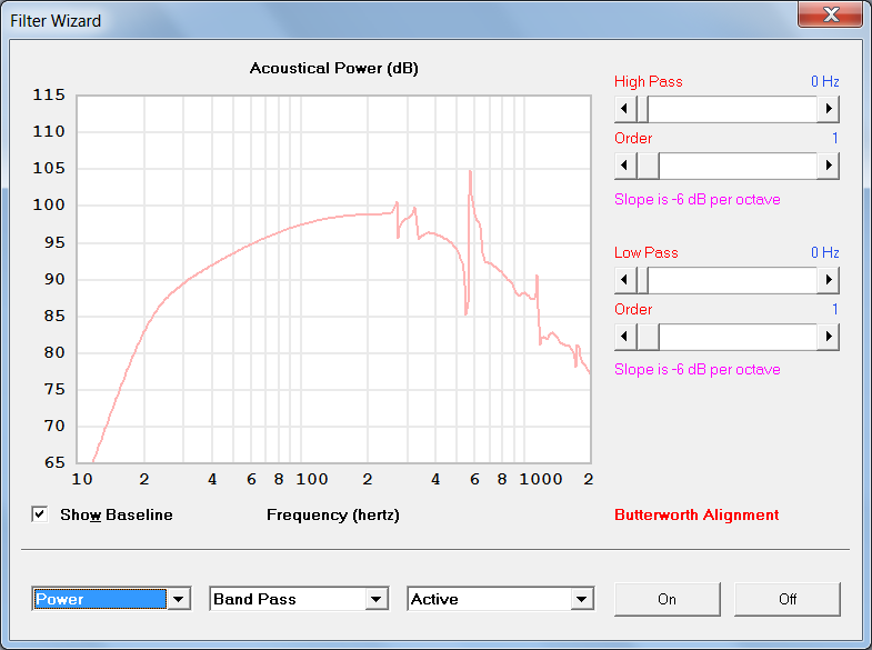

Just me getting "Run time error 6': Overflow" when simulating a classic compact BR enclosure and trying to run the filter wizard?
It seems to work fine on sealed boxes.

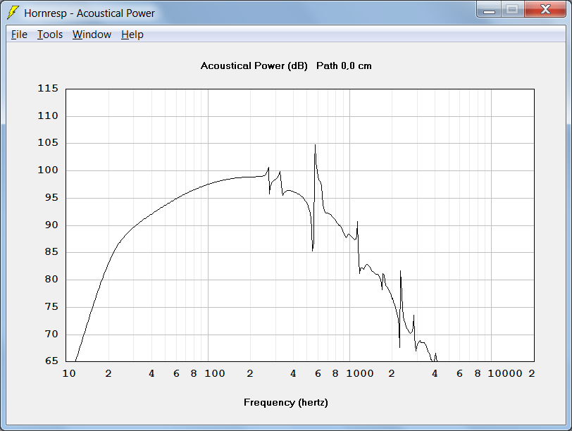

Why does the frequency response curve of a speaker in CB have a high-frequency decay? Does this graph come from the Thiele-Small parameters? According to the documentation, the driver has an amplitude response up to 2 kHz, but the program draws a decline.

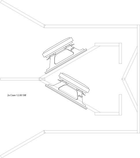

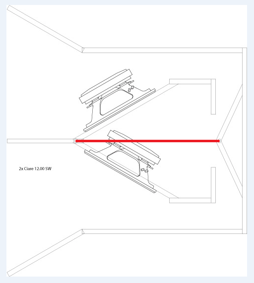

Here is another old school design that i've been looking at. But what I've done is add 2 drivers in push/pull configuration. I'm not sure if this would really be a push/pull because the shape of the plenum is triangular. The drivers are also in the path of the horn similar to a TH. In previous posts just recently I think someone mentioned that drivers in the horn path is a bad thing?
Can this design be simulated in Hornresp? Or would this just be a bad design all together? The PDF contains some dimensions and is full size.
I am no expert on this matter. But it seems to me that Hornresp calculates the effect of the construction, on the basis of electric properties and basic mechanical properties, and does not take into account all relevant other physical properties of the driver. It is a form of simplification, probably with some unknown factors just calculated out of the values you have to provide to give a more realistic estimate. But that's all it is, an estimation, but it usually comes very close to the finished construction.
So (especially on high frequencies) you are often seeing the effects of the box/horn not including the frequency response of each and every driver.
Hi KaffiMann,
Thanks for the feedback.
So that I can investigate the problem further could you please post a screenprint of the Input Parameters window for the bass reflex design causing the error.
Are you using the latest release of Hornresp, Product Number 4230-170827?
Kind regards,
David
Hi Orion33,
If you are looking at the combined output then you are seeing the power response (non-directional) rather that the pressure response (directional) which is why the high frequency performance seems less. The pressure responses of the two individual outputs can be shown using the Directivity tool, but not the pressure response of the combined output (because the precise relative positions of the two outputs are not known to Hornresp).
Hi johnnyjo,
Using the principle of images, assume that the chamber is split into two as shown in the attachment and simulate one half of the enclosure as a tapped horn with a single driver, with the "half system" radiating into half the actual space (for example, if the whole system is intended to radiate into 2 x Pi then simulate the half system radiating into 1 x Pi). Having only four segments available, you will need to approximate the expansion rate of the horn.
Kind regards,
David
Hi KaffiMann,
Kind regards,
David
Hello!
Yes it is the newest version.
Here you are. 🙂
Thank you for a wonderful program, it is very frequently used.
Is there any way I can donate as a small token of my appreciation?
Hi KaffiMann,
Thanks for the information. Unfortunately I have not been able to replicate the problem you are experiencing, using your input parameter values. The Filter Wizard opens just fine for me. You could perhaps try importing the attached file, which is an exported copy of the record I entered. If it works, then it would seem that the filter data in your original record must be corrupted in some way. If it doesn't work, then I have no idea what might causing the overflow message.

Just noticed there is a 1 byte difference between your file and the one I imported from a previous version of hornresp, think it was v42. The filenames are the same length. Something must have happened during exporting/importing I guess.

Timely post! I just discovered this last night experimenting with the directivity tools. The term "power" should have been an obvious clue, right? 😉If you are looking at the combined output then you are seeing the power response (non-directional) rather that the pressure response (directional)....
Hi KaffiMann,
Just to clarify - does this mean that the record I posted works okay, and does not generate the overflow error?
Kind regards,
David
Hi Pano,
As far as I am concerned, yes, but my decision to use the term "power response" has proved to be a controversial one, to say the least 🙂.
http://www.diyaudio.com/forums/subwoofers/119854-hornresp-637.html#post4754696
Kind regards,
David
Perhaps a small label with a pop up description of the difference? Many people are getting hung up on this point.
It's an understandable hangup, because so many sims show the on axis response by default and so do measurements. Since Hornresp seems to get heavy use for bass horns and enclosuers, the power response makes a lot of sense with the wavelength concerned.
