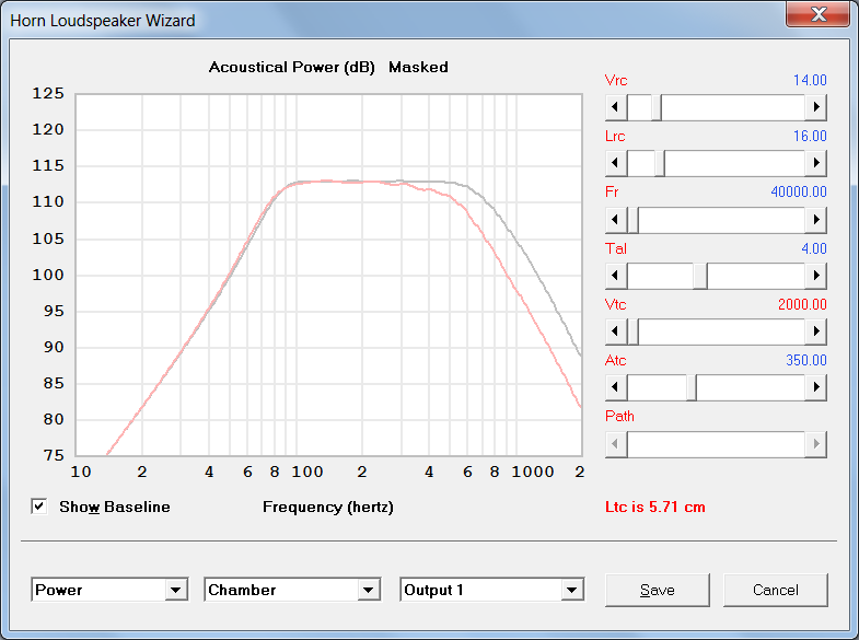

In HR, the Vtc parameter represents the volume of air trapped between the cone and the horn wall. Also note that the area (Ap) and length (Lpt) of the ports through the horn wall also affect the response and can be tuned to affect the slope of the roll off.
Just to clarify - Ap and Lpt specify a rear chamber port. Use Ap1 and Lp to specify a port between the throat chamber and the horn wall.

In simulating front loaded horns, what causes the low pass behavior?
Primarily the throat chamber - it acts as a low pass filter. The effect on the power response can be demonstrated by taking a copy of the default record, opening the Loudspeaker Wizard, and adjusting the value of the Vtc slider. High frequency performance is of course also affected by the driver parameter values - try increasing the Mmd and Le slider values.

Excellent David. A thousand thanks. I'll do as you suggest and experiment with those settings. :up
