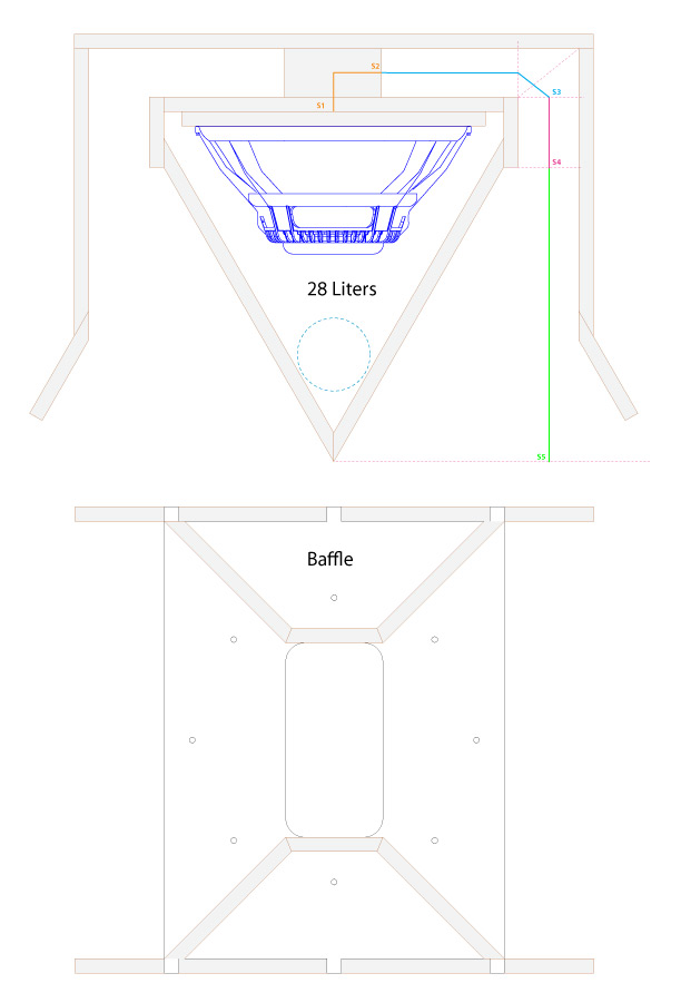

Need some help here. I am designing a variation of the LaScala. In this design the woofer is reversed facing the back and the sound energy is split as it exits into the horn from the baffle. Would just measuring the sound path on one side be sufficient? See attachment.
I also wanted to show the baffle to explain why I have so many sections. I'm using reflectors back there to create a bit more expansion.

Hi johnnyjo,
Sorry to break up the wood talk woodsters.
Yes, that will correctly specify the axial length of the bifurcated horn system.
(The cross-sectional areas of the two sides of the horn need to be added together, however, when determining the values of S1, S2, etc).

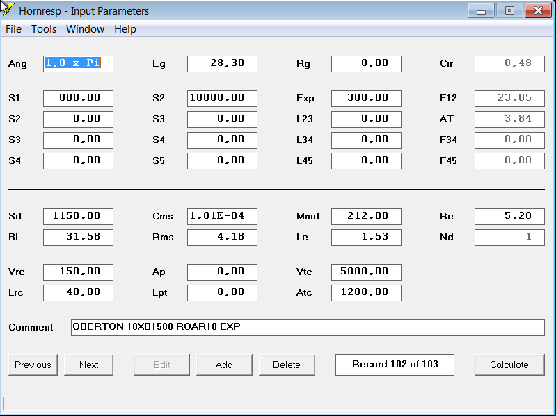

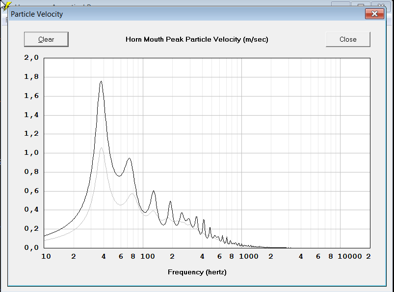

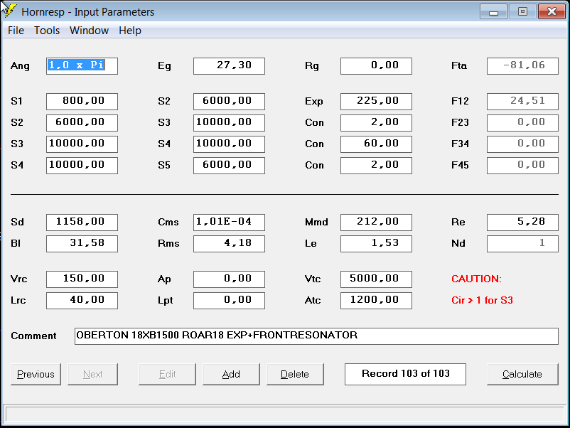

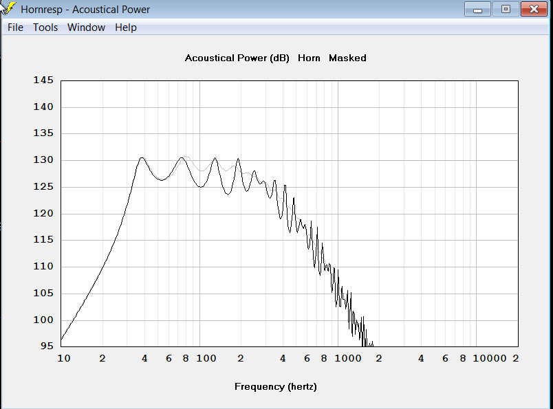

I tried to simulate a normal exponential horn and a front resonator enhanced exponential horn with roughly equal behavior in the bass range.
Grey lines is the pure exponential horn and the black line is the front resonator enhanced exponential horn.
The constriction in the open end of the quarter wave resonator (front resonator) creates a substantial increase in particle velocity. If Hornresp does not account for the exponential increase in air particle momentum and the effects of inertia which get quite substantial at 140 dB and above, then I don't think it will predict the maximum spl and power compression correct.
