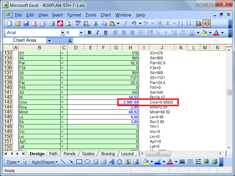

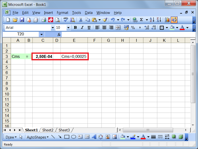

Attachment 1 shows the BOXPLAN results (Cms format changed to scientific notation to be consistent with Hornresp). Notice how entered values have a comma as the decimal separator, whereas the concatenated export strings have a period.
Attachment 2 shows my attempt to do the same thing for Cms. In my case however, both the entered value and the concatenated string have a comma as the decimal separator.

2. How do you maintain the decimal separator in the export file as a period, even when the chosen regional setting is such that the decimal separator is actually a comma? (It is great that you can do this, as it makes the file consistent with the export file generated by Hornresp. It means that there is no requirement to add special conversion code to Hornresp just for files imported from BOXPLAN).
Hm... I'm not sure what's going on there. I certainly didn't do anything special in the spreadsheet that creates the output file. It uses a simple concatenate() function to produce each line in the output file, that's all. If anything, it's my spreadsheet that's acting unexpectedly, as it should preserve the regional formatting, LOL. I was actually concerned that it was outputting the Cms line with Cms in simple decimal format rather than in scientific notation as it's displayed in Hornresp. Luckily that didn't turn out to be an issue preventing successful importation!

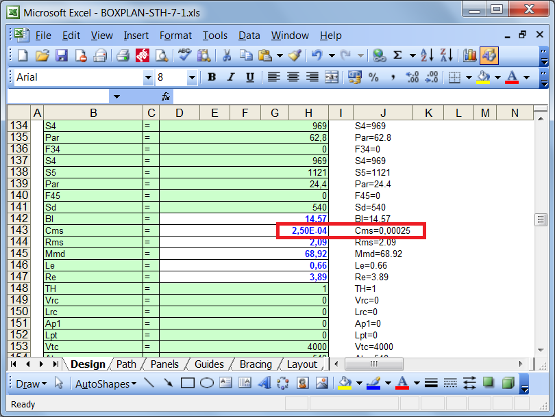

Hi Brian,
Curiosity got the better of me 🙂.
On further investigation, unfortunately when the input value changes, the decimal separator does indeed become a comma rather than a period.
This is an issue that I was hoping to avoid. It means that a BOXPLAN file exported with a comma decimal separator can not be successfully imported into Hornresp if the regional setting for Hornresp uses a period as the decimal separator. In other words, a BOXPLAN export file created by a user in France can not be imported into Hornresp by a user in the United States, for example, limiting the transportability of such files.
Do you see this as a major problem? Files can still be exported and imported provided that the decimal separator regional setting (either period or comma) does not change during the export / import process.

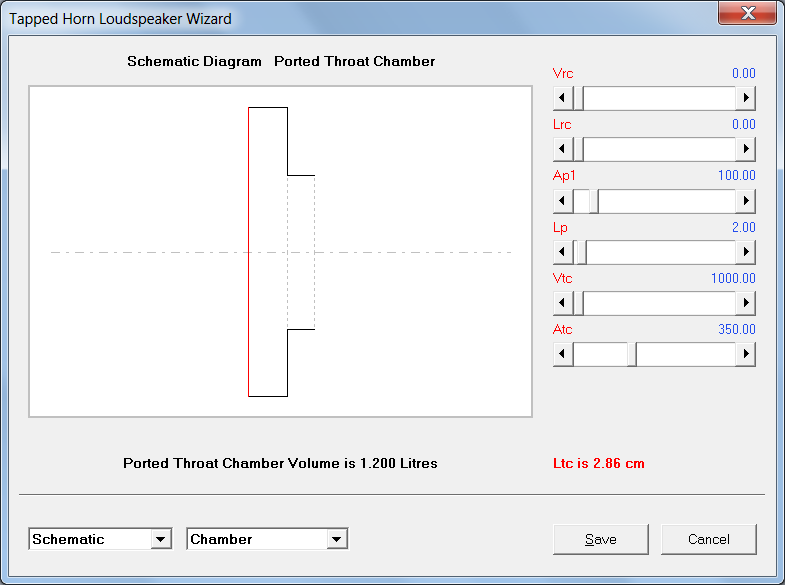

If I wanted to mount a speaker driver on a baffle that covers up a certain area of the driver, where is this information entered on Hornresp?
Does this opening in the baffle relate to Vtc and Atc?
If we're talking about tapped horns, I believe that the CSA of the opening should be entered under "Ap1" and its thickness (in cm) entered under "Lp"

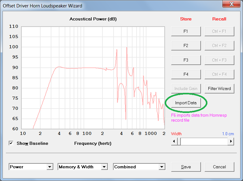

Data from Hornresp record files can now be imported into the Loudspeaker Wizard by either clicking the Import Data button in the Memory & Width window or by pressing the F6 function key when the wizard has the focus.
This feature was added so that data exported from the BOXPLAN spreadsheets developed by Brian Steele can be directly imported into the Hornresp Loudspeaker Wizard, thus enabling the effect of changes made in the spreadsheets to be immediately seen in Hornresp.
... with the air space between the driver diaphragm and baffle being specified using Vtc and Atc, with Atc usually set equal to Sd.
