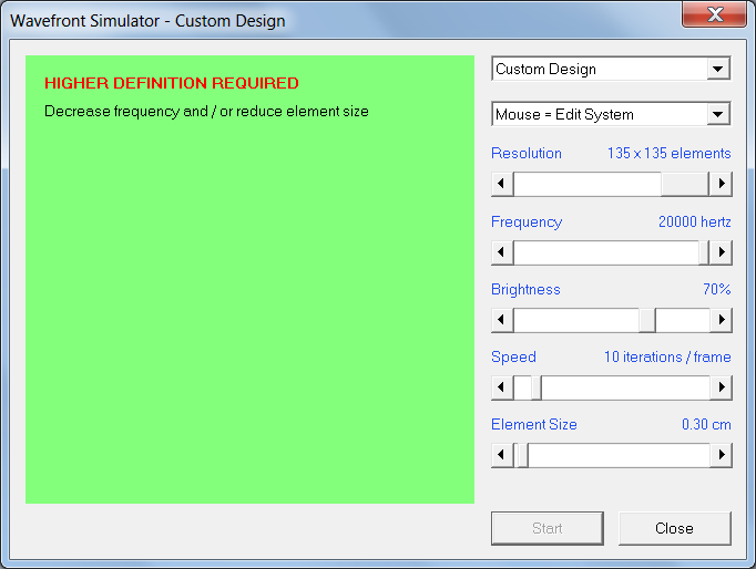

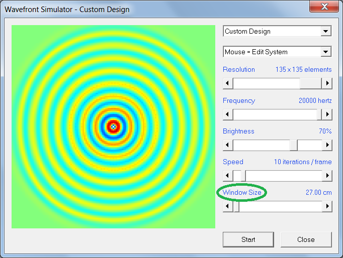

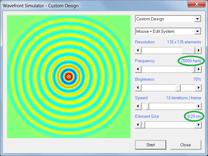

The following changes have been made to the Wavefront Simulator tool:
* Wavefronts up to 20000 hertz can now be simulated using an element size of 0.2 cm - see Attachment 1.
* Greater flexibility has been provided in specifying element and window sizes - see Attachment 2.
* Aliasing error messages are now more specific, with results being hidden while the message is displayed - see Attachment 3.

Hi Everyone,
