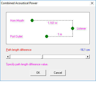

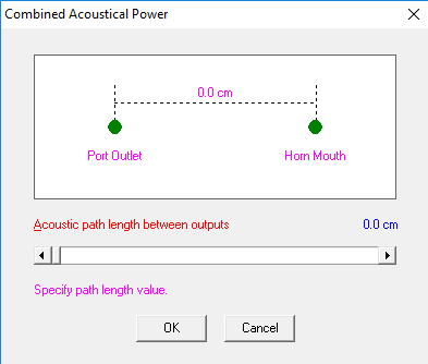

one of my designs has a front radiating driver and a horn opening at the back. How do you specify that? "Around" the box or direct distance as if, no box was there?
Hi Kurt,
An excellent question - I need to improve the explanation in the Help file 🙂. The Hornresp model calculates the combined power response assuming two coherent point sources. The direct distance separating the sources should be used - as if no box was there.
Kind regards,
David

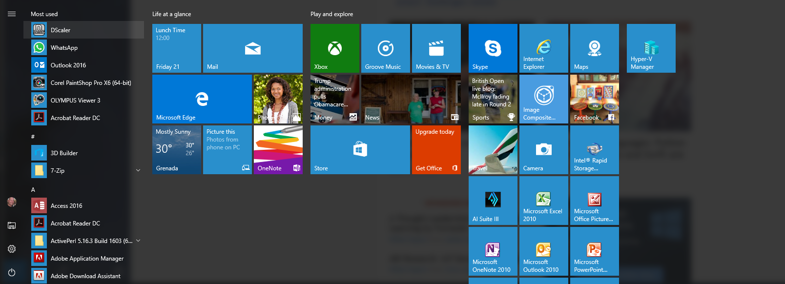

Why not use Windows' built-in Hyper-V feature? Works fine on my PC, with no issues about excessive power use. I use it to host 2 or three VMs on my home PC, and about six VMs on my office PC, with guest OS' ranging from Linux to Windows 2012 R2 server.
And you can always pause the VM when you're not using it 🙂
As for Akabak, I did as you said and just exported the HornResp sim as an Akabak script and used that. I'm not sure that I added the stub properly, so I'm going to review what I did tonight...
I never heard of hyper-v so I just looked it up. For Win 7 it sounds pretty complicated - Running Hyper-V on Windows 7!
I think I'll just use my netbook.
EDIT - since it will probably be mentioned, I have no desire to upgrade to Win 10.
No wonder - trying to run Hyper-V under Win7 is a bit like trying to retrofit a VW bus with a hybrid engine.
Hyper-V is a component of Win8 (Pro and up) and Win10 (Pro and up). I take it that you didn't take advantage of the free upgrade..?
I absolutely did not upgrade - I've only played with Win 10 for a few minutes but I prefer Win 7, it seems to run faster and I've heard things about the lack of privacy on Win 10. Starting with Win 8 things went in the wrong direction IMO. Catering to the mobile devices was a huge mistake and a detriment to the actual computer users. I don't like the mobile touch screen type interface at all, it looks dumb and doesn't provide any advantages for computer users. I spent 5 minutes with Win 8 when it came out and I wanted to throw the computer out the window.
The upgrade is still available and still free but I'm not interested, at least not at this point. I'm sure Microsoft will obsolete Win 7 asap so some day soon I'll be forced to upgrade but I'm going to hold out for as long as possible until someone gives me a really good reason not to. Hyper-V isn't going to do it when I have a netbook that works fine.

OK, this thread is about HornResp, not Windows, so this will be my first and last post on the latter. I've attached a picture of what I see when I click on the "Window" icon at the bottom left hand corner of my screen - basically the same thing you do when bringing up the menu in Windows 7. Windows 10 automatically adds my most-used application list on the left so I don't have to go menu-diving or otherwise to open them. I can get to anything I regularly use easily and quickly.
As for performance, I haven't noticed any performance hits since moving to Windows 10 on most of my PCs (I did almost all of them the same day). Well, maybe on my old netbook with its 1GB of RAM. Evidently Win10's spec now says it requires 2GB minimum... 🙂

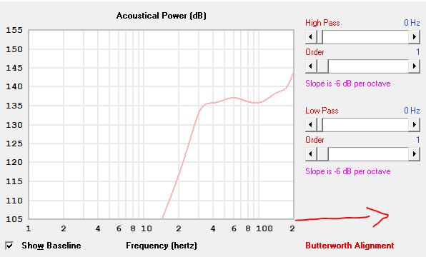

The new features around allowing filters to be used on the main screen are very welcome so thanks for implementing them.
One usability issue, or a bug, is that switching the output (horn/direct radiator/combined) selected on the acoustical power screen resets the filter state. This means you have to keep turning the filter back on when flipping between output views.
Hi 3ll3d00d,
Thanks for the feedback. It's not a bug, but I agree that it would be better if the filter could stay on when the output view is changed. I will see what can be done about it.
Kind regards,
David
