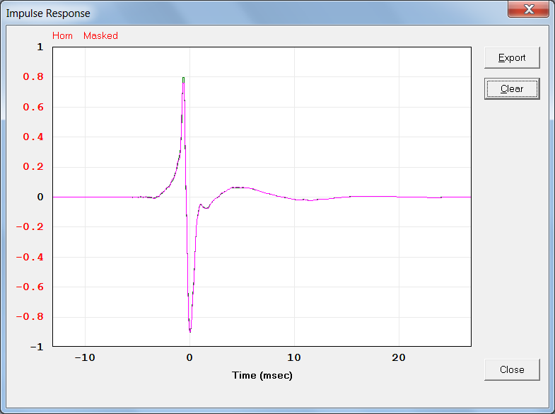

1. Group delay values calculated using the 1 - 2000 hertz frequency range are ten times smaller than they should be.
2. Impulse response and spectrogram results calculated using the 1 - 2000 hertz frequency range lack accuracy due to the restricted 2000 hertz upper frequency limit. To avoid any confusion, the impulse response and spectrogram options will be disabled when the 1 - 2000 hertz range is used.
How much lack of accuracy ? If it's not a lot, then it would be More useful to keep the displays, i would think 🙂 Plus you could maybe include an alert/advice of what the % inaccuracy is, so people can take due account of it.

The inaccuracy is quite small, but it varies depending upon the design being analysed.
I would rather users just switch to the 10 - 20000 hertz chart range before using the impulse response and spectrogram options. The key algorithms, originally developed specifically for Hornresp by Jean-Michel Le Cléac'h, are optimised for that frequency range.

On further investigation it would seem that the difference in the impulse response produced using a chart frequency range of 1 - 2000 Hz rather than 10 - 20000 Hz is not enough to warrant disabling the feature when the 1 - 2000 Hz range is used. For the test examples I checked there was no material change. To illustrate, the attached screenprint shows the compared results for the default record.

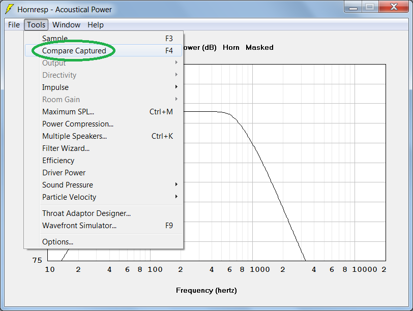

Catch 22. Didn't know that the feature existed because "compare capture" doesn't appear in the menu until you've actually captured something and there is no motivation to capture anything w/o compare capture in the menu!
All features are documented in the Help file, which can be exported into Word or similar for 'customisation' by the user.

Previous results are used in comparisons by default. Press Ctrl+C to
capture the current results or Ctrl+R to release captured results. Results
can also be captured or released by right-clicking on any chart.
Press F4 to show or hide the previous or captured results.
