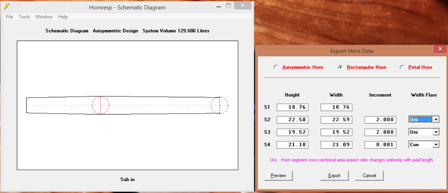

From my understanding S1 and S2 are Area in square centimeter If I make it exact number it will change the tuning?
Only way I have understood to keep the side walls parallel is to deduct it from Area maintaining one width side constant ?
Is it correct?

Yes, the tuning would change. Note your current volumes and adjust the segments until S1 and S2 have the same area and S2 to S3 have a negative flare.

On the Export Horn Data form, make all the height or all the width dimensions the same. The cross-sectional areas and tuning will not change.

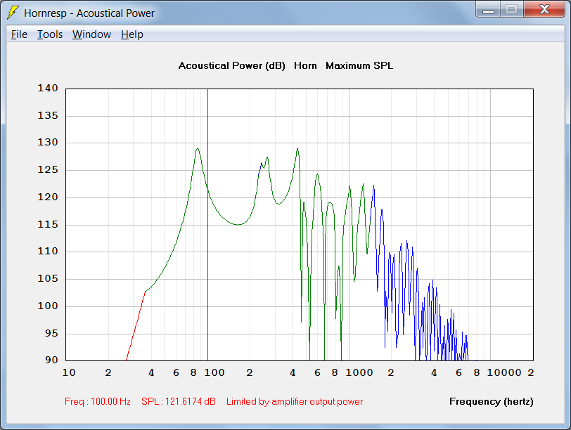

Hornresp Update 4200-170714
Hi Everyone,
NOTE
For some reason the web site page has not updated, but the new version of Hornresp can be downloaded.
CHANGE 1

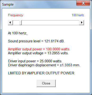

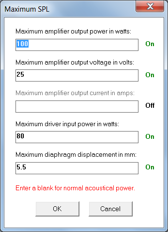

The Maximum SPL tool now has five input parameter options to choose from:
Maximum amplifier output power
Maximum amplifier output voltage
Maximum amplifier output current
Maximum driver input power (Pmax)
Maximum driver diaphragm displacement (Xmax)
Previously only the Pmax and Xmax parameter options were provided.
Attachments 1 to 3 refer.

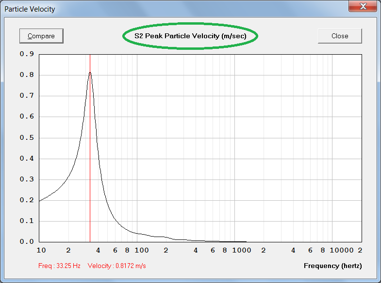

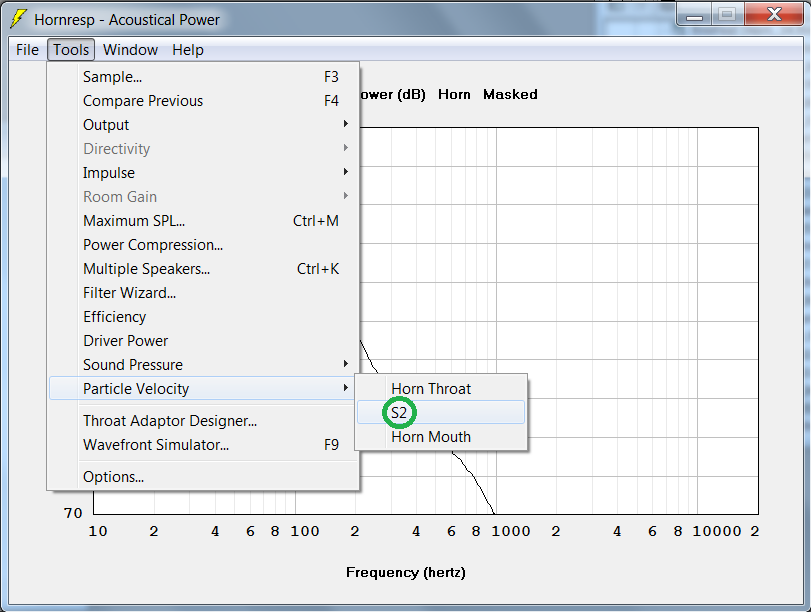

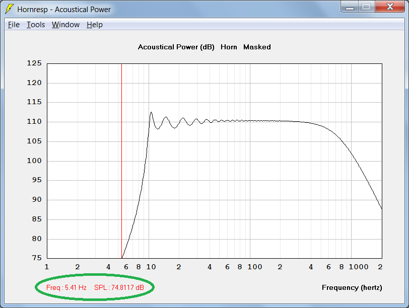

The Sound Pressure and Particle Velocity tools now show the peak sound pressure and particle velocity at the point of minimum cross-sectional area in a multiple-segment horn. Previously only the pressure and velocity at the end points were shown.
Attachments 4 to 6 refer.

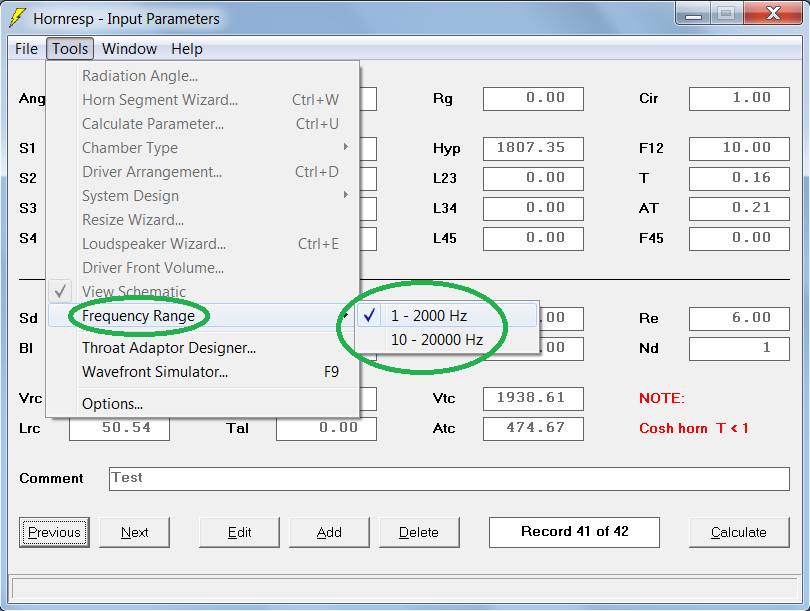

The chart frequency range can now be switched from the default setting of 10 - 20000 hertz to 1 - 2000 hertz using the Frequency Range tool. With the lower range selected, the Sample tool can be used to check results down to 0.1 hertz.
Attachments 7 and 8 refer.

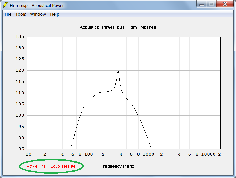

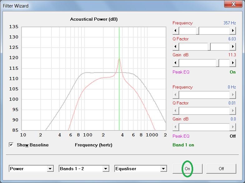

Filter Wizard tool settings can now be taken into account when calculating the main results. Click the wizard On button to use the current active and parametric equaliser filter settings, and click the Off button to not use the filter settings.
The pre-calculation Filter tool is no longer required, and has been removed.
Attachments 9 and 10 refer.
