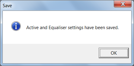

When I go back and forth between two records some settings are cleared and others are changed.
Hi Jack,
Just to clarify - when you say that some settings are cleared and others are changed, is that for the same filter type? For example, are some of the equaliser settings cleared and others changed?
Do you get the attached confirmation message after pressing the F9 key?

Yes, I get the confirmation message.
To clarify: my full set of equalizer settings is 2 pole LPF, 4 pole HPF, a PEQ and a low shelf using 5 of the 6 bands. After going to the 2nd record and coming back, I would find the HPF and LPF bands "off" and 2 PEQs enabled. One of those PEQs had been the shelf filter. The other had been used as a PEQ but its frequency and Q had changed.

That's a pity - I was hoping that your F9 key might be faulty, but it seems not, if you are getting the confirmation message 🙂.
Thanks for the clarification. I set up the same filters as you, pressed F9, moved to a different record and then returned to the original record. All the filter settings were preserved exactly as they had been entered. I then closed and re-opened Hornresp, and checked that the settings were still correct.
There is something really crazy going on here - why only you? It just doesn't make any sense.
I assume that you are definitely using Product Number 4100-170621?

I don't know whether you have an SSD drive in your computer or not..? I have seen two different SSD drives behave similar to what you are describing due to buggy or incorrect drivers.
On the first occasion the SSD drive had been swapped out for another after the original failed. That drive was from the same manufacturer but was a newer, revised unit. When Windows loaded after swapping in the new SSD, it loaded a slightly different driver (from the same manufacturer) than it had assigned for the original SSD. Everything worked pretty well until an SQL database was opened, then it intermittently failed on writes to that database and eventually corrupted it. The fix was a simple removal of the assigned driver, then choosing the original (and proper) driver manually.
The second occasion this sort of thing happened was after a new SSD install. Windows loaded a generic driver that made the new SSD act like it was some sort of file caching device. Loading the proper driver manually fixed that one too.
If your computer has an SSD drive I suggest looking into a possible driver issue. Hope this helps.
thanks
I agree, it does sound like a caching problem. However, while I do have an SSD drive, Windows tells me I have the best driver for it and the problem also occurs using an external rotating drive.
I will look on Western Digital site anyway for a driver ...
