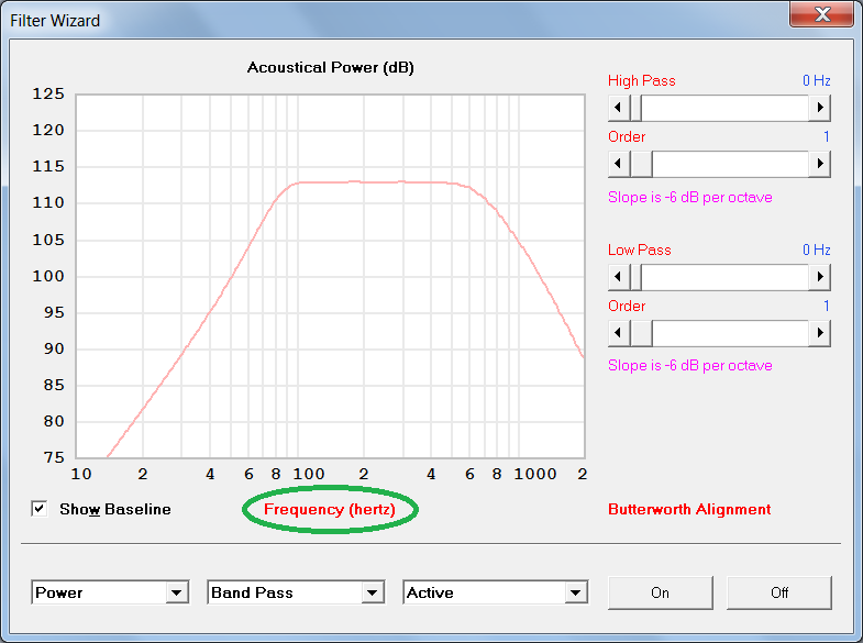

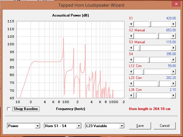

I noticed that if you select the 1 - 2000hz frequency range the filter wizard is out of range.
Hi USRFobiwan,
This is no different to how things worked originally, when there was only a 10 - 20000 Hz frequency range 🙂.
With the 10 - 20000 Hz range selected, the filter and loudspeaker wizard charts show 10 - 2000 Hz by default. Double-clicking on the 'Frequency (hertz)' label at the bottom of any chart changes the range from 10 - 2000 Hz to 100 - 20000 Hz.
With the 1 - 2000 Hz range selected, the filter and loudspeaker wizard charts show 1 - 200 Hz by default. Double-clicking on the 'Frequency (hertz)' label at the bottom of any chart changes the range from 1 - 200 Hz to 10 - 2000 Hz (see attachment).

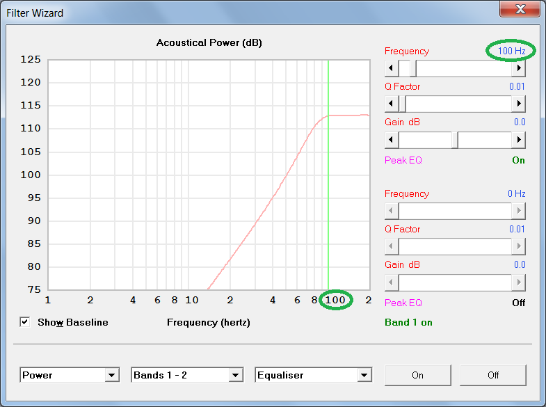

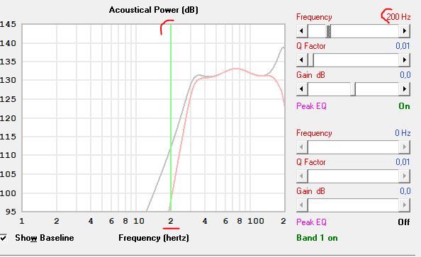

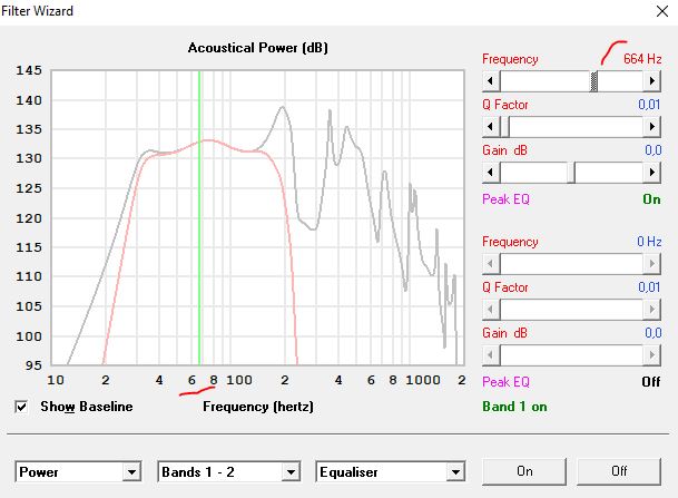

I think this one is a bug, When in 1-2000hz mode, in filter wizard, the EQ frequency selection is way of.
Hi USRFobiwan,
Thanks for the feedback. You are correct, the frequency is out by a factor of 10. I noticed the same thing myself a few days ago, and have already updated the code 🙂. It will be fixed in the next release - see attachment.

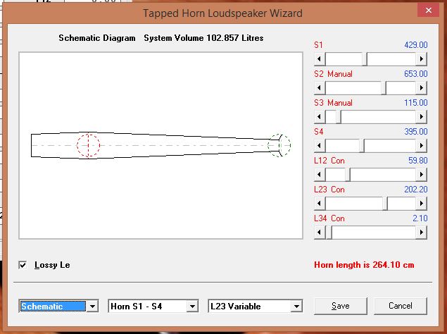

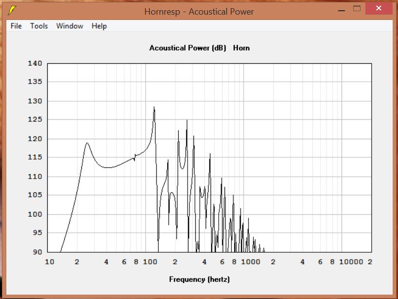

By no means I am able to make the response smooth shown in figure below. I have been trying various values for last one week.
Is this driver not suitable for Horn or TH enclosures?
My goal is to get a flat response from 25 to 100hz without filters or minimal fillings.
regards
Not a comment about HR, but you have 23 -100 +4/-3dB. A notch filter at or otherwise crossed below 130, depending on taste and or design criteria. Does not look bad. 🙂

I have achieved this in below pic with lot of tweaking but the spl output in such a configuration for a 100+ litre enclosure is poorer than a Ported enclosure with half volume.
And I guess the below figure is not a tapped horn but some kind of tappered QW tube?
I am afraid if a such a tapered tube makes sense when goal is to design Tapped Horn ( higher efficiency is requirement).
A horn should have a Incrementing mouth Dia I believe.

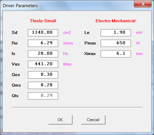

input for an Eminence Sigma Pro-18A-2
I type in 1140 for Sd and when I type in .24 for the Cms it changes it to 2.40E+01
When I double click Mmd it asks me if Sd and Cms are correct I hit yes it asks for Fs, I enter 28. It then says Calculated value of Mmd cannot be less than 0.01
Hi tkroeker,
The Cms value of 0.24 mm/N given by Eminence needs to be converted to units of m/N for entry into Hornresp.
Conversion: 0.24 mm/N = 2.40E-04 m/N
If you double-click the Sd input box you can directly enter the Thiele-Small parameter values instead (see attachment). The T-S values will be automatically converted to the equivalent electro-mechanical parameter values.
