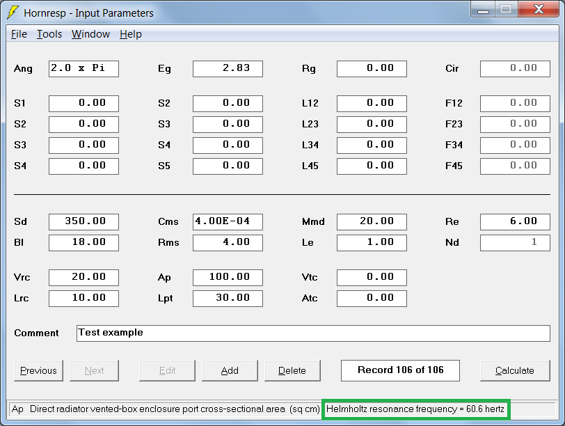

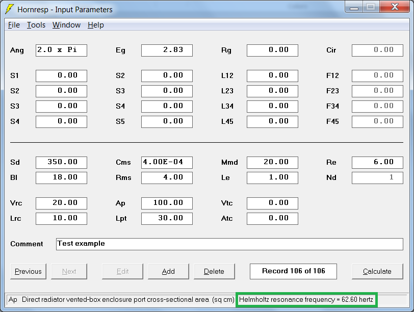

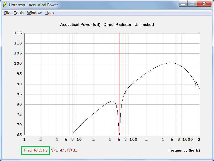

CHANGE 1
The Helmholtz frequency calculated for a bass-reflex loudspeaker system now exactly matches the frequency of the resonance point shown in the response charts.
Hornresp previously modelled the chamber as a simple compliance Ca and the port tube plus end corrections as a simple acoustic mass Ma, with the Helmholtz frequency being given by the standard resonance formula:
Fh = 1 / (2 * Pi * (Ca * Ma) ^ 0.5)
The above simplified lumped-element model breaks down when the dimensions of the bass-reflex system become such that the chamber and port tube no longer behave as a simple compliance in series with a mass.
Depending upon the dimensions of the bass-reflex system, the results now calculated by Hornresp for Helmholtz frequency (and also for port tube length when the Calculate Parameters tool is used) can be somewhat different to those calculated by other tools and simulation programs based on the standard model. Theoretically Hornresp should provide the more accurate predictions 🙂.
Test example:
Vrc = 20.00 litres
Lrc = 10.00 cm
Ap = 100.00 cm^2
Lpt = 30.00 cm
Old method with resonances not masked:
Calculated Helmholtz frequency = 62.6 Hz (see Attachment 1)
Actual chart response resonance = 60.6 Hz (see Attachment 3)
Difference = 3.3%
New method with resonances not masked:
Calculated Helmholtz frequency = 60.6 Hz (see Attachment 2)
Difference = 0.0%
My thanks to 'bolserst' for another very interesting and productive collaboration, which has resulted in the development of this refinement.

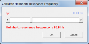

As a result of Change 1 it was necessary to also modify the Calculate Parameter tool associated with Lpt. Attachment 4 shows the old tool, and Attachment 5 shows the new tool.

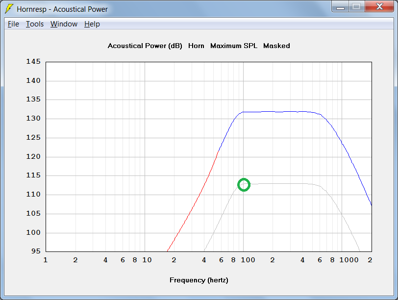

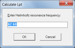

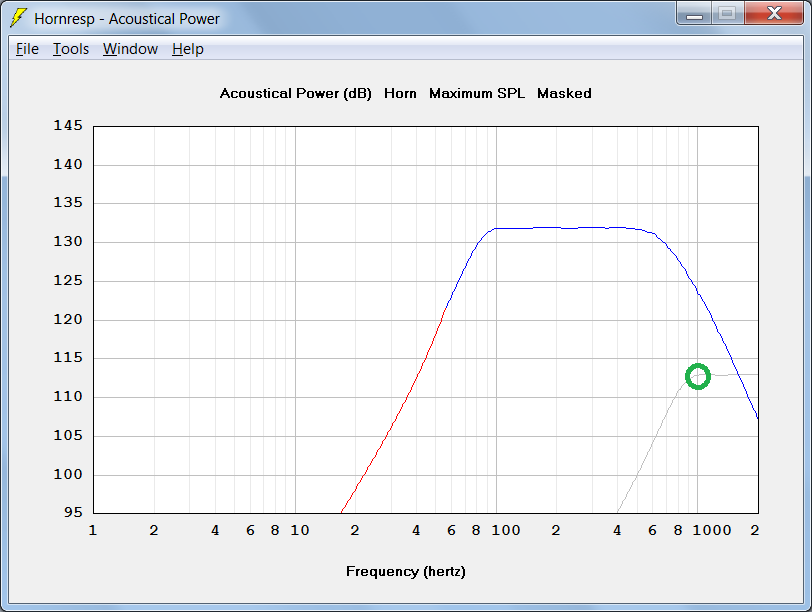

BUG FIX 1
Previously the following sequence of actions would produce the outcome shown in Attachment 6. The frequency range change was not being taken into account correctly in the comparison results. This has now been fixed - see Attachment 7.
Actions:
1. Calculate results for default record 1.
2. Return to the Input Parameters window and change the chart frequency range.
3. Recalculate results for default record 1.
4. Use the Maximum SPL tool.
5. Compare previous results.
The problem would also occur if the chart frequency range was changed and either the Output, Directivity Response, Power Compression or Multiple Speakers tool then used.
