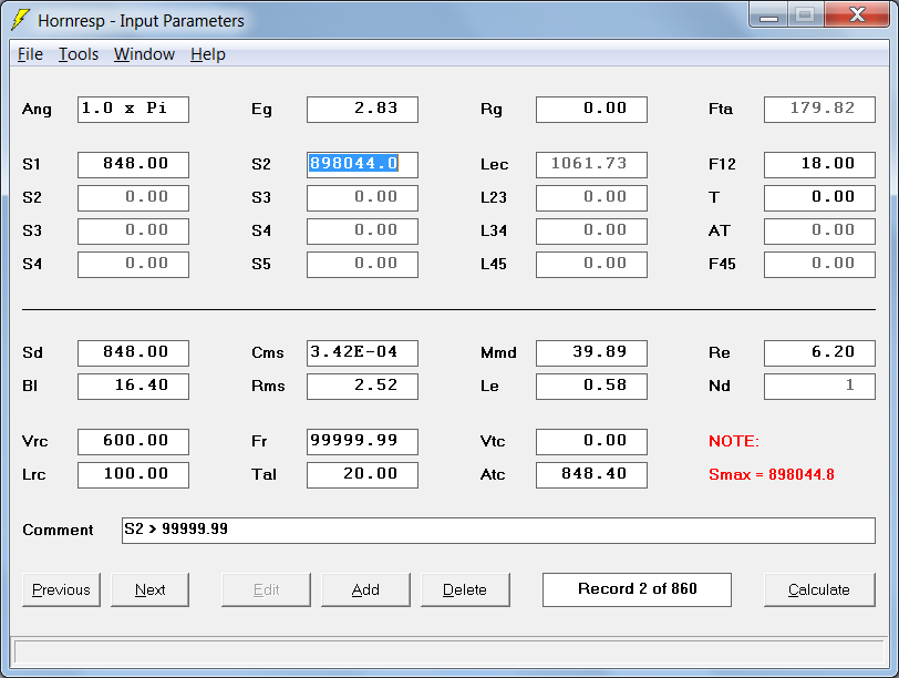

I hit the S2 limitation 🙂
No big deal since I can half the space and drivers. But the optimizer chooses 23 instead of 21 for low cutoff.
Hi Mårten,
For the given Ang and driver input parameter values, and without the 99999.99 sq cm S2 limitation, the 'System Design With Driver' tool would specify the following hyperbolic-exponential horn:
S1 = 5879.15
S2 = 213534.69
L12 = 515.56
T = 0.66
fc = 21.01 Hz
I doubt that many people would be interested in building a horn with a length of 5.16m and a mouth size of 4.62m x 4.62m 🙂.
Note that for the Le Cléac'h horn only, because the mouth flare tangent angle can be up to 180 degrees, the S2 upper limit is 999999.9 sq cm.
EDIT -
I forgot to mention that the frequency range shown by the tool is just a suggestion. There is nothing to prevent you from specifying 21Hz rather than 23Hz for the low frequency rolloff.
Kind regards,
David
I am! 😀
I would like to see the S2 limitation go away (or at least go up). I sim horn stacks regularly and 22 hz in 2 pi is as low as you can go. I know there are ways both inside Hornresp and by using Leach's math without using Hornresp to get around this limitation, but it would be nice if there were no limits to S2.
One other thing I would really like to see is the ability to export .frd and .zma files now that Hornresp is using .frd files. Exporting would be endlessly useful by allowing Hornresp sims to be viewed and manipulated in other software (like crossover design programs) without having to do the lengthy process of creating them from a picture of a response graph. As I mentioned when this was first discussed, IMO exporting .frd and .zma is a lot more useful than importing.

Hi Mårten,
In the next release, the S2 upper limit for a hyperbolic-exponential horn will be increased to 999999.9 sq cm, the same as for a Le Cléac'h horn.
Kind regards,
David

Hi just a guy,
As indicated in Post #4992, the S2 limit for a hyperbolic-exponential horn (exponential when T = 1, conical when T = 99999.99) will be increased to 999999.9 sq cm in the next release.
A 10m x 10m horn mouth should be large enough, surely?
Why not just use the Multiple Speakers tool?
As far as I can determine, the format of a .frd file is the same as that of a .txt file. Have you tried using use the existing 'SPL + Phase' and 'Ze + Phase' exported text files, but with the extension renamed from .txt to .frd?
I am not familiar with the format of a .zma file.
Kind regards,
David

Hi just a guy,
Yes, that should keep me busy for awhile. That will be very handy, thanks very much.
I'm not sure how that would help. If I'm using your wizard (Leach's math) and I want to see the response of a 20 hz horn in 2 pi space and I bump up against the S2 limit, how is the multiple speakers tool going to fix that? I'd have to use Leach's math outside of Hornresp to design the horn and chop it up into individual cabs, bring the results of the individual cabs into Hornresp and then use the multiple speakers tool. I was hoping to avoid that by just increasing (or getting rid of) the S2 limit.
