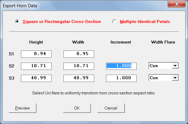

I am working on a new folded horn. I export the horn data through "Schematic diagram/File/Export/Horn Data/Multiple Identical Petals"
In order to make the folds correctly I "integrate" the volumes of the slices in my spreadsheet. The 2 cm slice is too short for my purposes.
Now that I am playing with Hornresp in order explain my suggestion I realize that the field "Increment" on tab "Square and rectangular cross section" also works for tab "Multiple Identical Petals".
So instead of asking you to implement increment function I only request that you either move the field "Increment" to a common area or just add it to "Multiple Identical Petals".
Thanks again for your work David. It has brought meaning to my life 🙂

Hi Mårten,
To keep things neat and tidy I would prefer not make any changes to the existing Export Horn Data screens, or to add a third one showing the increment input boxes only. You are just going to have to get used to setting the increments you want on the first screen, before moving on to the second one 🙂.
Kind regards,
David
I only wanted to help improve Hornresp 🙂
Hi Mårten,
I know you did, and I am very grateful for that 🙂. I have come up with a revised format for the 'Multiple Identical Petals' screen that I am happy with. It includes the increment fields as suggested, and will be implemented in the next release.

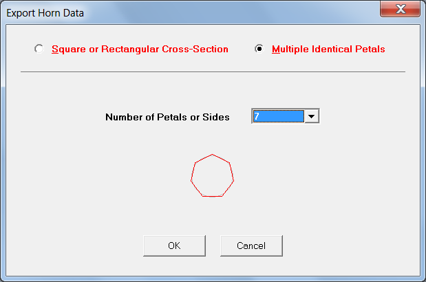

I am working with a petal design. I am having a bit of a difficulty with the petal export format. This is the header and the last line of my export:
My CAD drawing of the horn mouth:
The Area (column1) is the area of the circle, not the petal cross section.
Radius, inradius and petals are obvious.
Width/2, what is that?
When designing a horn isn't it the expanding area which is important?

I have found width/2:
If you make a petal design according to the width/2 measure, the resulting area will be the same as the circle with the diameter.
I now see that the inradius is consistent with the width/2 as well.
Could you please add one more column, the radius of the outer edge of the petal, or just change the current radius value?

Hi Mårten,
Length = axial length of petal horn
Area = cross-sectional area of petal horn at given axial length
Radius = radius of circle having same area as above
Angle = tangent angle of equivalent axisymmetric horn expanding at same rate as petal horn
The above standard values are provided for all exported horns.
Side Len = axial length of flat petal wall
Width/2 = half-width of flat petal wall at given axial length (half the 'Side' dimension shown in the attachment)
Side Len and Width/2 give the dimensions of the 8 flat petal walls
Inradius (also known as apothem) = polygon incircle radius (see attachment)
If I understand correctly, what you would also like to know is the circumradius, the radius of the polygon circumcircle (simply shown as 'Radius' in the attachment).
Kind regards,
David
Just to clarify - unless the horn is conical, the flat petal walls as dimensioned above will require bending when the horn is constructed.
Exactly David
The current radius column is useful for a round horn. Why not add a tab for round horn export and change the radius definition for the petal horn?
Hi Mårten,
Thanks for the confirmation.
Great minds think alike - I have been contemplating the possibility of doing just that, for the past two days 🙂.

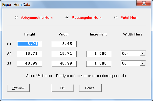

The Export Horn Data tool now has three output options:
Axisymmetric Horn
Rectangular Horn
Petal Horn
Previously the axisymmetric and rectangular horn results were exported together.
The Le Cléac'h exact profile is now selected from the Axisymmetric Horn option.

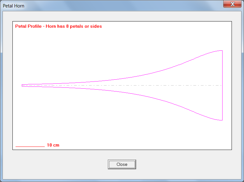

The petal profile can be previewed when the Petal Horn option is selected.
Attachment 1 shows the revised Export Horn Data input form.
Attachment 2 shows the petal profile for an 8 petal 180 degree Le Cléac'h horn.
