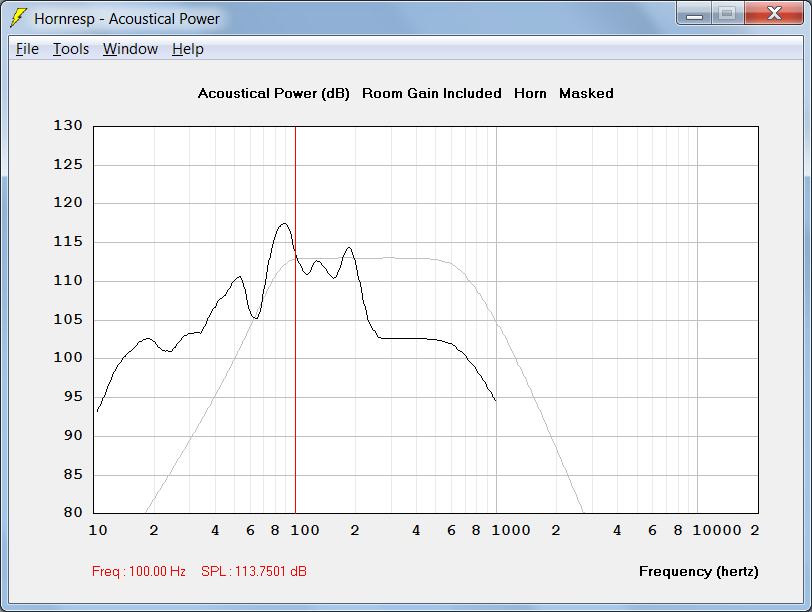

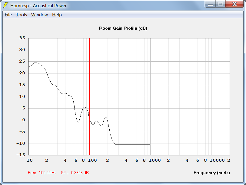

Room gain data can now be imported from a *.txt or *.frd file by using the menu command File > Import > Room Gain Profile, and the imported data can then be included in the calculated response results by selecting Tools > Room Gain from the Acoustical Power window. Room gain can also be included in the Loudspeaker Wizard results by either clicking the Include Gain button in the Memory window or pressing the F7 function key.
Room gain file data records must be listed sequentially with the first field in the record being a frequency value and the second field being a gain value. Any additional record fields in the record are disregarded. Room gain values must be relative to a zero decibel reference point.
Fields in a room gain record can be space or tab delimited, and field values can have either a period or a comma as the decimal separator.
Attachment 1 shows the room gain profile specified in the Tucson-TF.txt import file provided earlier by Brian. Attachment 2 shows the profile included in the results for the default record, with resonances masked.

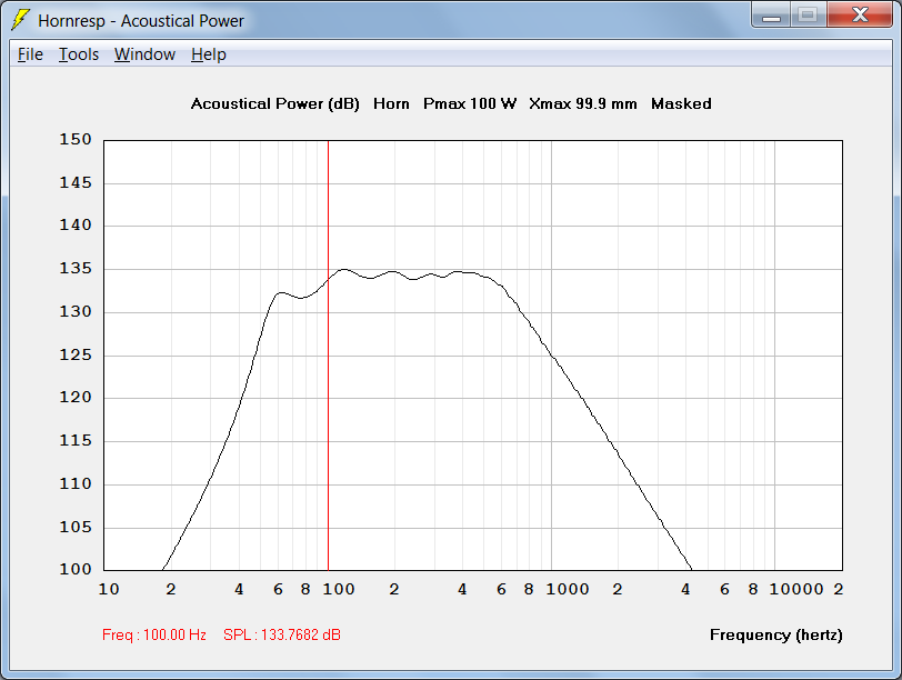

A chart has been added showing the driver electrical input power versus frequency. The new chart is selected from the Acoustical Power window using the Tools > Driver Power menu command. Click on the chart to show the power value at a specified frequency.
Attachment 3 shows the driver power for the default record with resonances masked.

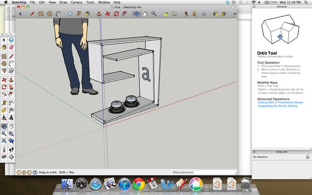

I´ve seen "2 parallell speakers" in some simulations, is that ment to be
two speakerelements in two diffrent speakercabinets?
If so, how do i do it?
I think that particular setting is for doing things like this:
Maybe this picture explains what im asking about 🙂
