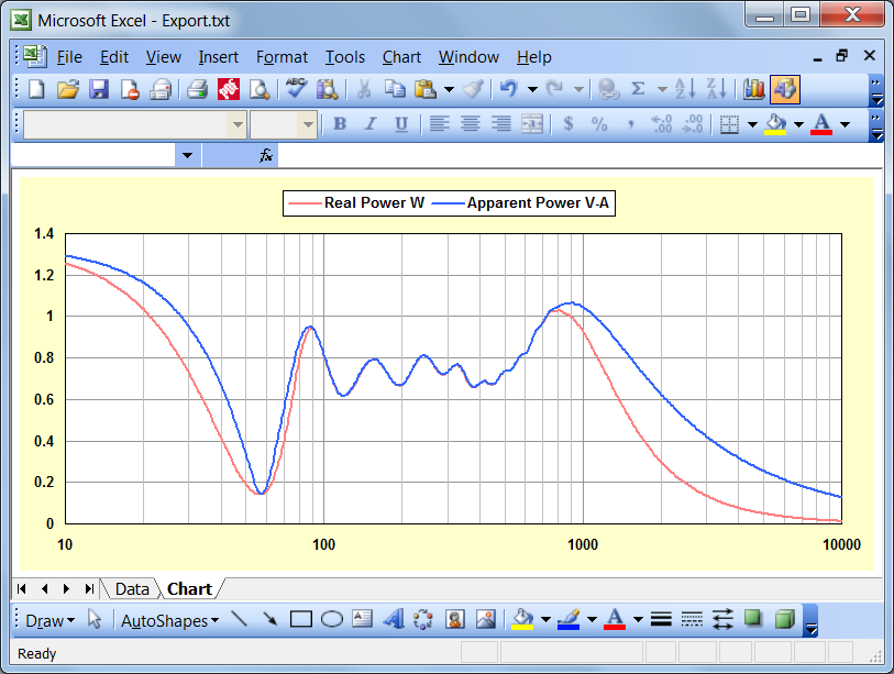

While I'm here maybe I could request a new feature.
WinISD has a screen they call "Amplifier apparent load power (VA)". It shows how much power is ACTUALLY being used.
In the screenshot below you can see that driver input voltage is set at 74.5V (1500 watts) but the curve shows that over most of the bandwidth of a subwoofer not even close to 1500 watts is being produced or consumed.
Since this info is very similar to the inverse of the impedance curve this is not surprising or even unexpected but it is useful info and it would be nice if Hornresp had this info like WinISD does. I don't think Hornresp does anything like this currently. This is especially important for people that want to push the limits of thermal considerations in their designs, and it's important because many designs simulated in Hornresp have a lot of impedance peaks, meaning that the apparent amplifier load is CONSIDERABLY different than the set voltage as set in the Eg input box over the entire design's bandwidth. Again, not surprising but good info to have.

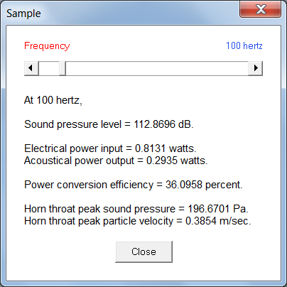

Hi just a guy,
Power actually used is real power (watts) not apparent power (volt-amperes).
Ein, Pin and Iin are listed in the Hornresp 'All Chart Data' export file, where Pin is the real power, and Ein x Iin is the apparent power.
Pin (electrical power input) is also shown in the Sample tool results for the Acoustical Power chart.
Is this functionality sufficient for your purposes?
Kind regards,
David
