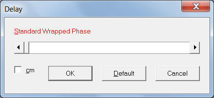

Hi just a guy,
Many thanks for carrying out the checks - it seems that the contents of the proposed .frd and .zma files will be correctly recognised by your other design software.
The SPL + Phase txt chart shows standard wrapped phase. To see standard wrapped phase in the Phase window graph in Hornresp, it is necessary to move the Delay slider to the far left-hand side (as shown in the attachment).
The difference is due to the horn length not being taken into account, as you guessed. There is nothing else going on, though.

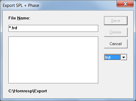

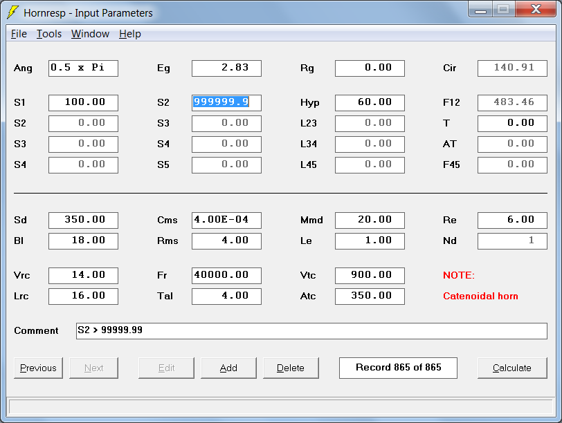

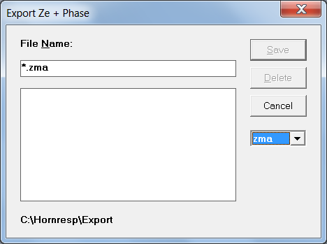

Hornresp Update 3620-141025
Hi Everyone,
CHANGE 1
The S2 upper limit for a hyperbolic-exponential horn has been increased to 999999.9 sq cm.
CHANGE 2
'SPL + Phase' data can now be exported as either a .txt or .frd (header excluded) file.
'Ze + Phase' data can now be exported as either a .txt or .zma (header excluded) file.
My thanks to Mårten and 'just a guy' for their help.

That explains why the SPL + Phase looks different than the Phase Window in Hornresp, the delay in the Phase window accounts for the horn length. I'm still not sure why the standard wrapped phase doesn't look like Bagby's phase extraction though. Shouldn't they be the same?

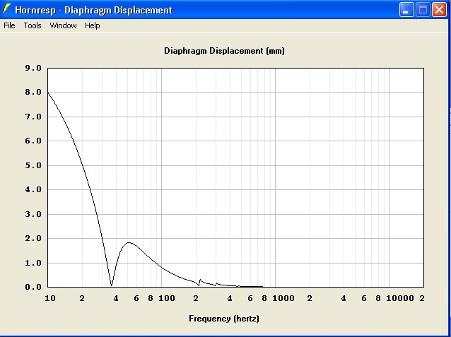

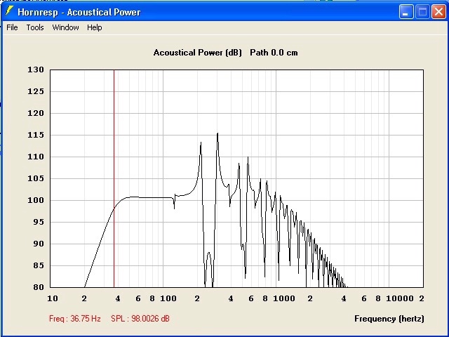

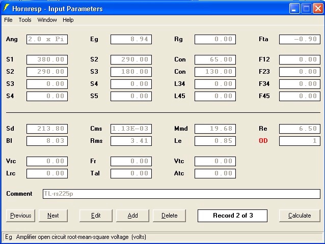

Sorry for interrupting your discussion.
I am a new hornresp user and would appreciate if you clarify something for me.
So I made a simulation with an 8" dayton rs225p woofer. Here are the results:
The power rating at driver displacement plot is 3W. That's my biggest concern... Does this mean that it will run out of Xmax(7mm) at such a low powers? Or you don't need to look at lower frequencies (below 20hz)? What are the frequencies I have to watch max displacement?
Thank you for the software and help!

That's usually solved with a high-pass filter. It doesn't take much power below tuning frequency to hit xmax or even clack formers against backplates.
