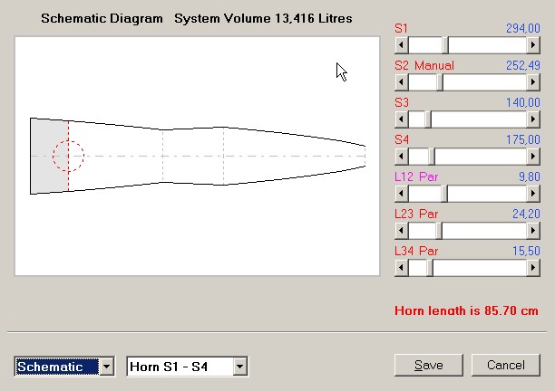

Hi Kurt,
Damping is restricted to the Loudspeaker Wizard so that the frequency range can be limited to a maximum of 2000 hertz (for the reasons given in earlier posts). The way that the calculations are done, it is not practical to include impulse response in the wizard - if it was feasible then the feature would have already been there, similar to the Filter Wizard 🙂.
Strange as it may seem, to add another segment would require that Hornresp be almost completely re-written - something that I am definitely not in a position to do. Being able to specify another segment would impact on most parts of the program.

1. Would it be possible to have the impulse response calculation take the damping material into account, now that it is stored in the record. I guess that would mean taking damping into account when calculating the combined frequency response and other things (pressing "Calculate" in the main input window).
2. I often miss one more segment, mostly because of special aesthetic considerations of folding etc., unfortunately it is sometimes it is before the driver and sometimes the need is after the driver in an offset driver configuration.

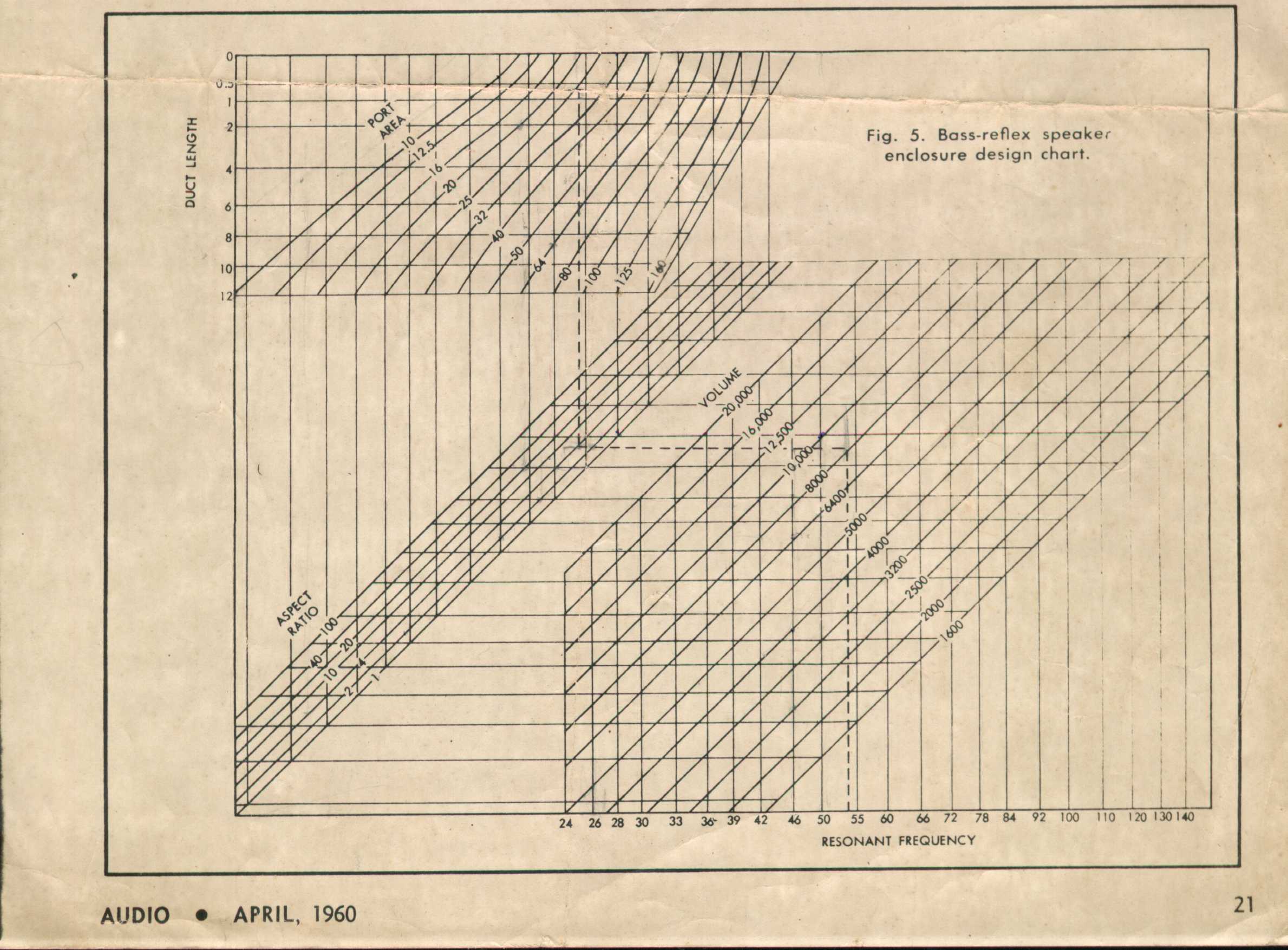

I am still puzzled by the aspect ratio of ports etc. If I do a standard BR box in WinISD of about 10 l it recommends a duct of 4 cm diameter 8 cm length, if I change that to rectangular slot of 1*12,6 cm (same area), it recommend only 6 cm length to reach the same tuning frequency.
I found and old article with a design sheet (see attached) at reflex, which (unless I have my head totally upside down) seems to move in the other direction .
So could you tell me what you think should be done in Hornresp to compensate for a 1:10 aspect ratio in a mass-loaded TQWT. As I said I have tried to ad filling to the port under the assumption that hi aspect ratio introduces a resistive element in the port but of course it is pure guesswork right now.
Still hoping, Kurt 🙂

the 4cm port has an area of 12.6cm², a 1x12.6cm slot has an area of 12.6cm²................ it recommends a duct of 4 cm diameter 8 cm length, if I change that to rectangular slot of 1*12,6 cm (same area), it recommend only 6 cm length to reach the same tuning frequency..................
But the volume taken up inside the box will be different. Sometimes very different. That internal volume of the port including it's walls affects the calculation of the port length.

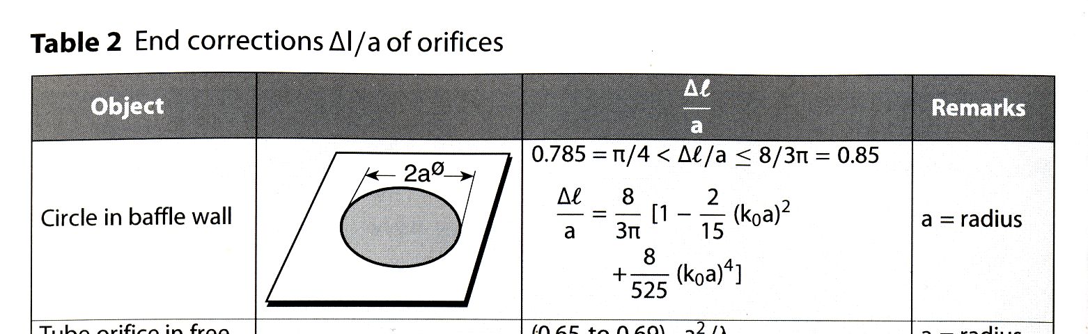

As far as I am aware, there is really nothing that can be done to more accurately take into account the effects of a high aspect ratio rectangular port in Hornresp, without actually resorting to using a proper rectangular port tube model, which is not an option in this case.
What will be the biggest difference between a circular and a rectangular tube (when used as a port), is the end correction. This is an added virtual length due to the radiation mass at the end(s) of the port. This added mass makes the port appear to be longer than its physical length. The end correction is different for circular and rectangular openings.
I would be surprised if adding absorbent material to a simulation in an attempt to "correct" for a rectangular cross-section port tube, increased the accuracy of the overall results.
It will not help, since the most significant difference at these low frequencies is in the radiation mass. Resistance is futile.
I would suggest the best way would be to figure out the difference in end correction, and change the length of the port accordingly. I.e. if the rectangular port has an end correction of 3cm, and the equivalent circular port has an end correction of 4cm, shorten the port in the simulation by 1cm. I have some equations by Mechel (Formulas of Acoustics), I can scan them and post them here.
-Bjørn
My scanner refuses to work today, but here are the formulas:
Circular duct in baffle: dL = 0.849*a
Circular unflanged duct: dL = 0.613*a
(a = radius)

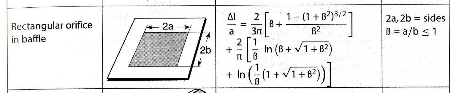

Rectangular duct in baffle, dimensions 2a x 2b, beta = a/b, a is the smallest dimension:
dL/a = 2/3pi * [beta + (1-(1+beta^2)^(2/3))/beta^2] + 2/pi * [1/beta*ln(beta+sqrt(1+beta^2))+ln(1/beta*(1+sqrt(1+beta^2))]
Since Mechel gives a more complicated formula for the circular duct in baffle (with two extra terms), I expect the last formula could be simplified to
without much error.
Hope this helps.
-Bjørn
