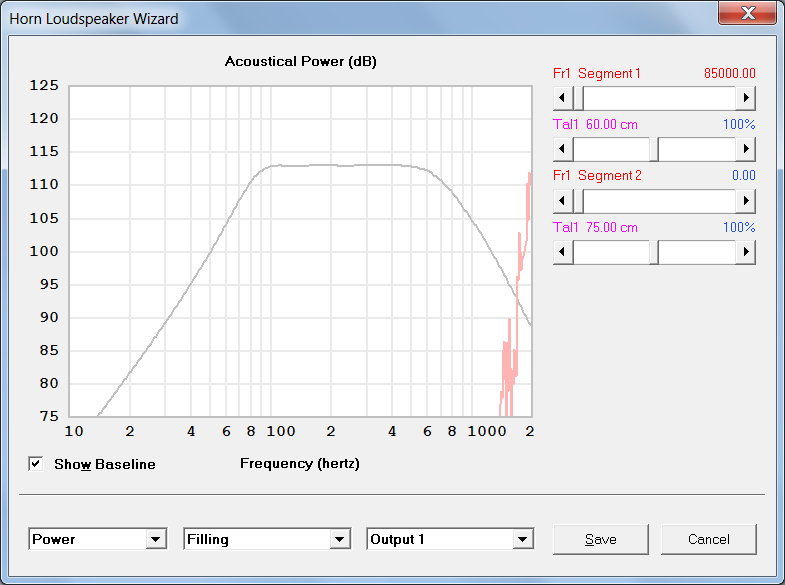

After giving it much thought and following further testing I have decided to remove the absorbent filling material > 60 dB invalid result trap but not to include any cautionary message, as it could possibly be misleading / confusing. Invalid results are unlikely to be generated if realistic values of absorbent filling material are used.
As an example, the grey trace on the attached screenprint shows the power response for the default record with resonances masked. The light red trace on the far right of the chart shows the invalid result generated when the Fr1 value of absorbent filling material in segment 1 is specified unrealistically high value at 85000. This amount of filling would never be used in practice, and the error is so obvious anyway that it should not be an issue.

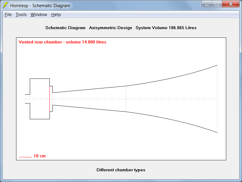

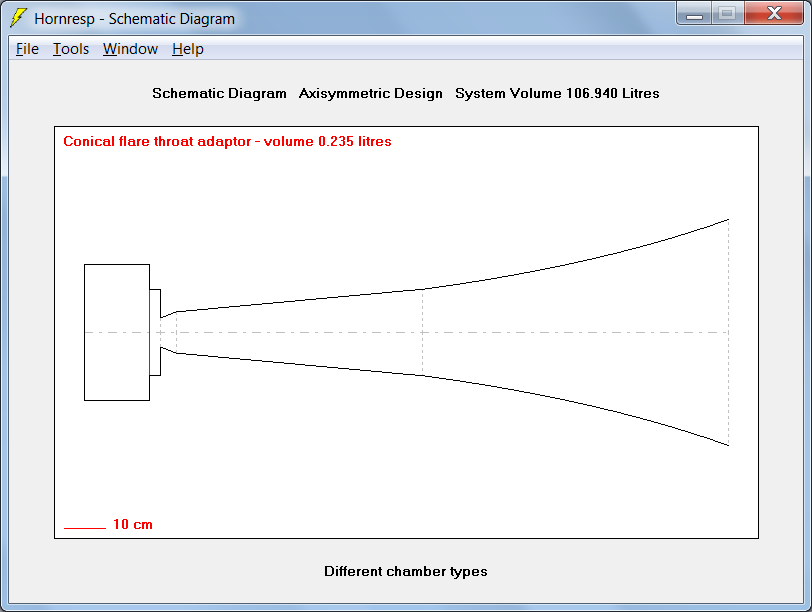

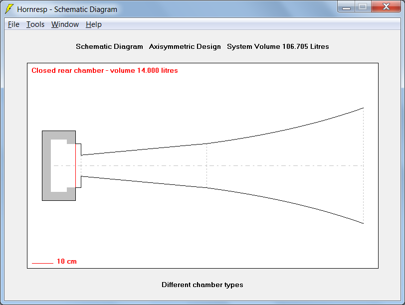

Step 1 - Make a copy of default record number 1 and change the value of Fr from 40000 to 40. Attachment 1 shows the schematic diagram. The rear chamber is sealed and lined. The acoustical lining has an airflow resistivity of Fr and a thickness of Tal.
Step 2 - Double-click on the Fr or Tal label to change to Ap and Lpt. Alternatively, select menu command Tools > Chamber Type > Rear Vented. Attachment 2 shows the new schematic diagram. The rear chamber is now unlined but vented. The port tube vent has a cross-sectional area of Ap and an axial length of Lpt.
Step 3 - Double-click on the Ap or Lpt label to change to Ap1 and Lpt. Alternatively, select menu command Tools > Chamber Type > Throat Adaptor. Attachment 3 shows the new schematic diagram. The rear chamber is now sealed and unlined but a conical throat adaptor has been inserted between the throat chamber and horn segment 1. The throat adaptor has an inlet cross-sectional area of Ap1 and an axial length of Lpt.
For offset driver and tapped horns, the throat adaptor becomes a port between the throat chamber and the entry point into the horn.
The three options will affect the system performance in different ways.

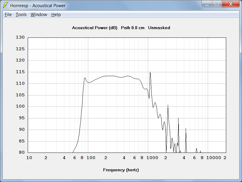

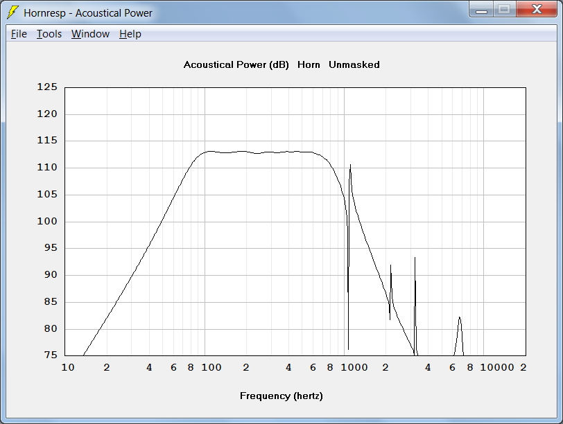

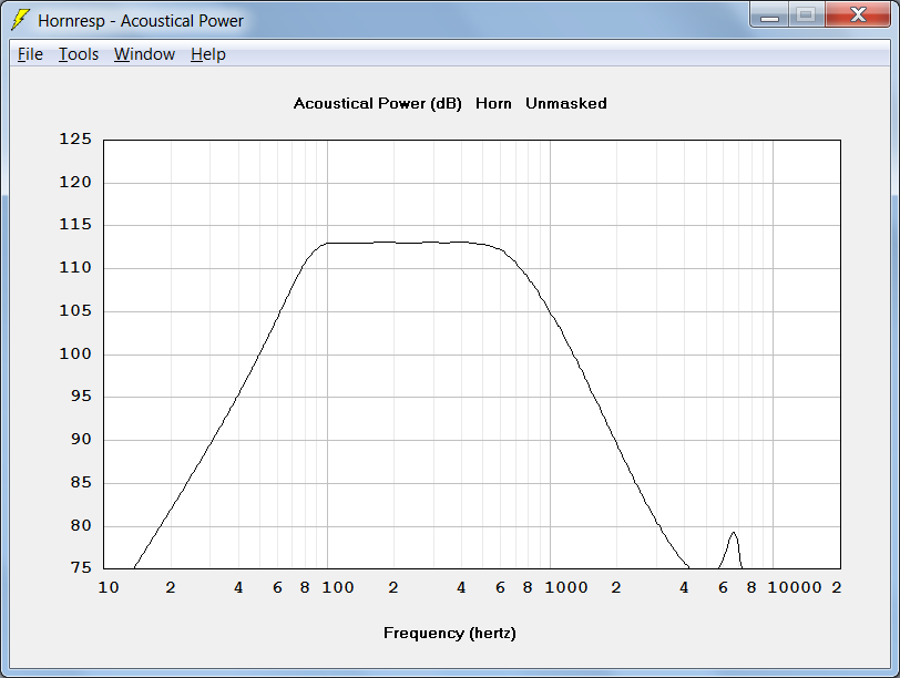

The differences in 'resonances not masked' system power response:
Attachment 1 - Step 1 configuration.
Attachment 2 - Step 2 configuration.
Attachment 3 - Step 3 configuration.

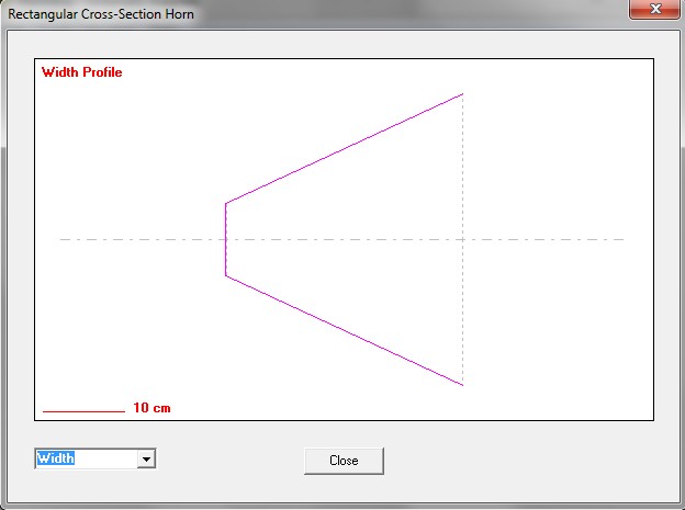

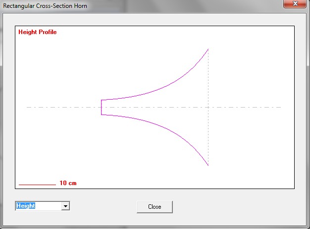

I have it now, so the next question arrives, when export to a horn I need two panels to be straight and flat (woofer on it so exp do not fit) and the other two (weight) have to be exponential flare, like on picture, How I do this?, throat has to be for example has not to be effected to much, it is 6 x 6 cm for example. I can not figure out well.
Never mind I think I have discover it now, maybe you can confirm that, see pictures.

Hi Kees,
Everything looks fine in your screenprints.
If an exponential flare is specified on the main input screen, then the cross-sectional area of the horn increases exponentially. The 'Con' width flare is used to specify two straight flat panels in the exported horn data. The curve of the two non-flat panels is given by cross-sectional area / width, where width increases linearly because 'Con' width flare has been specified. Although the horn area expands exponentially, the curve of the two non-flat panels will not be exponential when 'Con' width flare is used.
