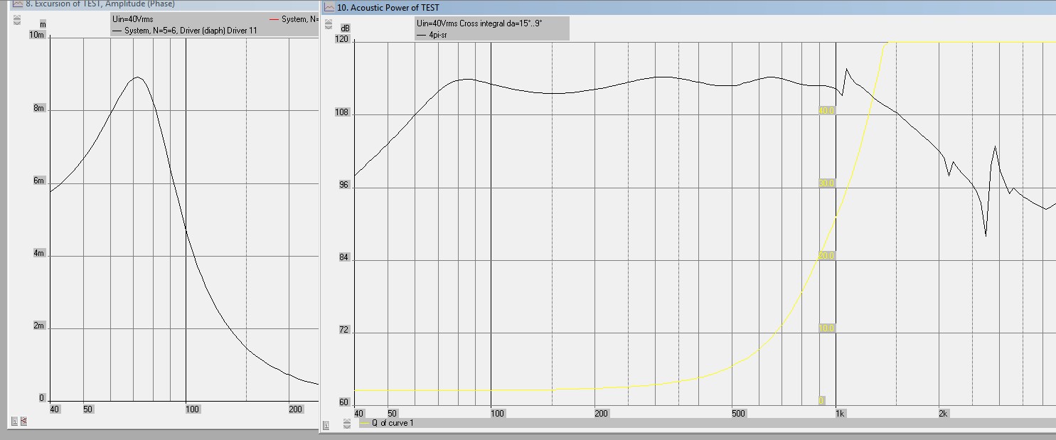

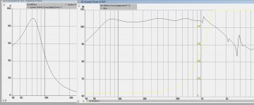

I have do it in akabak, and as you say close to baffle, I have measured the the cone distance to baffle and get this respons from it, with a basrefex port in it.
do not look bad, it is for a two way so woofer has to reach 1000 hz, but I go try also a little cone wideband in stead of a CD but think it then wil never reach 15 a 20 khz, because of the same problem.

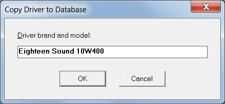

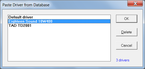

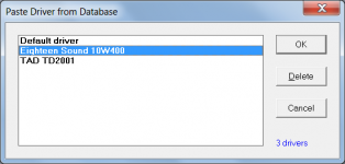

Hornresp Update 3500-140903
Hi Everyone,
CHANGE
Driver parameter values can now be saved to a permanent database. Pmax and Xmax are included as driver parameters.
File > Copy Driver to Database
Copies driver parameter values from the current record to the driver database. Not applicable to the default record. Attachment 1 refers.
File > Paste Driver from Database
Pastes driver parameter values from the driver database to the current record. The File menu command is enabled when the input parameters window is in edit mode. The menu command can also be selected by right-clicking any driver parameter label in edit mode. Attachment 2 refers.
My thanks to 'epa' for prompting me to consider adding the driver database feature.
Kind regards,
David

Wow, this is great!! Thanx a lot for this (In my mind, web-based database driver exchange possibilities pop up..... /Calm yourself, Sabbelbacke, keep cool....//)
Hi Sabbelbacke,
Of necessity the new Hornresp driver database uses a random access file, where the records are all of the same length, and where the file comprises one long data string. It would not be that easy for a user to extract a single record from the file to transfer to somebody else.
Complete database files can of course be transferred if so desired - the data is stored the Hornresp.drv file, which is located in the Hornresp / Data folder.
Parameter values for a single driver can be transferred as part of an exported data record, and parameter values for multiple drivers can be transferred in a *.dat data file created by the user, which can be accessed and edited with the Editor tool.
Kind regards,
David
Would it be possible to have the database store separate files for each driver in a folder? Or go even more crazy and give it the ability to use sql?

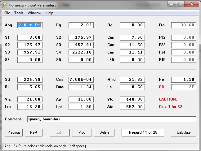

Hi Kees,
No. You divide by two when you build the actual system. As an example, assuming that you are happy with the simulation results for the system shown in the attachment and want to build it, then the following values should be used for each driver in the constructed horn:
Rear chamber volume = Vrc / 2 = 10.50 litres
Rear chamber length = Lrc = 15.20 cm
Throat chamber volume = Vtc / 2 = 224.00 cc
Throat chamber area = Atc / 2 = 278.50 sq cm
Throat chamber port area = Ap1 / 2 = 15.90 sq cm
Throat chamber port tube length = Lpt = 1.80 cm
A Synergy horn can be simulated in Hornresp, but needs to be considered as two separate systems:
System 1 - Loudspeaker with driver at the apex throat of the horn (for the higher frequencies).
System 2 - Loudspeaker with multiple drivers offset from the apex throat of the horn (for the lower frequencies).
Kind regards,
David

Maybe what some say, use akabak because hornresp is not for synergy,s others say it can be done and i agree because sims are very close, I have however sim par speaker not all at once.
Hi DrDyna,
As mentioned in my earlier response to Sabbelbacke, you can already do this if you wish by using the File > Export and File > Import menu commands. Personally I prefer the database functionality as currently configured because it enables driver details to be accessed faster - simply by right-clicking on any driver label in edit mode. My main objective was the ease of use in Hornresp, not in providing an external stand-alone database containing individual files.
Nevertheless, I will think about it some more, but I cannot promise that I will make any changes 🙂.
