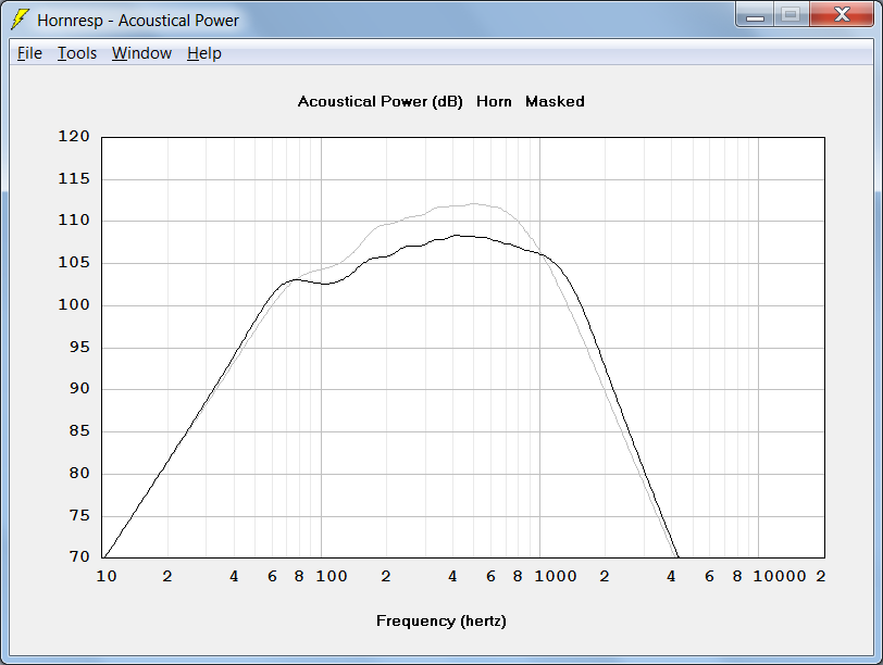

Hi Andrew,
Exactly - which is why I thought that the issue was worth mentioning 🙂.
If someone wishes to build Case 3 (H1 = 10, W1 = 10, H2 = 50, W2 = 200) then ideally they should be aware that it is not possible to directly simulate the configuration in Hornresp. The best that can be done is to model the design first as a conical horn and then as a parabolic horn, and compare the results on a single chart. The actual performance will lie somewhere between the two sets of predictions (see attached example - grey trace is Con, black trace is Par).
By way of background - I have become aware that there are people building rectangular flat-sided single-segment horns having different throat and mouth aspect ratios, thinking that they are conical, when in fact they are not. The constructors are wondering why their Hornresp simulation predictions (calculated using a conical flare) are not as close to the measured results as they would have hoped.
Kind regards,
David
i gues the closer the aspect ratio is the same,the more it leans to connical.
Hi epa,
Correct.
Similarly, the closer two sides come to being parallel, the more the performance tends towards the parabolic case.
Kind regards,
David

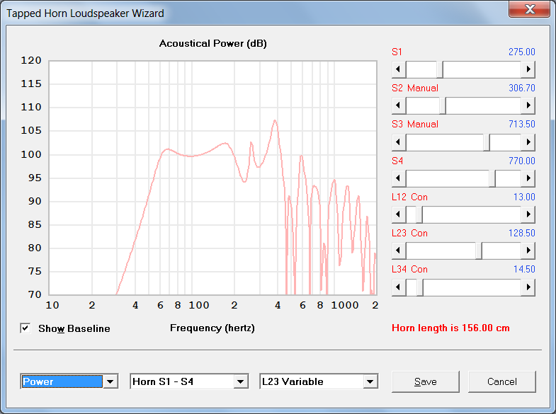

I keep loosing the 'show baseline' option in the loudspeaker wizard, it's there but doesn't show anything when ticked. I'm trying to sim a TH and it works OK but then stops and if I want it back I have to create a new record and then it works again.
For a while...
It might just be something I'm doing wrong I'm not sure. it seems to coincide with the 'L34 Con' text above the last slider turning pink. 😕

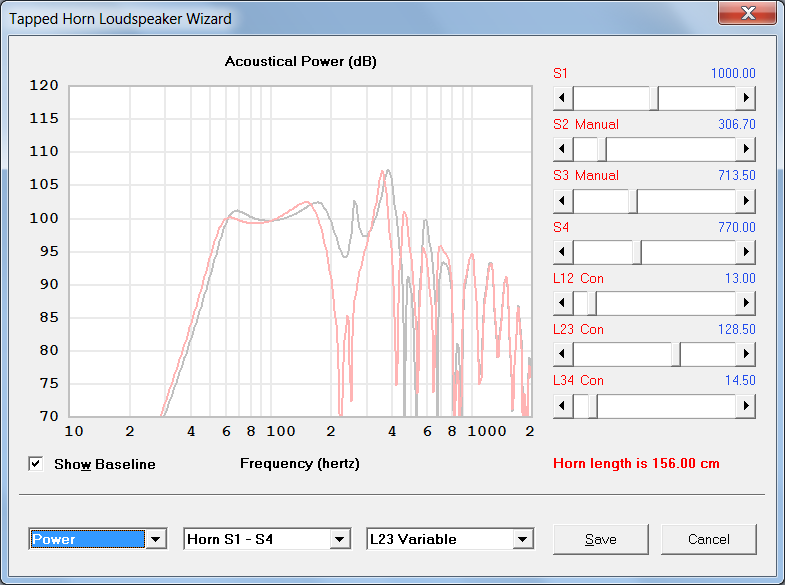

Hi StoneT,
The baseline is not saved between Loudspeaker Wizard sessions. It is reset to the current chart results each time that the wizard is opened.
This is why you cannot see the baseline initially - it is hidden behind the current results. Change any slider setting and the baseline becomes visible.
To illustrate:
Attachment 1 shows the Acoustical Power chart when the wizard is first opened. The baseline is hidden behind the current chart results
Attachment 2 shows the Acoustical Power chart after changing slider S1 from 275 to 1000 sq cm. The baseline is now visible, together with the new current chart results.
The Loudspeaker Wizard section in the Help file explains how to set and reset the baseline during a wizard session.

Hi David, thanks for the response,
To be honest it might not be happening any more, i was playing with it last night and the latest record is still working ok, but just for clarity- Now on some of my records:
I open the Loudspeaker Wizard
Go to a chart page
'Show Baseline' is already ticked (but it doesn't make a difference if i uncheck and then recheck.)
The red line is showing
I change the parameters (filling %/resistance , horn segment lengths/areas etc.)
Red line moves but no gray baseline is left behind.
Not a big deal really, I was doing something a little unconventional (tapped TL anyone?) so maybe I've found some kind of glitch, or maybe it's specific to my computer😕
I thought you might come back and say 'Ah, that's because you did x/y/z...' but don't loose sleep over it, As I say it seems to be OK for now
Understood, but my problem is that the baseline does not appear at all even when changing parameters (and therefore power/displacement charts). you only get the new lines, not the initial ones.Hi StoneT,
