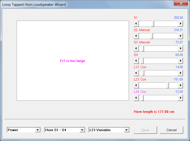

Understood, but my problem is that the baseline does not appear at all even when changing parameters (and therefore power/displacement charts).
Hi StoneT,
I think I might know what is going on here, but to be absolutely sure, could you please export one of your Hornresp records that does not show a baseline, and then post the file as an attachment, similar to the example below. Records are exported by selecting menu File > Export > Hornresp Record.
I need to be able to replicate what you are doing, to confirm what is happening.
Thanks and kind regards,
David
When I went to do this the first one is now working again but this one isn't:
Here we go:
Don't laugh, it's a work in progress 🙄

Hi StoneT,
Thanks for posting the export file, it has enabled me to confirm my suspicions.
The baseline is missing because the technique I use to trap invalid absorbent filling material results (in addition to simply restricting the frequency range to 2000 hertz) has not worked as it should for the example you have provided. See Post #3924 for information on the limitations of the absorbent material model.
Strictly speaking this is not a bug, but rather a shortcoming in the method I use to trap invalid results.
Your post has prompted me to see if I can come up with a more robust way of trapping filling material calculation errors by taking a different approach to the problem. The early signs are encouraging, and I will keep you advised of progress.
Thanks for raising this issue.
Kind regards,
David
Hi StoneT,
Further testing has revealed that under certain circumstances, the proposed new approach also has problems in trapping invalid absorbent filling results.
During this further testing however, I discovered an oversight in the code for the existing method, which when rectified, fortuitously addresses the problem you have been experiencing.
When the fix is implemented, the error in the test record you provided is correctly detected, and the "Fr1 is too large" message is displayed as intended, rather than a chart result being shown without a baseline also being generated.
Note that in the case of your specific test example, because the error is in the saved record, no baseline is generated because it would be invalid. Even when the error is manually corrected, it will still be necessary to press the Ctrl+Alt+B keys to save a new baseline for use in the current session. This is a "one-off" situation however, and would not normally occur in practice because a user is unlikely to knowingly save a record containing an absorbent filling error in the first place.
Thanks again for reporting this problem.
Kind regards,
David
