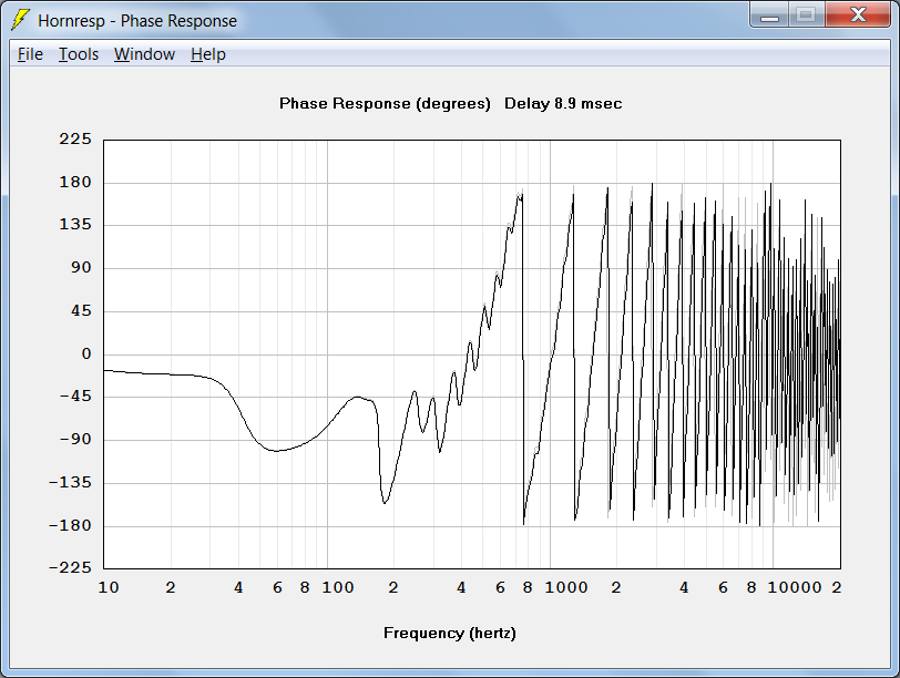

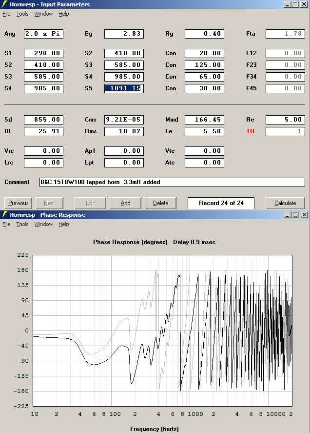

Can somebody help explain what is going on in this simulation. Here is the deal, when S5 is equal to or less than 1091.14cm^2 the phase looks like the light gray trace. If S5 is made to be 1091.15cm^2 or greater, the phase looks like the dark trace. How can 0.01cm^2 make that much difference in the phase response?

Hi JLH,
It is interesting that the phase response default offset delay corrections should be so different (8.9 msec compared to 10.4 msec). I will investigate and report back.

Hi JLH,
If the delay for the S5 = 1091.14 example is manually changed from the default value of 10.4 msec to 8.9 msec (the same as for the S5 = 1091.15 example) then the corrected phase response results become almost identical - see attached screenprint.
Without going into the specific details of the delay algorithm, the default delay values for the two examples are different because of the way that the -12 dB delimited SPL bandwidth, which is used in the calculation of the delay, is determined.
The following computations using actual Hornresp values illustrate how the difference arises even though the values of SPL1 and SPL2 for Case 1 are very similar to those for Case 2.
Limit = 20 * Log10(4) = 12.041200 dB
CASE 1:
S5 = 1091.14 cm^2
Freq1 = 172.196708 Hz
SPL1 = 104.758278 dB
Freq2 = 198.671992 Hz
SPL2 = 92.717041 dB
(SPL1 - SPL2) - Limit = (104.758278 - 92.717041) - 12.041200 = 0.000037 dB
CASE 2:
S5 = 1091.15 cm^2
SPL1 = 104.758271 dB
SPL2 = 92.717093 dB
(SPL1 - SPL2) - Limit = (104.758271 - 92.717093) - 12.041200 = -0.000022 dB
*** Note that [(SPL1 - SPL2) – Limit] is positive for Case 1 and negative for Case 2. ***
Although not obvious from the information given, this is essentially the reason why the default offset delay corrections are ultimately calculated to be so different.

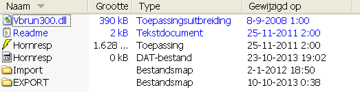

Hi to all,
David now I have for the third time that horn-response doesn't want to function. Till now I always installed horn-response new.
It seem when I got more files horn response gets this error. Can I repair it?
See attachment.

Helmuth,

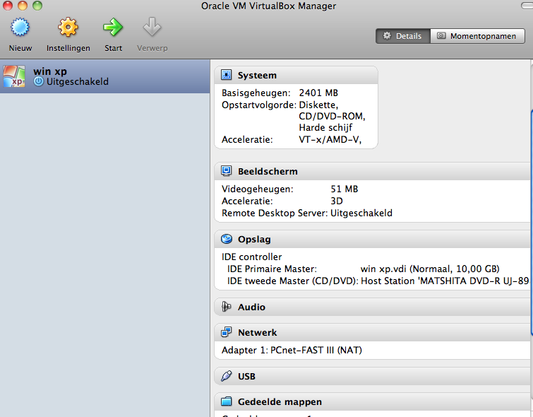

try to check if you have some visual basic runtime environment installed.
Where shout I check that Sabbelbacke.
I run window virtual on my macbook. I know virtual box has all kind of installation possibilities.
But that isn't what you where thinking of I know, only say this to keep in mind maybe it plays a role.
David now I have for the third time that horn-response doesn't want to function. Till now I always installed horn-response new. It seem when I got more files horn response gets this error. Can I repair it?

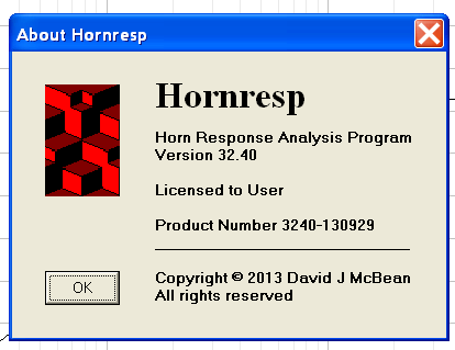

Hi Helmuth,
Are you using the latest release - Product Number 3240-130929, and are the Hornresp.exe, Hornresp.hlp and Msvbvm60.dll files located in the C:\Hornresp folder?
If so, then try moving your existing Hornresp.dat data file from the C:\Hornresp\Data folder to some other backup location, and run Hornresp. This should generate a new data file containing just the default record.
Does this work? If so, then it would seem that your original data file has been corrupted in some way. If you care to send me a copy, I can have a look and see if I can fix the problem for you. My email address is given on the Hornresp download web page (click on my name).
Try backing up your old hornresp installation (ZIP it, or move the folder, rename it...), then do a quick fresh install. Does this work?

Removing the .dat file (who had 0 bites) solved the error. Thanks david.
So I lost my saved simulations due a corrupt file.
I have version 28.80

Hi Helmuth,
This is very strange indeed. I have no idea how Hornresp could have corrupted your data so that it resulted in a zero-byte file. At the very least, the .dat file should always contain the default record, which is re-generated and re-stored each time the program is opened.
In my experience, since Version 19.10 was released (which prevented multiple sessions of Hornresp from being run simultaneously) the data file has proved to be remarkably resilient. During ongoing testing I have tried everything I can think of to deliberately corrupt the file using Hornresp, but without success.
Incidentally - I strongly recommend that you update to the latest Hornresp release, as a number of new features have been added since Version 28.80.

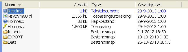

Hi Helmuth,
Further to my post above, I have just noticed that your screenprint attachment shows file Vbrun300.dll in the same folder as Hornresp.exe.
Vbrun300.dll is the application extension file for a program written in Microsoft Visual Basic 3. As from Version 20.00, Hornresp was converted to Visual Basic 6.
The Vbrun300.dll file should be deleted and replaced by Msvbm60.dll, if not already in the folder, supplied as part of the Setup.exe Hornresp download package.

I did update hornresponse.

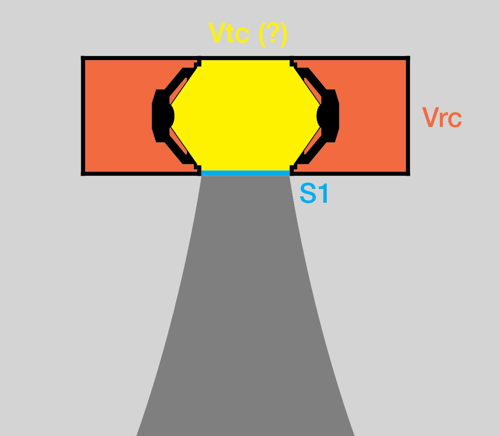

Atc question
Hello,
I am currently having trouble understanding the Atc and Vtc values when using two drivers in a push-push arrangement like the one pictured. What exactly is Atc? Is it simply the same value as S1? Is Vtc correctly sketched out in the drawing?
OR: Is the pictured arrangement really an "offset driver" horn in hornresp?
Thanks so much for the help!
Hi meko,
Your understanding is correct.
Don't worry too much about the value of Atc as it is really only required to find the length of the throat chamber (Ltc = Vtc / Atc) which in turn determines any throat chamber resonances - which may or may not appear in the overall SPL response depending upon the chamber length. With the 'chamber resonances masked' option selected, Atc is not used in the calculations at all.
For the purposes of the simulation, set Atc = S1. Using a different value for Atc probably won't make any appreciable difference to the results - try checking this for yourself.
Vtc (and Vrc) are as shown in your diagram.
Model the arrangement as a conventional front-loaded horn, rather than as an offset driver horn.

David,
it is much appreciated that you respond this quickly and always so precisely. Thank you! What you said cleared everything up.
Hornresp is pretty much insane, I think it goes without saying that we all are lucky to have access to something like that. Thanks loads!
