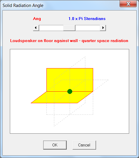

Hi Everyone,
The Radiation Angle tool boundary planes are now displayed in yellow.
I think this probably completes my "colouring in" activities for the time being 🙂.
At the moment, diyAudio won't allow me to upload a screenprint attachment showing the change.
Kind regards,
David
Hi Everyone,
Kind regards,
David

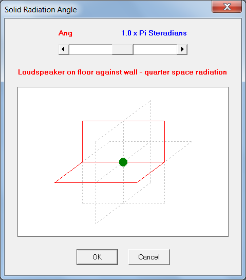

Hi Everyone,
Things are now back to normal again!
Before and after screenprints attached.
Kind regards,
David

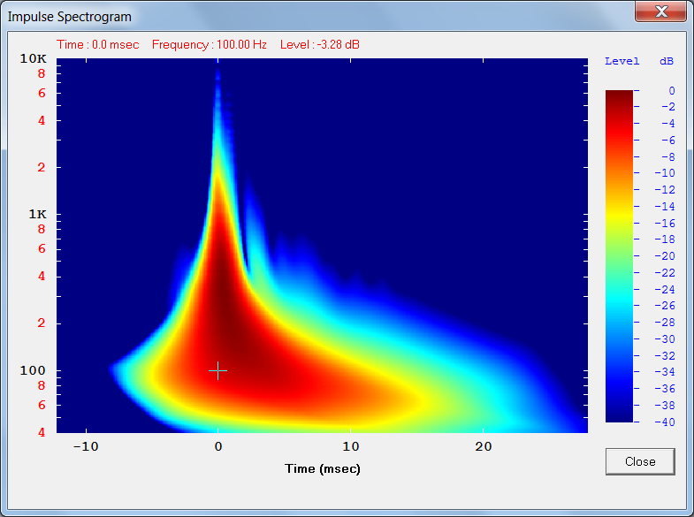

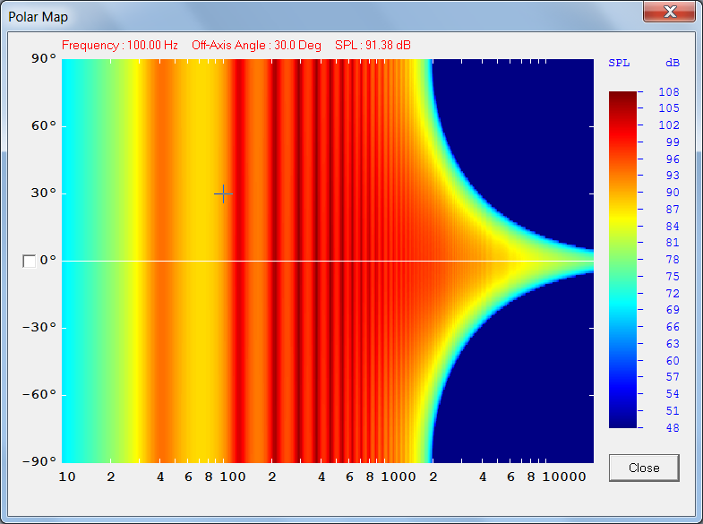

The Impulse Spectrogram and Polar Map are good examples in Hornresp.
