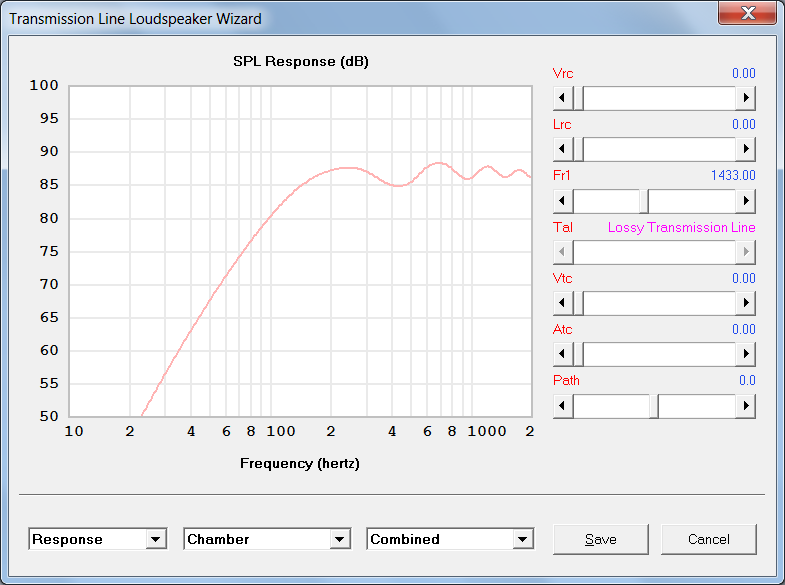

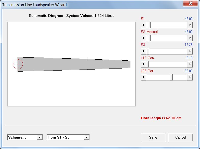

The Loudspeaker Wizard tool can now simulate transmission line loudspeakers containing absorbent filling material. See the Hornresp Help file for details (search for references to transmission line using the Find tool).

Amazing, especially (for me) the ability to evaluate stuffing in transmission lines. Does anyone have a source for how the Hornresp units compare to e.g.: pounds of fiberfill stuffing per cubic foot?
I can do a side by side test with MJK's software to find out, if you want. Not sure if I can do it today but I was planning to do it soon anyway since I saw this update. There might be some behind the scenes calculations that might make the results between the two programs directly comparable but this should give a pretty good idea of what's going on. I might test and compare against TL.app too while I'm at it, to see what the stuffing numbers mean in that program too.
Give me a design you would like tested and compared and I'll run the numbers.
I've been requesting this for years so I'm very happy to see this new feature.
I've only had a few minutes to play with it but it doesn't seem like stuffing can be isolated into particular segments. This would be very useful since stuffing in the first half of the line mainly attacks the harmonic spikes higher up in frequency with no negative side effects but stuffing placed anywhere near the mouth aggressively attacks output down near tuning. So it would be very useful to be able to place stuffing in particular segments instead of having the line fully stuffed.
Also it would allow us to play with stuffing in tapped horns (assuming stuffing is available in tapped horn sims, I haven't checked yet), so we could try a bit of stuffing in the throat and mouth like some of Danley's designs like the DTS10.

Stuffing Comparison
I tried to match the graphs up as well as possible as far as response vs amount of stuffing but like I mentioned these two programs calculate and show some things differently so it's impossible to make a perfect match. Hopefully these results are in the right range though. Maybe I should have used a bit more than 125 in the Hornresp graph in the third row, it's hard to tell for sure.
Top row - MJK and Hornresp inputs - check my work, if this isn't correct nothing else will be
Second row - response with no stuffing
Third row - response with .25 lb/ft stuffing in MJK's software
Fourth row - response with .5 lb/ft stuffing in MJK's software
Fifth row - response with .75 lb/ft stuffing in MJK's software
I didn't go any further than .75 lb/ft, if you need more than that you are doing it wrong, especially if the whole line from beginning to end is stuffed.
MJK's software assumes polyfil stuffing.
