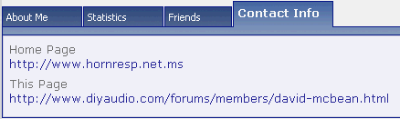

The homepage in your Profile is still showing the previous www http://www.hornresp.net.ms that is now unavailable due to the new www
@ Sabbelbacke
I don't have ANY browser cache, i've disabled it in FF for Privacy/Security reasons 😉 Works just fine 🙂

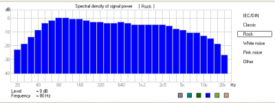

Can you add to the program the imposition of the transfer function of the car interior wich may be in TXT or CSV format?
Hi Yauhen,
I would rather not import data into Hornresp because even though the formats might be limited to txt or csv, interpretation problems can still arise depending on how the data fields are structured and ordered in the imported files, and what the imported values actually represent.
Perhaps the Hornresp results could be exported instead, and the car interior transfer function imposed on that data using Excel or similar?

Hello, David.
I tried to do it in Excel, and it was very inconvenient and time consuming, and no easy way to build frequency in a logarithmic scale.
I do not mean to be intrusive, but what if it will a separate window, where user could enter data for transfer function, something like this (see below)? Screenshot taken from another program, but it is just an illustration ideas.
Up to 5 functions, user defined and saved.
I think many car audio enthusiasts will thank you for it.
Best regards,
Yauhen.

Thanks for the reply, it's interesting.
But imagine that you need to design a quarter-wave subwoofer for vehicle. In this case, you often need make and analyze 10 or more different designs for evening. With transfer function built into Hornresp it will take about 10-20 minutes instead 1-2 hours otherwise.
Hi Yauhen,
It seems that you are suggesting the inclusion of what is in effect, a graphic equaliser.
Sorry, but the existing Filter Wizard is as far as I am prepared to go 🙂.
Kind regards,
David
Hi, David.
I meant that the user could determine up to 5 transfer functions in 1/3-octave intervals.and save them (in separate window), the higher accuracy is not required.
Thus there is no need import data from the outside.
Well, I understand you and I appreciate your time. Thank you for your answers.
