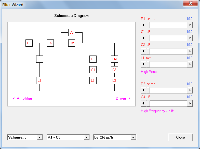

Hornresp Update 3240-130809
Hi Everyone,
The high pass filter configuration suggested by Jean-Michel in Post #3259 has been added to the Filter Wizard. The new "Le Cléac'h" option provides for two-stage impedance equalisation and high frequency uplift.
While working on the new option, two more bugs were found and fixed in the Filter Wizard. The results generated for passive filters when using the 100Hz to 20kHz frequency range were incorrect, and pressing the S key to instantly check the schematic diagram was not operating as it should.
Kind regards,
David
