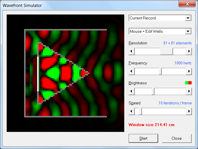

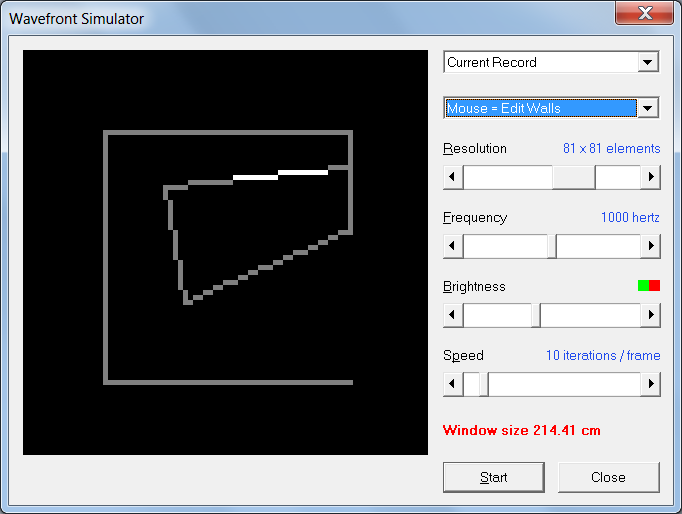

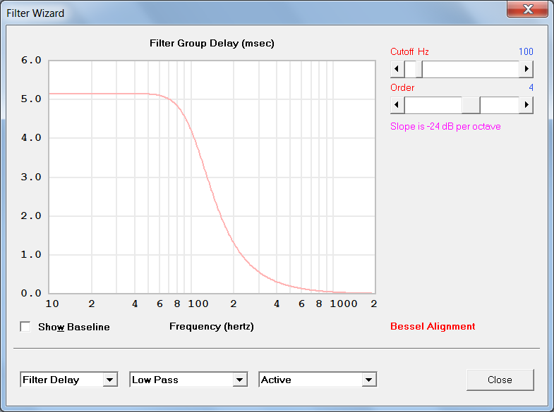

Hornresp Update 3230-130727
Hi Everyone,
The following new features have been added to the Filter Wizard and Wavefront Simulator tools.
CHANGES TO FILTER WIZARD:
Passive Filters:
Combined filter plus loudspeaker impulse response
Filter phase shift
Filter group delay
Active Filters:
Linkwitz-Riley filters limited to orders 2, 4, 6 and 8, as used in practical applications
Bessel filters orders 1 to 6
Combined filter plus loudspeaker group delay
Filter gain
Filter phase shift
Filter group delay
My thanks to Jeff, Jean-Michel, Oliver and Andrew for their helpful contributions.
CHANGES TO WAVEFRONT SIMULATOR:
The following new editing tools have been added.
Shift+click mouse at line end points to add straight wall
Ctrl+click mouse at diagonal corners to add walled box
Alt+click mouse at diaphragm end points to re-position driver source
Extensive coding changes have been made to both tools - could you please let me know if you find any bugs.

I have not had a lot of time to look at this. When using the Impulse w/ Band Pass Active it looks like the result reflects the impulse w/ filter applied, but the Bandpass and Active windows are greyed out.
Thanks for another major effort and improvement
Hi David,
This is great news.
Hi Oliver,
Because the impulse response results are not generated in "real time", the Filter Wizard controls are disabled to prevent the user from inadvertently changing settings while the IR calculations are being done.
Incidentally, I have noticed a few minor anomalies in the operation of the Wavefront Simulator when working with a user-specified point source (generated by Alt+clicking the mouse twice in the same spot). These errors will be fixed in the next release.

Hornresp Update 3230-130729
Hi Everyone,
The Wavefront Simulator anomalies referred to in Post #3631 have now been fixed.

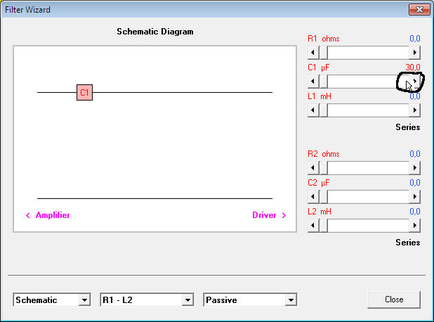

Hi David,
When I'm trying to add a series capacitor to e.g.: a sealed subwoofer, it takes quite a while to get up to the 500 - 800uF some of these systems like. Is there any way to speed up the slider response, or am I missing something?
Oliver,
When you point the cursor just next to the slider-arrow en press down on the mouse, it will fly all the way to the end and skip to the beginning and repeat... 🙂
Hi Bart,
Thanks. But, that does not seem to work on my computer, I have to click/hold/drag....repeat.... I would be just fine with typing in the value.
Hi Bart,
I tried again, this time when I'm "just inside" the arrow the slider box turns black, and when I keep holding the left mousse key down the slider value keeps on running up or down depending of which side of the slider box I'm at. That speeds things up a lot. Thanks.
