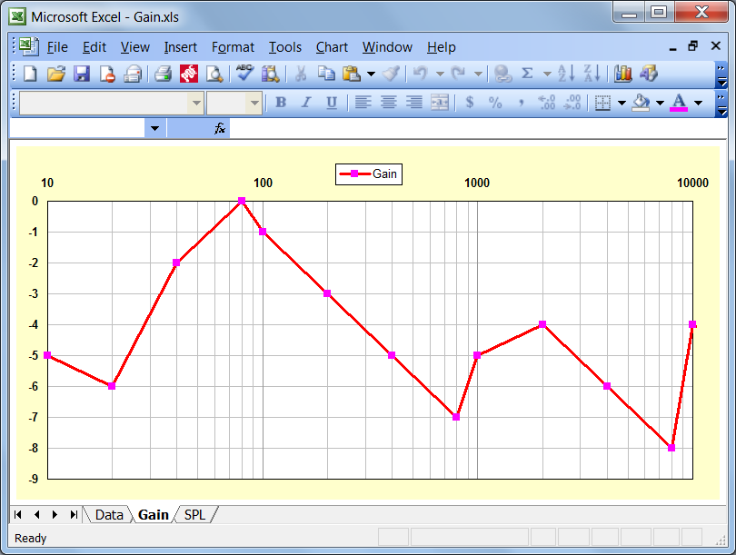

Hi Yauhen,

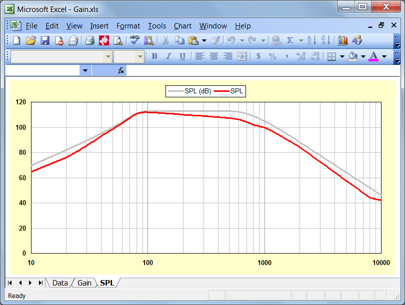

I had in mind something like the attached zipped-up Excel spreadsheet.
Process:
1. Export all Hornresp chart data to csv file.
2. Open exported csv file in Excel.
3. Open attached Gain.xls file in Excel.
4. Copy data from column D in exported csv file to column B in Gain.xls.
The above process should take a matter of seconds.
Columns Gain 1 to Gain 5 in the Gain.xls spreadsheet store the different gain profiles you may have. Simply copy the one you wish to use into the relevant column H cells
To keep things simple, linear interpolation has been used to derive the gain values at intermediate points between the 14 sample frequencies.

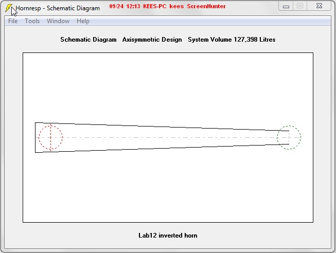

Thanks david. Was well and properly confused wen my 620 liter offset driver horn looked like it was going to fit in a 22.5x22.5x45 inch box lol

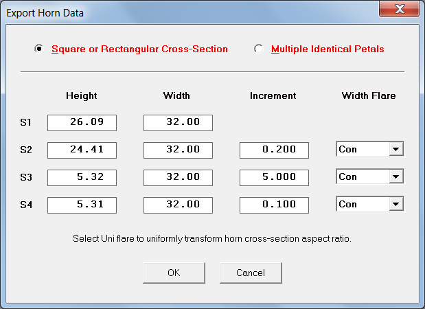

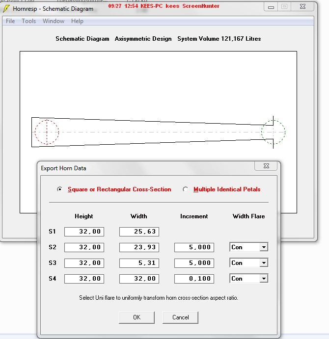

Hi David
I did try to export for a inverted tapped horn but i get again strange outcomes, can you look at it? thanks. Inverted horns have nice graphs with speakers who do not so well in tapped horns.
I have tryed all possibillities con, uni, par, exp, par go oke for a part until the end is suddenly has errors, maybe a inverted horn kan not be exported.
regards
kees
regards
kees

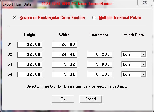

Hi Kees,
As far as I can see, the results are being calculated correctly.
If we consider the first horn segment in your screenprint example:
S1 = 835.00
S2 = 781.22
Specified height at S1 = 32.00
Calculated width at S1 = 835.00 / 32.00 = 26.09 (Hornresp rounds to 2 decimal places)
Specified height at S2 = 32.00
Calculated width at S2 = 781.22 / 32.00 = 24.41 (Hornresp rounds to 2 decimal places)
Because the specified width flare = Con, the width of the first horn segment will decrease linearly with horn length from a half-width at S1 of 26.09 / 2 = 13.045 to a half-width at S2 of 24.41 / 2 = 12.205.
The height value at any point along the horn segment is found by dividing the cross-sectional area at that point by the width.
Calculated half-height at S1 = (835 / (2 * 13.045)) / 2 = 16.002300 (Hornresp rounds to 6 decimal places)
Calculated half-height at S2 = (781.22 / (2 * 12.205)) / 2 = 16.002048 (Hornresp rounds to 6 decimal places)
Note that in this case, height values will not be constant along the length of the horn segment because of the way that Hornresp calculates the results.
To maintain a constant 32 cm dimension along the length of the horn segment, set the width rather than the height to 32 cm, and specify either a Con or Exp width flare (but not a Uni flare) as shown in the attached screenprint.
Kind regards,
David

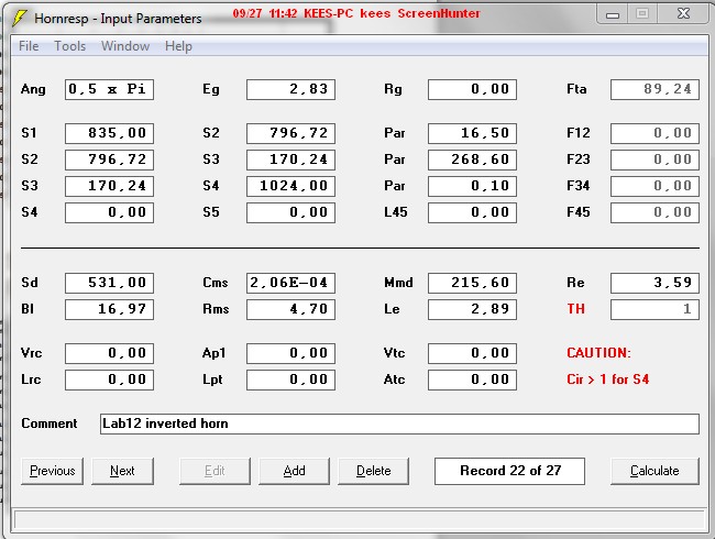

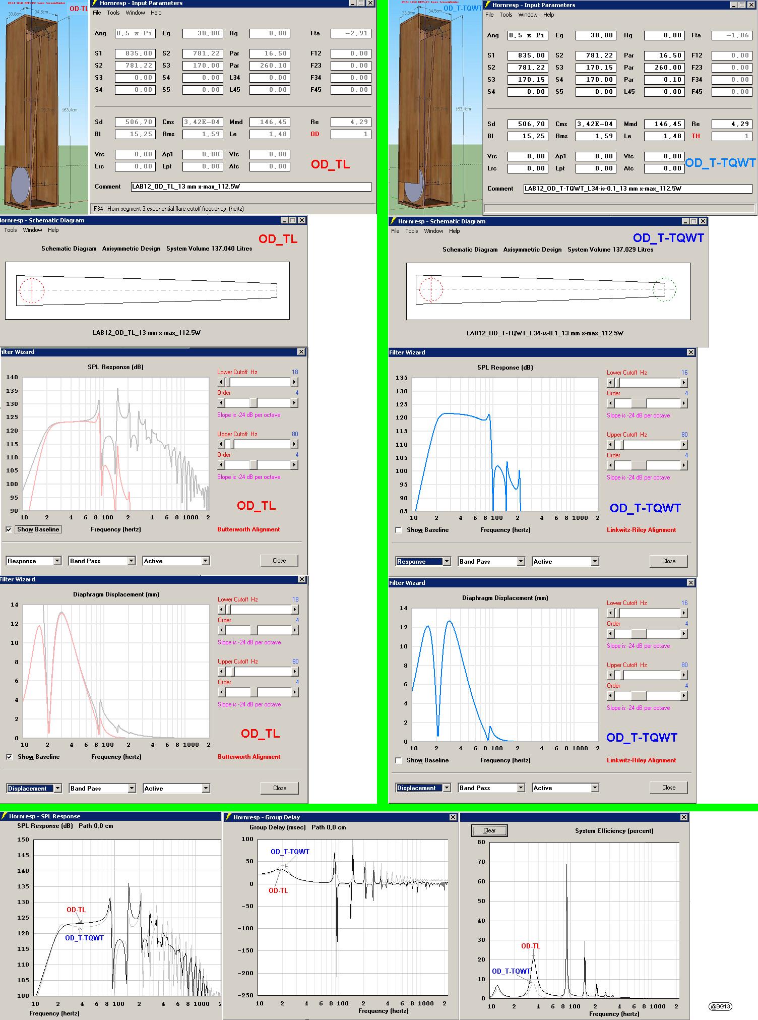

Hi David.
I did see when I do export some more times it has little different outcomes, but it is when I look just a very small 0,1 mm differents it looks however strange.

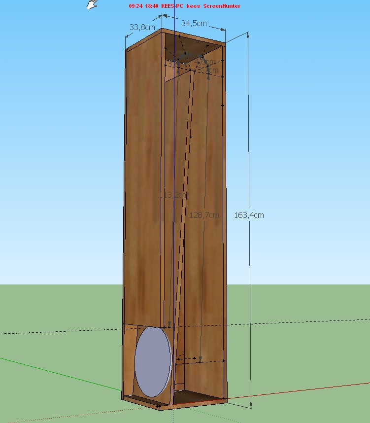

I do use round numbers, and so this is the result from hornresp. (see picture) a subwoofer 18 to 90 hz ready to sawdust.
I get really experienced with horn folds, I made this fold in just 40 minutes.

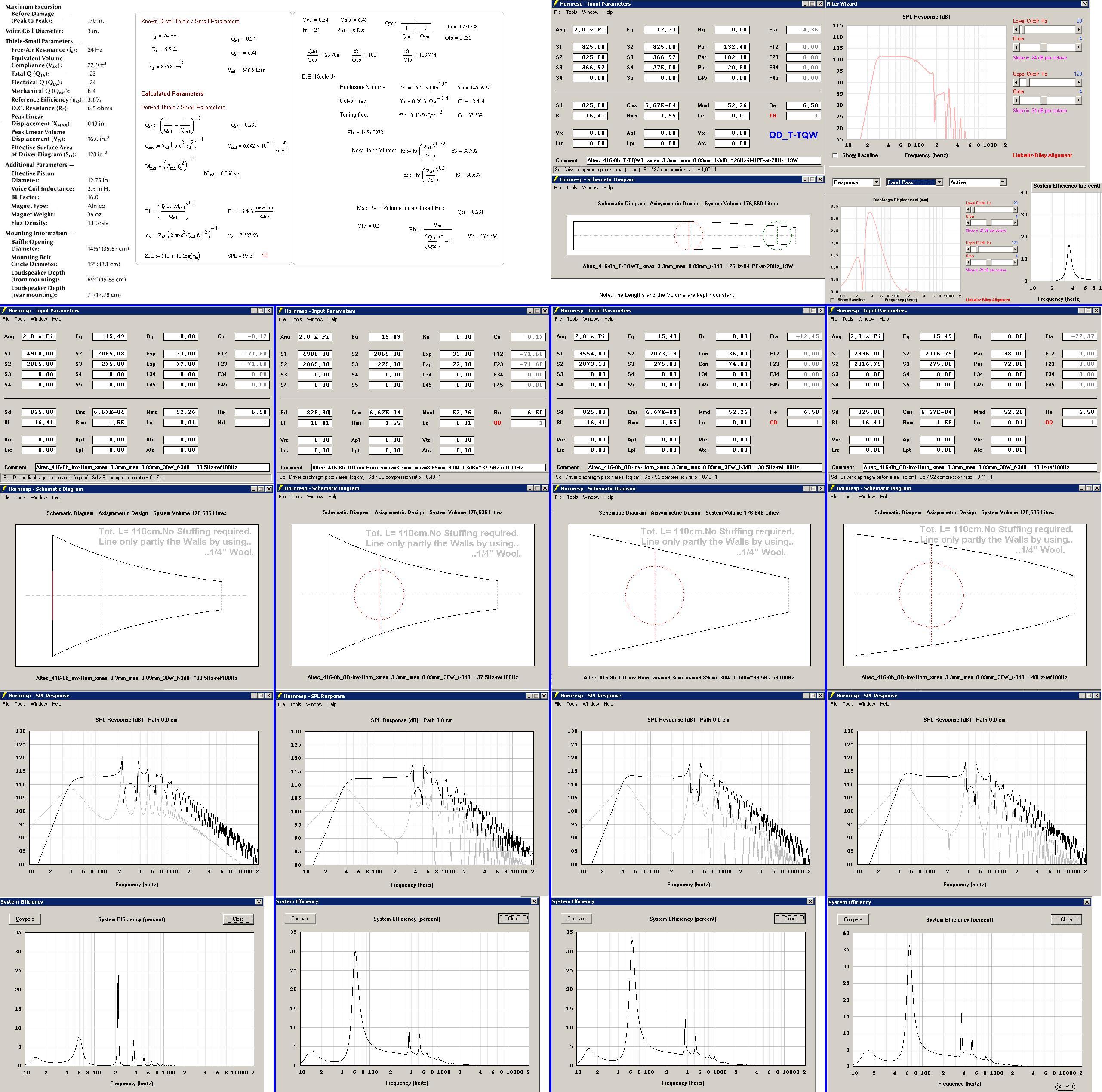

Kees,
In Post# 3705: The TS parameters for the Lab12 driver is not correct ?
'Inverted horns have nice graphs with speakers who do not so well in tapped horns.'
😱😱That's your belief of what you have depicted but definitely not I can imagine. you provided a SketchUp picture that IMO depicts a Quarter-wave OD_TL.
IMO to make a good inverted Horn Sub normally takes an IB Driver (Vas very large) like the Altec 416-8B :
See the sample picture:

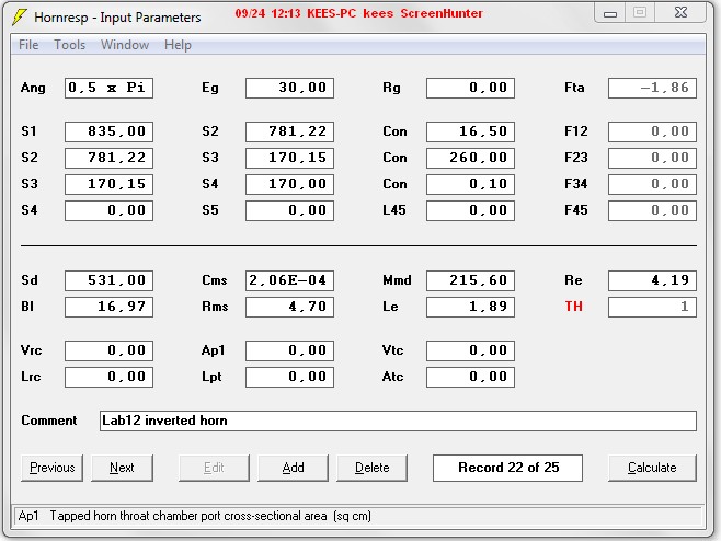

I did see you have change TS parameters, mine in post 3705 are right, Lab 12 is the first tapped horn tryout with a infinity woofer so name is still lab12, but is not the lab 12 speaker.

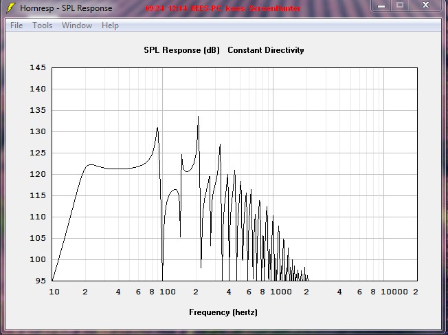

I have the sim done with the infinty reference 1260W woofer for the inverted horn.
http://ch.infinitysystems.com/tl_fi.../Reference/Reference/1260w/REF1260W_PI_EN.pdf
In photo the TS are oke, there was some errors in previous post.

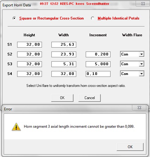

Still, now is changed a other thing, horn section three, when it is there 0,1 then hornresp go only 0,099 and give a long column of tekst, the older version just do well and give a column of two, this give more clarity.
regards kees

Hi Kees,
The change is intentional. With the old version, the "column of two" meant that the horn segment had only one element and the 'Top Len' values were shown as zero, which is the problem I wanted to fix.
With the new version a segment length of 0,1 has a default increment of 0,001 which gives a 100 elements. Simply change the increment setting to 0,05 or greater to reduce the horn segment to 2 elements, or a "column of three". The maximum allowable increment value is 0,099 to ensure that there are always at least two elements.
Allowing an increment value of 0,1 when the horn segment length is also 0,1 would mean that there was only one element, and that the 'Top Len' values would again be shown as zero.
(In Hornresp at least two elements are required to calculate the 'Top Len' value).

I do use 0,099 then it give 3 rows.
Hi Kees,
I couldn’t resist making a further refinement 🙂.
An increment of 0,1 can again be used in your example to give just 2 rows, but with the 'Top Len' (and 'Side Len' for Uni width flare) values no longer being shown as zero.
(Hornresp actually uses two 0,05 length elements internally to calculate the length of the curved 'Top Len' line, but these calculations are not seen by the user).
Kind regards,
David

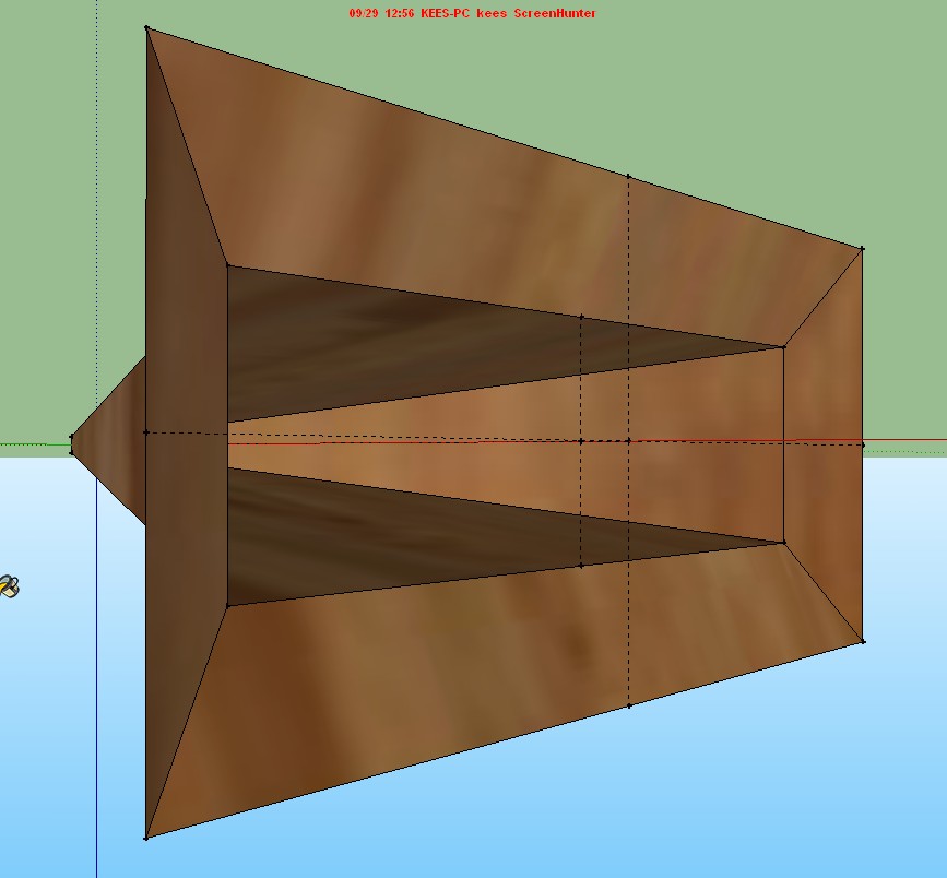

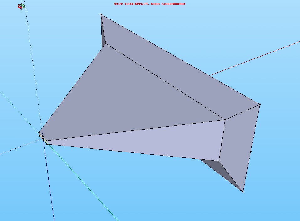

Hi David
Did try the synergy horn with the output of hornresp, only the last flare I gets to wide when it is not a square horn, I did for example 1 x 4 cm start it will then go to 100 cm horizontally and 50 cm vertically, the last flare has to be follow the rest except see difference on photo,s, my english is not as good to go to technical.
I did see with sketchup it is not easy to do the angles right, push pull do only a straight pull up. nice software but maybe I need to learn a more professional drawn program.
regards
kees
regards
kees
