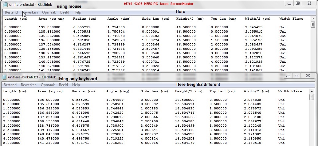

I get very strange outcomes see here. the first part of the export horn data is faulty, the rest is fine, strange
that you get good output, send me a older version of hornresp..
S1=faulty
Length (cm) Area (sq cm) Radius (cm) Angle (deg) Side Len (cm) Height/2 (cm) Top Len (cm) Width/2 (cm) Width Flare
0.000000 135.000000 6.555291 1.754989 0.000000 (Here-fault 0.013357) 0.000000 (Here-fault 2526.810303) Uni
0.500000 135.631000 6.570593 1.750904 0.500091 0.013419 0.500000 2526.800738 Uni
1.000000 136.262000 6.585859 1.746848 1.000183 0.013482 1.000000 2526.791172 Uni
but S2 is oke
0.000000 185.480000 7.683757 1.471426 0.000000 (Here-oke 16.500000) 0.000000 (Here-oke 2.810303) Uni
0.500000 186.100061 7.696589 1.468974 0.500088 16.500000 0.500000 2.819698 Uni
1.000000 186.720123 7.709401 1.466533 1.000177 16.500000 1.000000 2.829093 Uni
1.500000 187.340184 7.722191 1.464106 1.500265 16.500000 1.500000 2.838488 Uni

I did again uni output but now it again a weird output, the height is not continu 33 cm, in uni flare.

Well I have found it and so i share it, it is a very strange fenomen, it happes only when I use keyboard when fill in hornresp horndata height (33cm) with enter.
When I use the mouse cursor to fill in the horndata and not enter from the keyboard then the output is oke here, I really don,t now why this happens, is it a bug or is it in my pc himslefs (after the lightning hit nabures who I did feld trough the mouse (static).
Hi Kees,
Many thanks for this additional information. While I cannot replicate your exact values, I also get strange results for your example design when the Uni width flare option is selected - and it doesn't matter how I enter the 33cm height value for S1.
There is obviously a problem somewhere - I will investigate further and let you know what I find.

If I do input with mouse and keyboard without using enter on keyboard then I get the right outcome, I have tryed this 25 times, anly with input through enter give this strange outcome.
Possible the proper outcome is for me looking good it is afcourse possible that the flare calculation is not precise, this is difficult to so see, but I have drawn and folding the box and the flare is

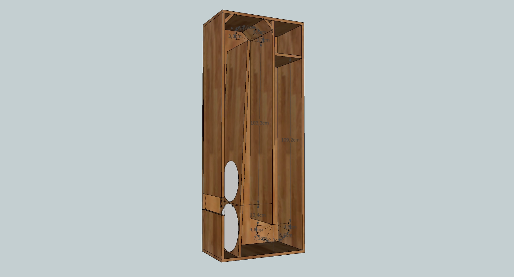

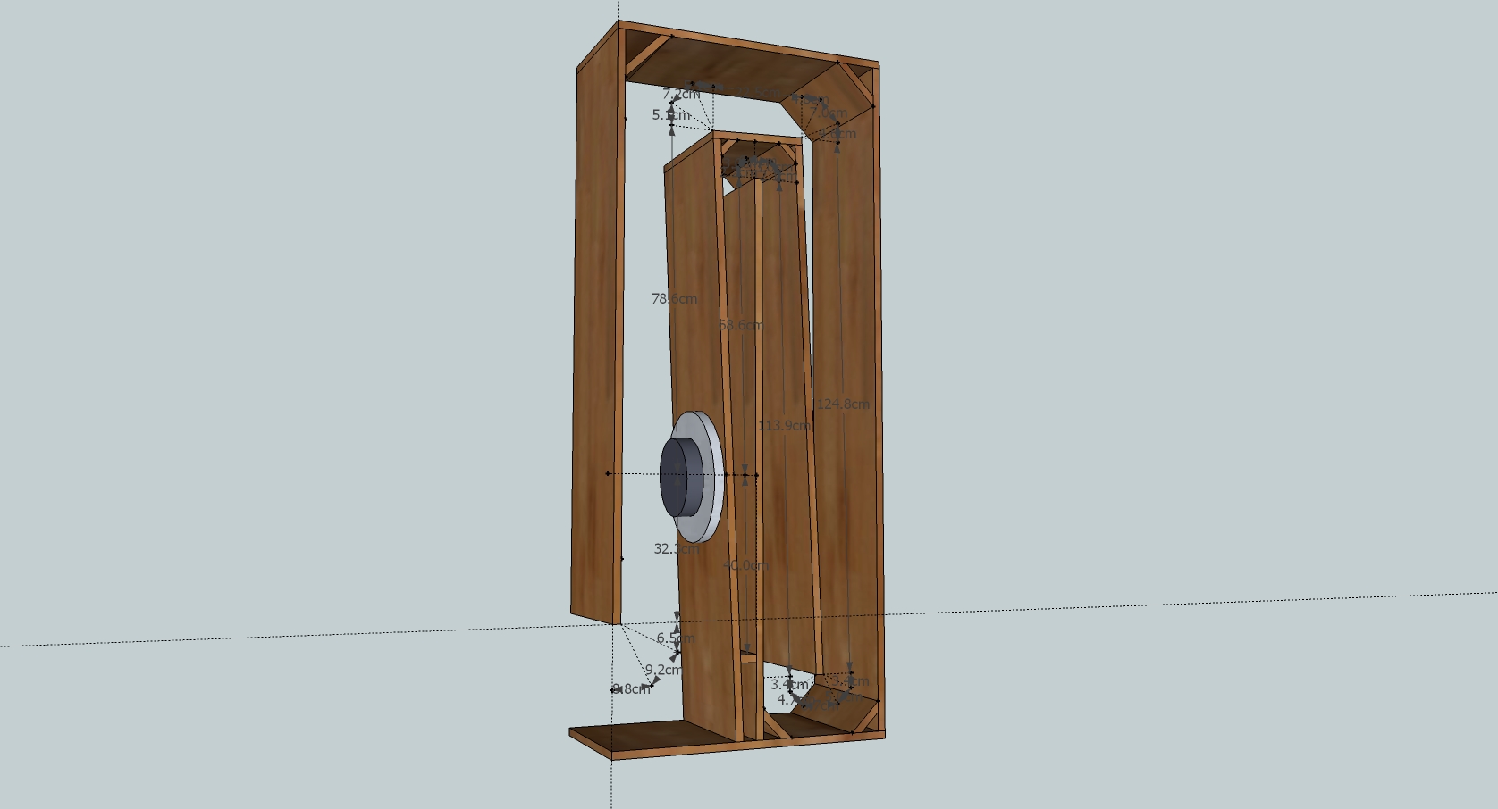

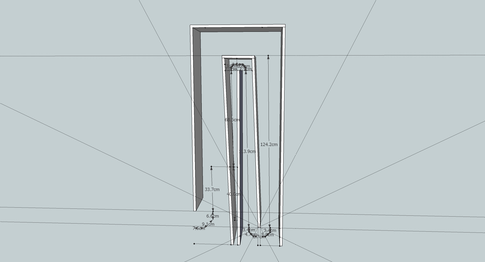

in picture example of box so far I been with folding, it is a day work already.

The box is now ready, I have just 0.5 cm longer, your hornresp calculation looks al right if it works, (with mouse curser and without enter key.).
I did work 17 hours on it.

Hi David
I get still some differenties, but these are small and not have impact on calculated flare.
The height is not exact 33 : 2 = 16.500 but 16.5045 for example, when export with only use of mouse the it is exact 16.500 for the whole S1, S2, S3.

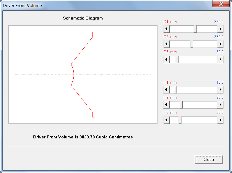

Hi Kees,
This is very strange indeed. Do you still see the difference when you change your decimal separator symbol from a period (.) to a comma (,) using the Windows regional settings tool?
Assuming that the Vtc value required in the simulation is 5000 cc, and that the volume in front of the driver cone calculated using the Driver Front Volume tool is 2319.25 cc, then the size of the actual physical throat chamber in your constructed loudspeaker should be 5000 - 2319.25 = 2680.75 cc.
As shown on the tool, the driver front volume is given in cubic centimetres (cc) - see attached screenprint. Not sure what you mean by 2cm - units of square centimetres (cm2) apply to area, not volume.
The value sounds about right to me - a little under two and a half litres. A volume of 2319.25 cc can be visualised as a cube having a side length of 13.24 cm.
is the volume calculator in cc or 2cm,
I get for a 12 inch woofer 2319.25 2cm is this not very big?

I have done the decimal, now it is oke, put my pc on netherlands, the decimal was already a comma, but other things are not right, fixed.

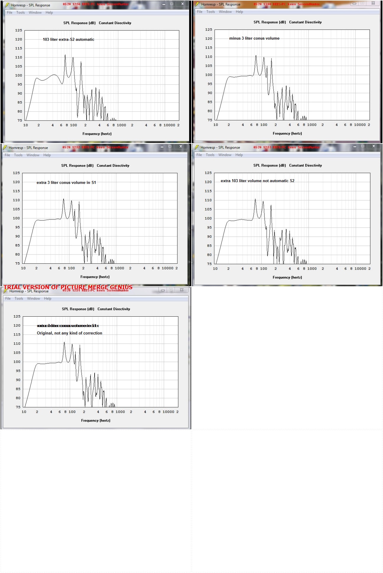

Last question about the conus correction, I have now everything in my head, except where to get volume correction in S1 only or both S1 and S2?
I think I have to take away volume only in S1, that is only throat, then now I have learn everything to use hornresp as a prof.

here the plots with some kind of corrections of conus volume, but there is not much change with it, so I have not bother longer about that, I have just correct the box give S1 3 liter less volume like you did mention.
learning curve ended.
S1 and S2 are the end areas of the the first horn segment, not volumes. The volume in front of the driver is specified by Vtc.
