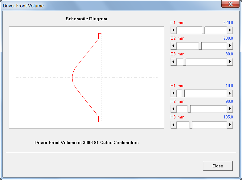

Some drivers do have invers dust-caps (RCF L12P530 e.g.), would it be possible to extend the driver-front-volume tool to do that (H3>H2) ?
I will have a look 🙂.

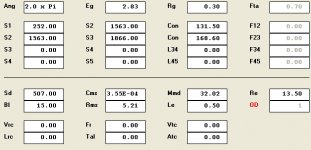

Hornresp Update 3210-130501
Hi Everyone,
The Driver Front Volume tool now supports concave dust caps. My thanks to Sabbelbacke for suggesting this refinement.
Kind regards,
David

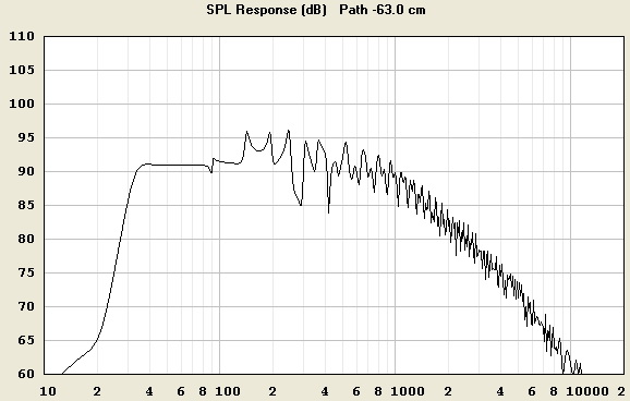

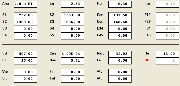

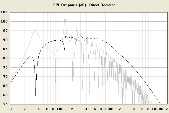

Hi! And thank you.
If flare mouth is on the rear of the cabinet like here http://www.diyaudio.com/forums/full-range/144190-bigger-frugel-horn-bugelhorn-12.html#post1859185
How should we measure "path length difference" for combined SPL response? The shortest distance between mouth/cone centres around side panel or a little more due to floor/wall elongation?
Maybe rear mouth in full-range driver (OD setup) is preferable because we can make longer 1st segment (makes nice direct radiation), big front baffle (it makes "bigger" sound IMO), we don't hear higher harmonics from flare. Am I right or front mouth horns are more gainy, sim predictable and room indifferent that they are
comme il faut?
Have I to implement S1, S2, S3 area correction (multiply to say 1.1) due to rectangular cross-section (not circular as simulated)? We really appreciate your work. Best wishes.

Hi rrr969,
To keep things simple, I would probably just use the following:
Path length difference = -(cabinet rear width / 2 + cabinet side depth)
For example, if the loudspeaker cabinet is rectangular, and 30 cm wide by 48 cm deep, then the path length difference would be -(30 / 2 + 48) = -63 cm (by definition, the value is negative because the distance from the rear-facing horn mouth to the listener is greater than the distance from the front-facing direct radiator diaphragm to the listener).
Maybe rear mouth in full-range driver (OD setup) is preferable because we can make longer 1st segment (makes nice direct radiation), big front baffle (it makes "bigger" sound IMO), we don't hear higher harmonics from flare. Am I right or front mouth horns are more gainy, sim predictable and room indifferent that they are comme il faut?
If the loudspeaker is positioned close to a wall or in a corner, then a rear-facing horn should theoretically have better acoustical loading at the mouth, and therefore a stronger and a slightly smoother response. It really all depends on your overall system design aims as to whether you use a front-facing or rear-facing horn. Others having practical experience with such systems may wish to comment further.
It is not necessary to adjust the S1, S2, and S3 values. The cross-sectional area is the important parameter, not whether the shape of the actual constructed section is circular or rectangular.

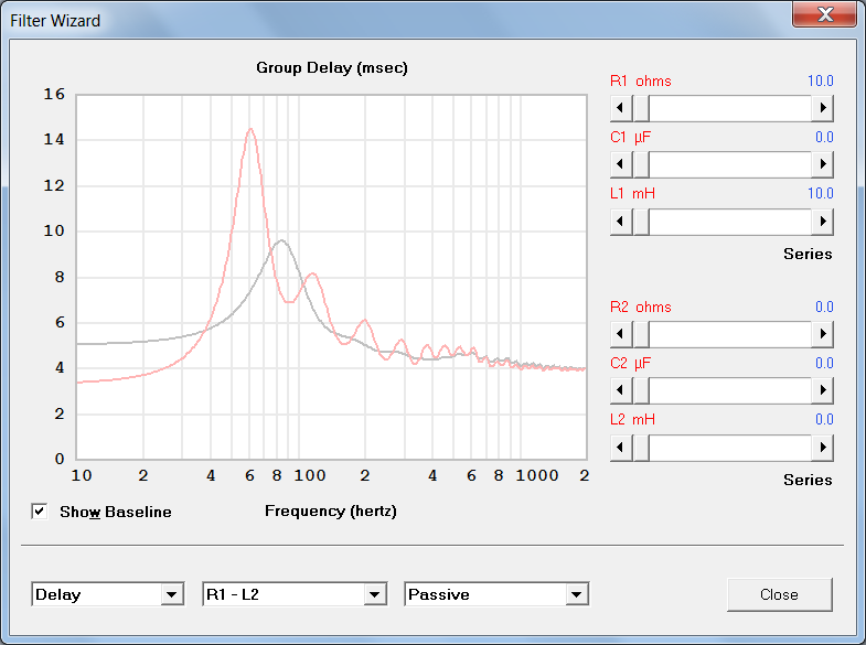

Hornresp Update 3220-130511
Hi Everyone,
The Filter Wizard tool can now calculate the overall group delay of a passive filter and loudspeaker combination.
My thanks to Jean-Michel for his comment in Post #3406 which prompted me to develop a method to determine group delay values in real time.
