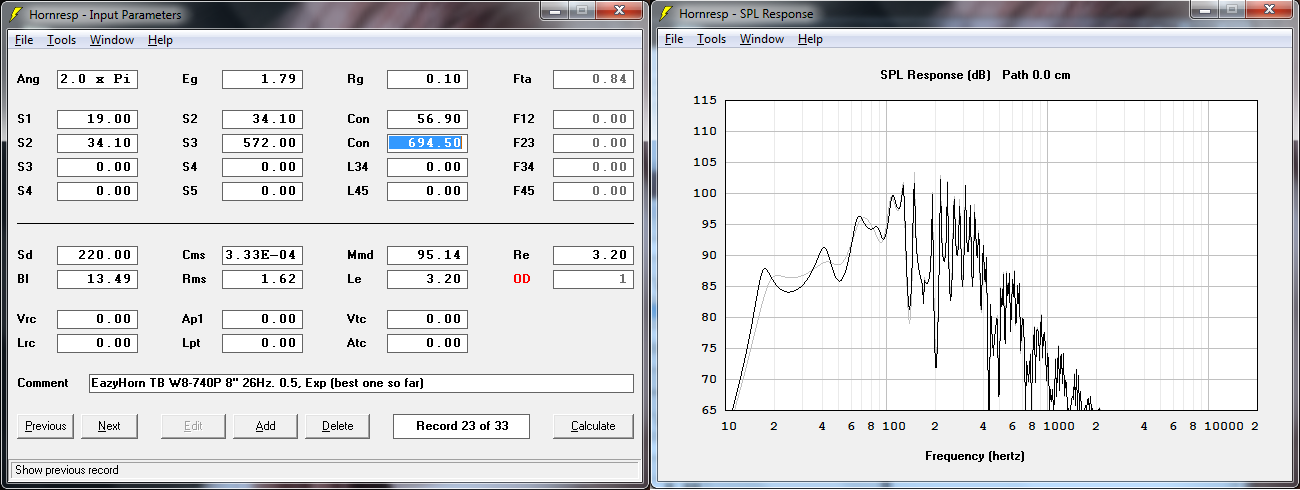

The Othorn is pre cone volume correction IIRC, so S2 is off. With a big 21" driver that makes it off by quite a bit.

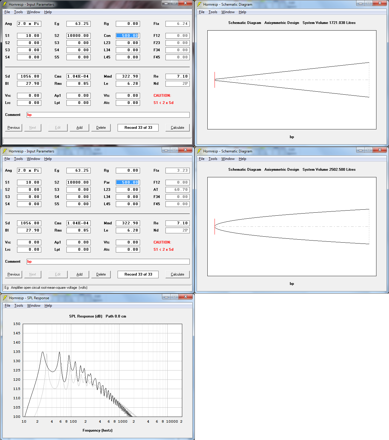

The more segments you use in Akabak the closer the sim will match a 4 segment Hornresp sim, so it's no surprise this 48 segment sim is very very close.
When you use very few segments in Akabak the results won't be nearly as close. Try a long horn with very few segments like a BIB and see how well they match. (Make it an end loaded single segment even if it's not possible to build it like that.) I think you'll be in for a rude awakening if you think these results are valid in all cases.
So...
If you use an infinite number of segments (or even a segment for every mm of path length) the Akabak results will overlay a 4 segment Hornresp sim so closely that with the naked eye you could call it perfectly overlaid.
Use less segments and the results will be much worse. As I've mentioned several times I can make a much worse sim than I showed previously. I didn't use Akabak at all for this since it's just a CON vs PAR issue and this issue is worst when only 1 segment is used, so for the sake of saving time and energy I used Hornresp for both sims shown here.
The top row is a CON sim and it's resulting schematic.
In the second row the ONLY thing that is changed is I've changed CON to PAR.
Notice the massive difference in shape and volume.
The third row single pic shows the spl response difference. This is a massive error.
Forget the fact that this isn't a good design and can't actually be built as simmed. This is just an example that things can go horribly wrong if you are forced to use CON and you don't use a lot of segments. As usual, understanding the issue is the key to avoiding problems. This result isn't typical but it's no more atypical than the 48 segment comparison you just linked to, since most people just use Akabak to add 1 or 2 segments, not 44.
How's that for a crux?
Edit - I added another example. The only difference is CON vs PAR.

Since you have effectively 10 times the number of segments available in Akabak you might want to use them. If for instance you were to export the segment data from Hornresp and use 2/3 of the segments in the first 1/3 of the horn...
That's what I do but it's not fun being locked into having to do that to get the most accurate results possible when you only really need 1 or 2 more segments than Hornresp can provide. A simple Akabak import turns into a huge job.

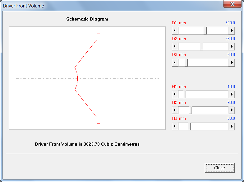

Hornresp Update 3210-130428
Hi Everyone,
A tool has been added to calculate the air volume in front of the driver diaphragm. This should make things a bit easier when dimensioning throat chambers.
The tool calculates the effective air volume between the driver diaphragm and the front plane of the driver, given the inside diameter of the mounting sealing strip, the inside diameter of the diaphragm suspension, the diameter of the dust cap, the thickness of the sealing strip, the perpendicular distance from the front plane to the edge of the dust cap, and the perpendicular distance from the front plane to the centre of the dust cap.
The Tools menu command is enabled when the input parameters window is in edit mode. The tool can also be selected by double-clicking the Vtc or Atc label or text box in edit mode.

That will save a fair bit of calculation!
Much appreciated David.
Very useful for finessing horns.
Now that I have been playing with it I find it very intuitive.
At first I did not understand the dimension designations. But there is that little blue bar that shows what dimension is active.
I like it!
I like it alot 😀

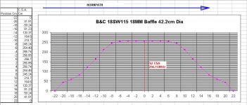

David,
thank you for the driver volume tool, and of course the filter tools.🙂
The calculator you have developed seems entirely appropriate when designing for front loaded horns and symmetrical tapped horn designs.
As you are probably aware, we have been playing around with the concept of accounting for the driver volume and the idea of 'cone compensation', and that some builders have reported positive results that seem to be close to the Hornresp simulation.
I wonder what your thoughts were on the technique that was developed for offset horns and conventional (asymmetric) tapped horns. In these horn types the horn path moves across the speaker cone instead of away from it. In these cases the point of interest was the cross sectional area of the speaker diaphragm volume and baffle cutout at S2 and the in the case of tapped horns the corresponding loss in area that occurs at S4 due to the speaker diaphragm magnet and chassis.
The cross sectional area of the speaker and cut out are not accounted for in the sim they are compensated for in the physical layout of the horn path. The areas need to be calculated to achieve this, not the volume.
As such there is nothing that you need to add to your excellent program. I was interested in your opinion.
I attach a example plot of the cross sectional area of a speaker diaphragm and baffle cut out showing the change in volume along the hornpath as it travels across the speaker cone.
Kind regards Martin (Xoc1)
