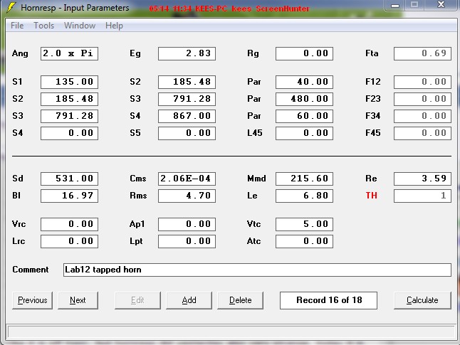

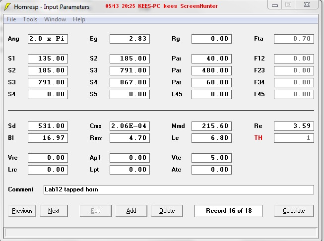

I have problems I think with new version. I do see it do not fill in proper width
it need to be 33 : 2 =16.50 but it is 16.49 for S2 but S1 give 0.013485??.
very strange outcomes with horn data,

when I do make S1 the same as S2 (185 cm2) it is oke again.

when I do S1 135 2cm it is a strange outcome, do i miss something or is there a bug, maybe S1 135 2cm is to small, or there is a bug, from S2 it is oke.

Oke if I make width 33 cm in stead of height then it is oke I think, I do use uni flare but don,t I need conical for a tapped horn>?

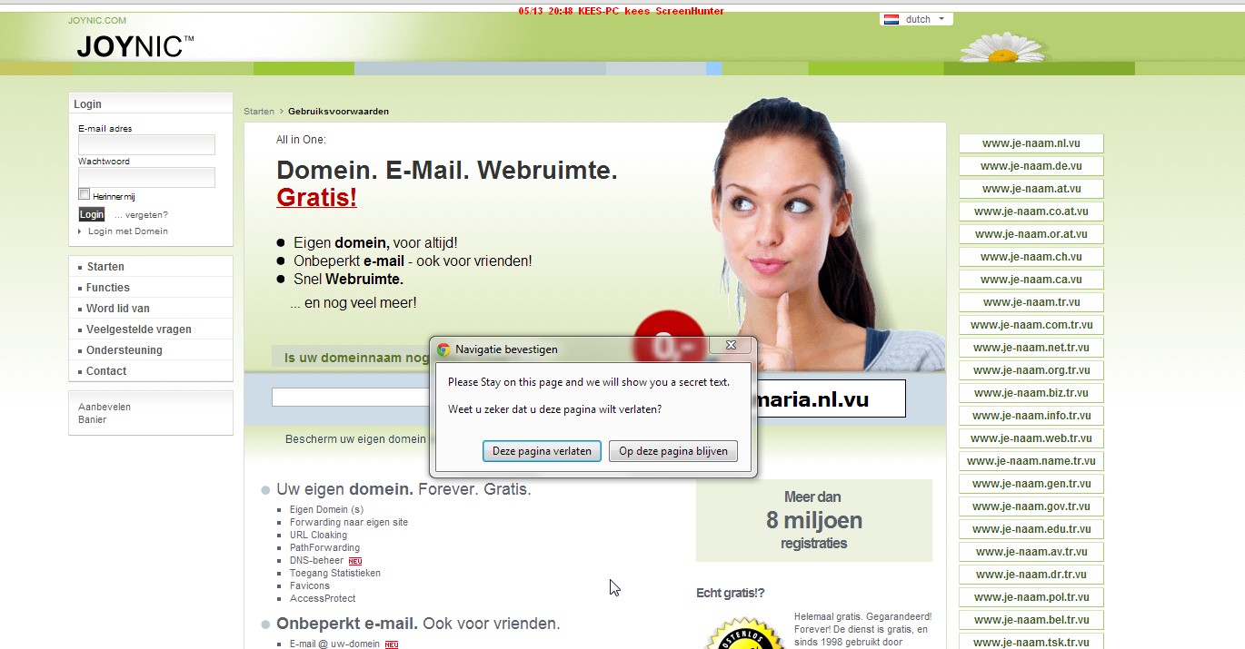

Hmmm I see Hornresp will update but i get a very strange site if I agree with
a update.
Maybe i have a virus, I go do a control of the pc, I have avira.
see here

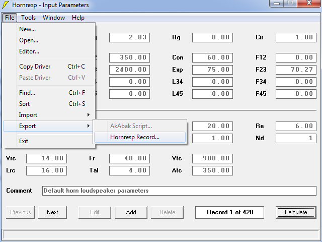

When reporting an issue...
Along with your screen shots and descriptions it would be helpful if you could export the hornresp record and either attach the file or post it to the thread.
Code:
I find the "code" tag [SIZE="3"]#[/SIZE] is useful for things like this...
I have problems I think with new version. I do see it do not fill in proper width it need to be 33 : 2 =16.50 but it is 16.49 for S2 but S1 give 0.013485??.
Never seen this.

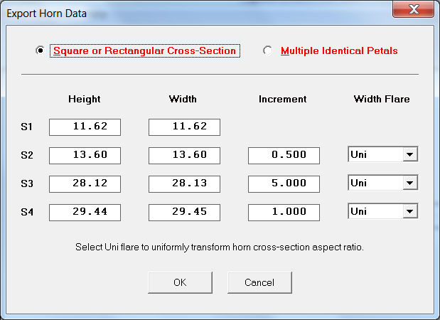

Hi Kees,
For your given example, and using the default square cross-section height and width dimensions together with the Uni width flare option as shown in the first attachment, the exported data should be as listed in the second attachment. I have no idea why your results are not the same as those in attachment 2.
Kind regards,
David

Yeah me too 😉 Nothing bad happens when i visit -http://www.joynic.com but it's strange how you got there ?
Are you SURE you clicked on Hornresp in David McBean's RECENT posts ?
Hi
If I click hornresp.net then I do did come to the right place, but I get the Joynic.com site if I agree with the hornresp automatic update when start it.
I did try more times.
I have now put everything in for let see the error, or my error for the time being.
Wel not do fall my face off😕
I have try again to export the horn data, en no what now is everything fine😀

Hi Kees,
Kind regards,
David
