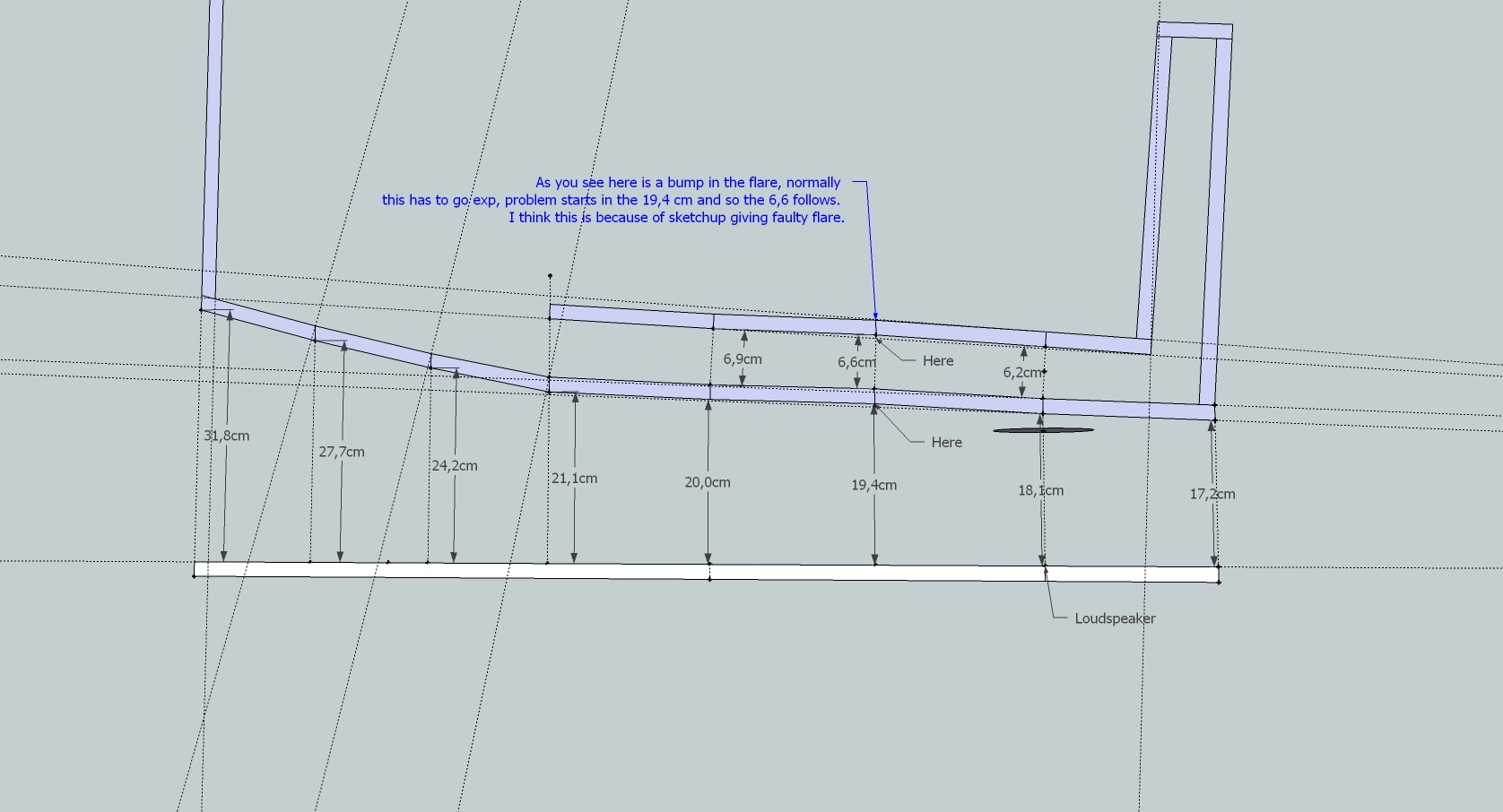

Hi David

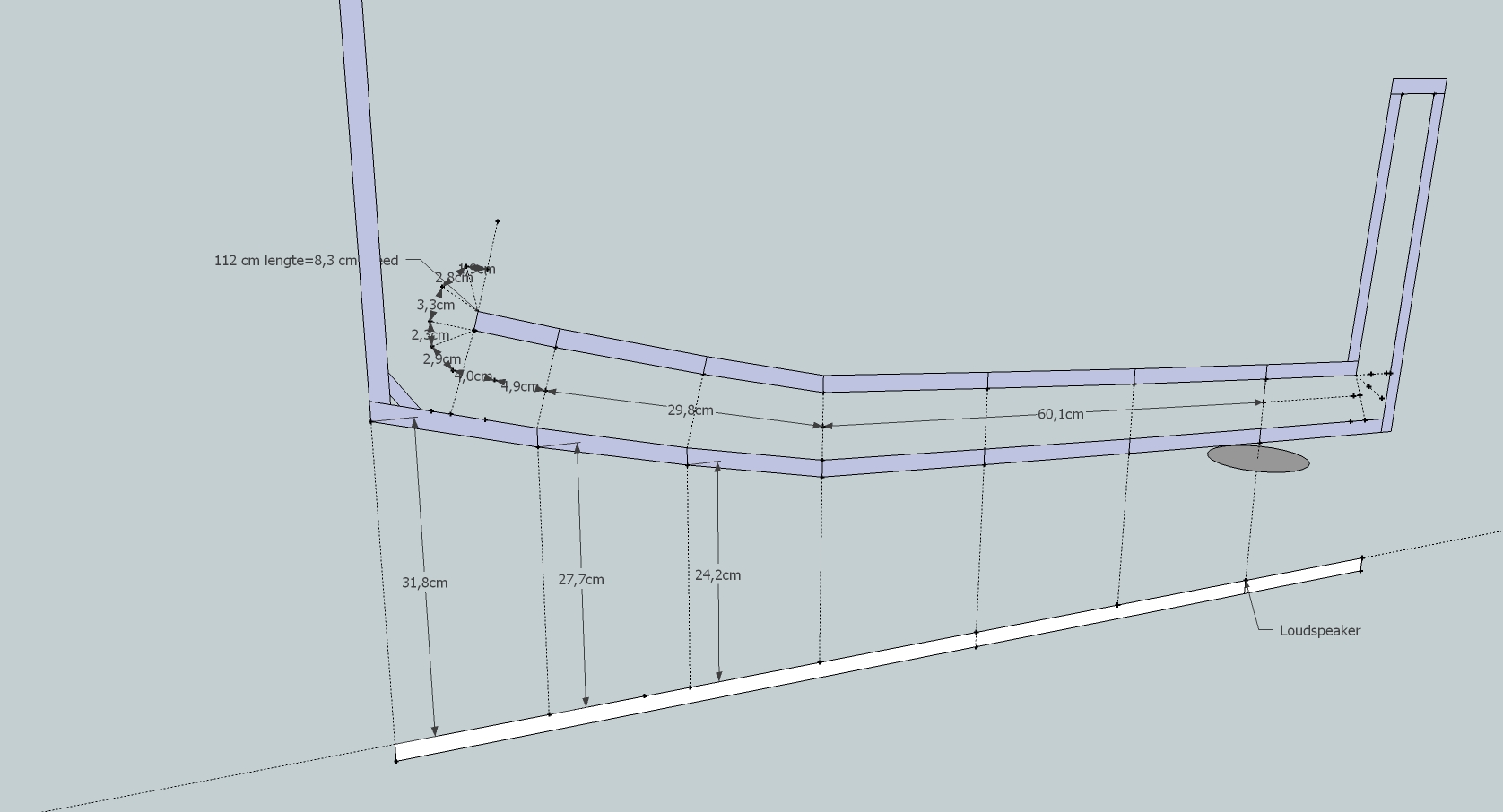

I have done a exp tapped horn with more wood parts for the flare.
I do see that there is a bump on the beginning of the horn, see pictures, it looks
that it is sketchup who do this or the S2 start is faulty..
regards
kees

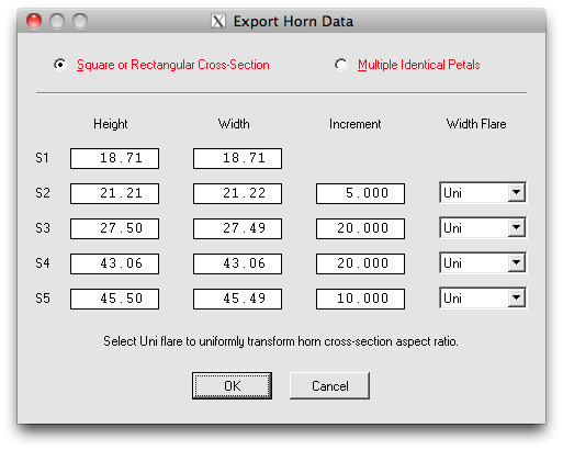

Hi Kees,
I would need more information to be able to comment on your results:
* Screenprint of 'Input Parameters' window.
* Screenprint of 'Export Horn Data' form.
Kind regards,
David

Hi David
The problem was sketchup, sometimes it jumps 0,1 cm or even more, in my case
redrawn it make it oke again.

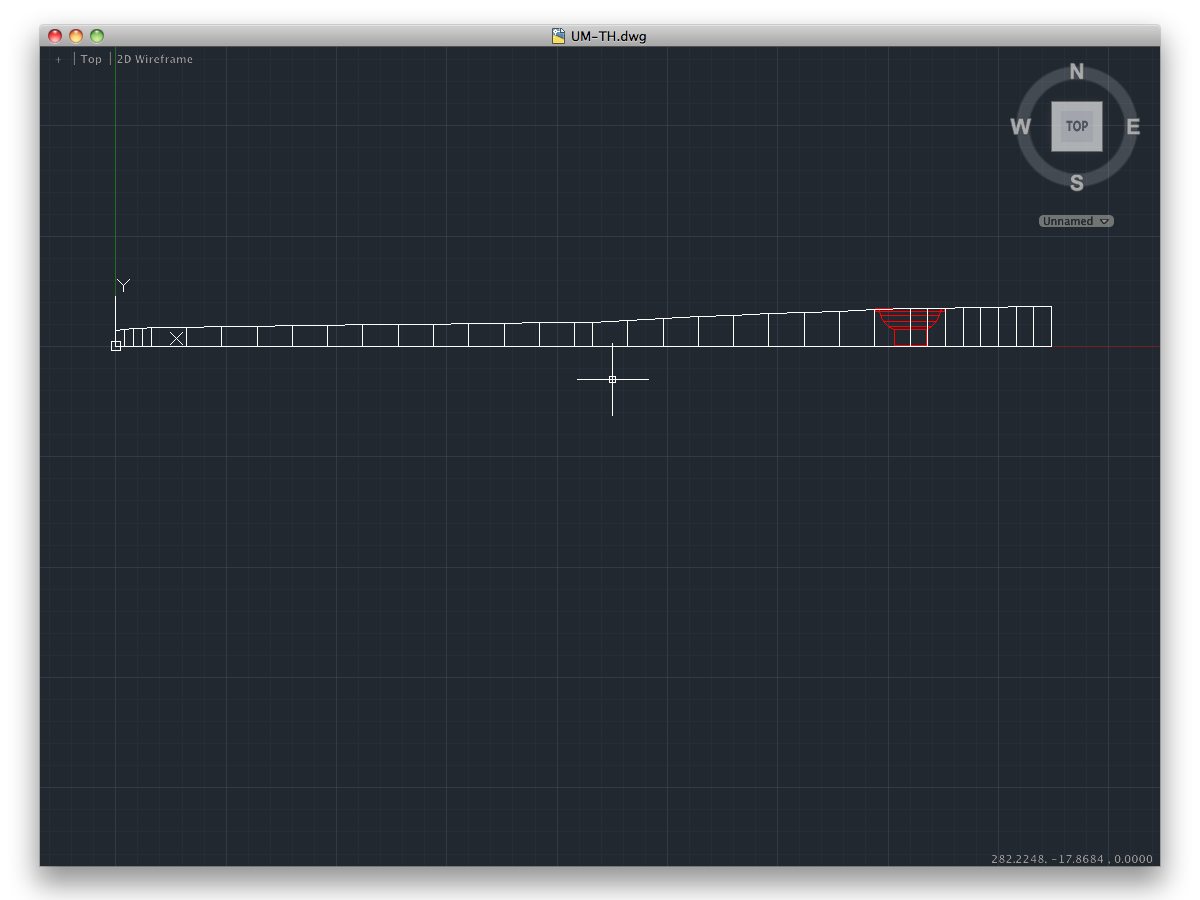

I go learn autocad, sketchup is nice but has to much things I do not like.
Good for fast drawns but for exp flare autocad is better.
regards
kees
I have the problem with sketchup that it jumps sometime, special when closed and the next day opened I see it is jumped 0,1 mm.
also it does what it want itselfs, not always what i want.
I have autocad, but it is not so easy to use, a simpel precise drawn program I have not yet see what I like.
But I have drawn the exponential tapped horn, but to long, so I have to calculate noi now the bends..

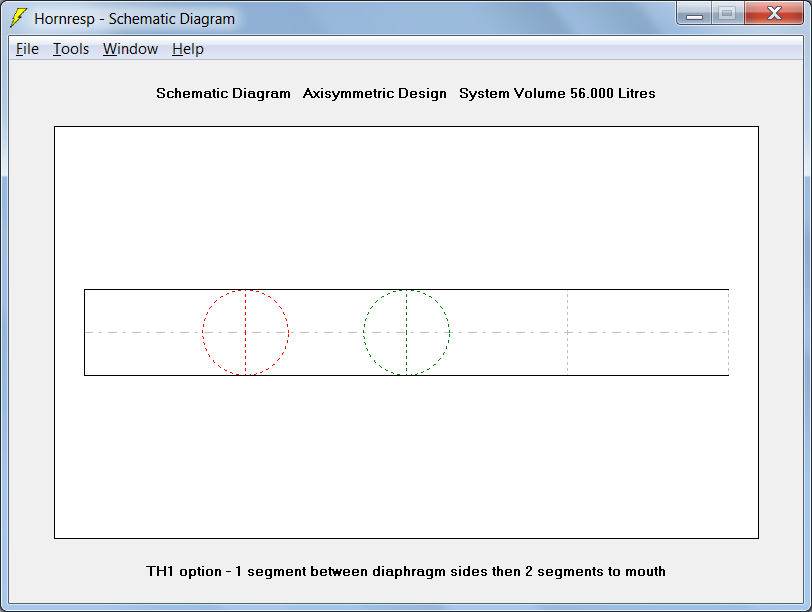

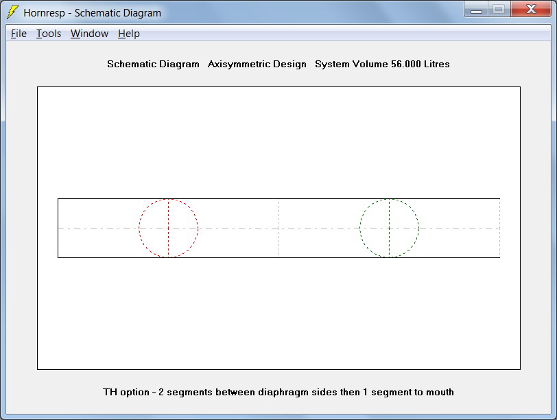

Is it possible to add 2 Symmetric-TH models? (STH of which the path is cut in two symmetric halves). It doesn't need extra reference points, only a change of the driver position from S2 to S1.
The reason I ask, if we now want to model a STH we have to give up one S-reference point (see green arrow) which limits the flexibility we usually have.

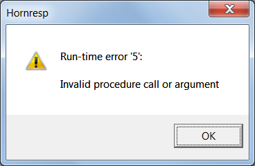

A fatal error was being generated when the Combined Response tool was used with a compound horn system that had identical front and rear horns and a zero path length difference (see attachment 1). The bug was introduced relatively recently, following some minor code changes.
The bug has now been fixed, with a further improvement being made in that the complete cancellation of the combined output due to the front / rear 180 degree phase difference is now handled more gracefully than it was prior to the introduction of the bug. The SPL at zero pressure has a theoretical mathematical value of negative infinity, and in Hornresp this negative infinite value is now indicated as -990 dB (see attachment 2).

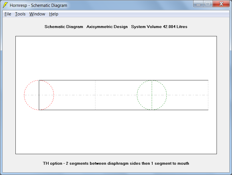

Is the flexibility really any less when L12 = 0.01? The number of segments between the two sides of the driver diaphragm, and then to the horn mouth, does not change - see attached examples.

Hi Djim,
In a tapped horn - when the throat side of the driver diaphragm is positioned at S1.
You are in effect asking for the acoustic path linking the two sides of the diaphragm to be made up of three segments. The maximum available in Hornresp has only ever been two, so the flexibility to adjust a tapped horn design without an offset throat has not really been reduced. Changing the model to allow three segments between the two sides of the diaphragm would increase the flexibility, not keep it the same.

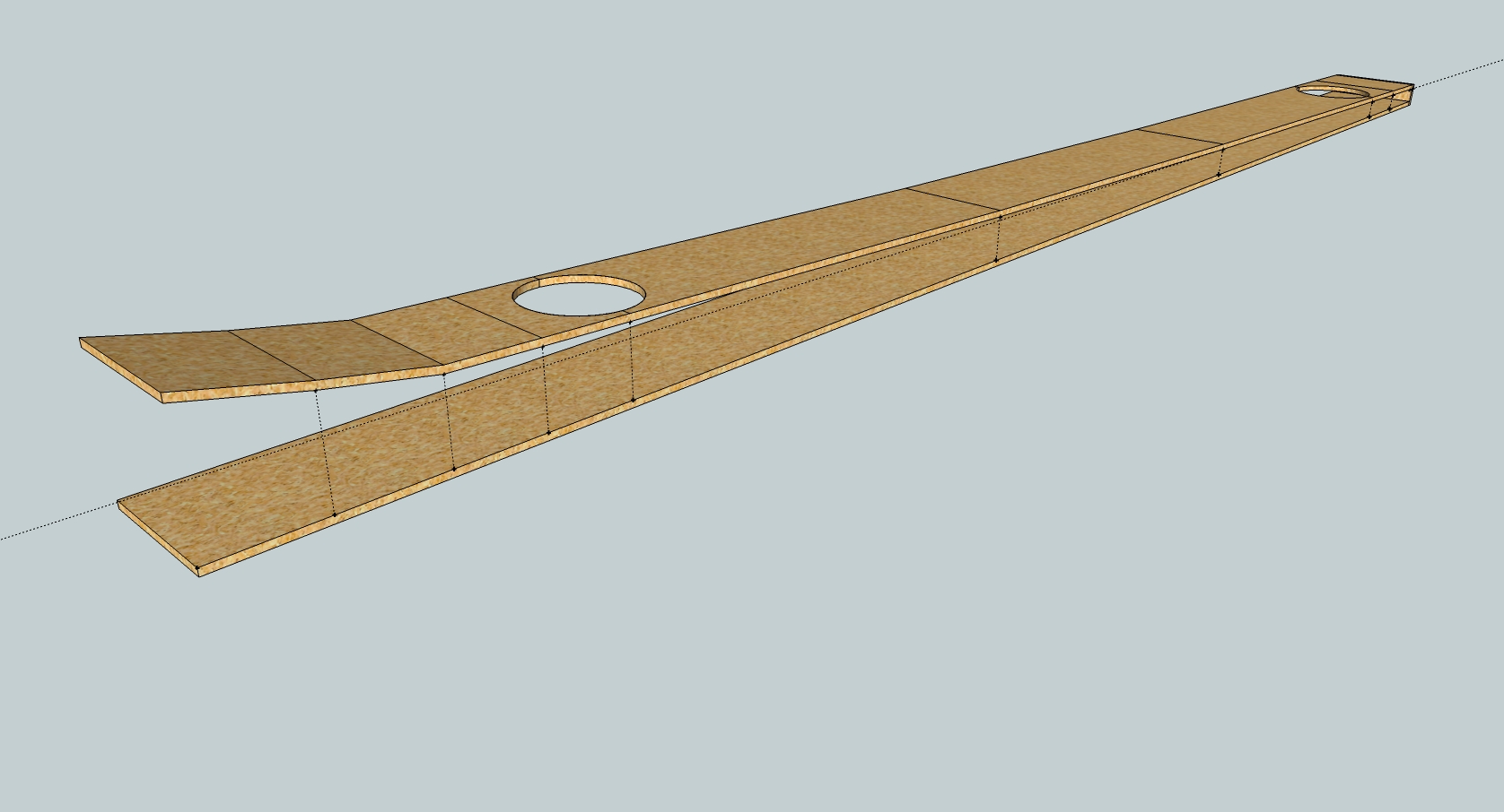

Please forgive me for the noobish question, but I'm having trouble making sense of the exported schematic horn data. I've read a few of the tutorials online about how to get the horn drawn up in autocad or sketchup using that data and I get that far. But, when it comes to bringing the model from 2D to 3D I have no idea how high to extend it.
I'm also struggling to fit my driver in the mouth of the horn.
I've included the hornresp file and the exported data, along with a few screencaps.
Any help would be awesome.
