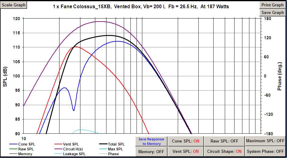

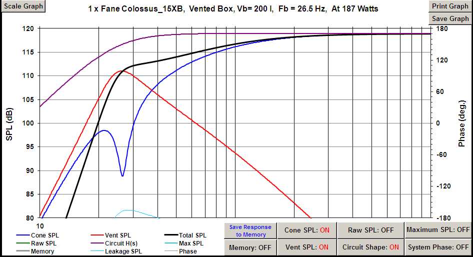

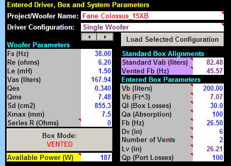

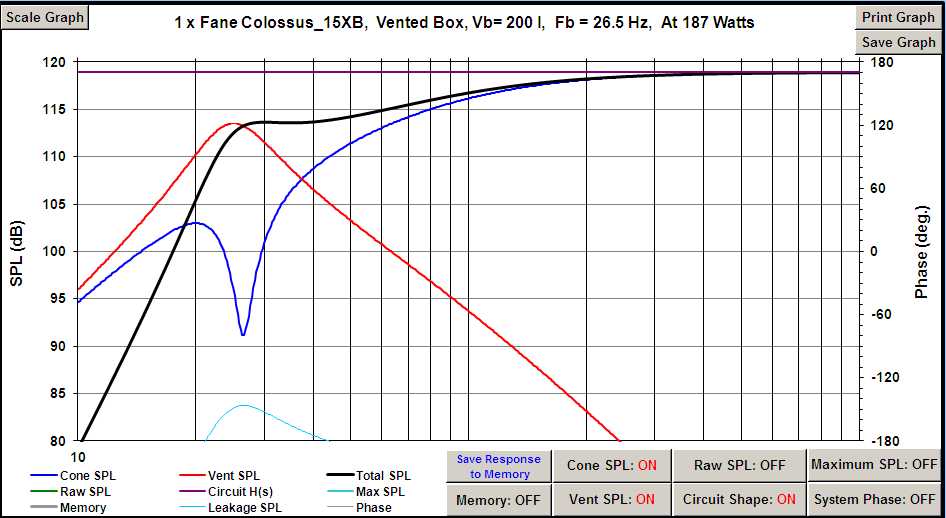

Looking at Bagby's software (Woofer Box Model and Circuit Designer, Version 4.5 12/4/2009) again, it looks like I may have found the basic error: when switching the "Selectable Textbook High Pass Filter" from "Fourth Order Butterworth" to "Fourth Order Linkwitz-Riley" there is no change in the "Circuit Shape" as indicated on the graph; but, when using both of the "Optional Second Order Adjustable High Pass Filter Stages" @ Fc=24Hz Q=0.707 [Gain(dB)=-3.0dB] I get the expected 4th order LR response on the graph. The LP section also shows the same curve for Bw and LR. In other words, I think I may have found a bug (or two) in Bagby's spreadsheet, not in Hornresp.
I'll attach a few screenprints:
1. Bagby's Input screen
2. BP: Dual 2nd order Butterworth HP plus 4th order LR LP
3. BP: 4th order LR (both: HP and LP)
4. HP: 4th Bw
5. HP: 4th LR
6. HP: 2x 2nd Bw
7. SPL w/o filters
8. I'll tried to add Bagby's Excel file by changing the extension from .xlsm to .txt; but, the file size is too big (I can email it to anyone interested).
So, at this time it looks to me like all is well in Hornresp land.

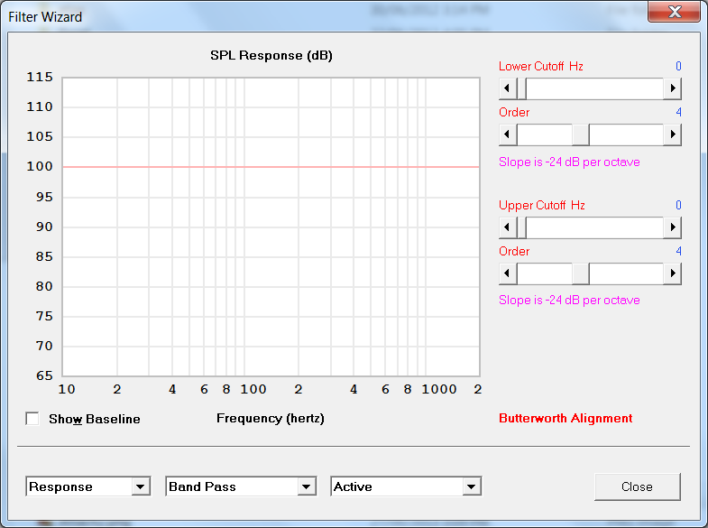

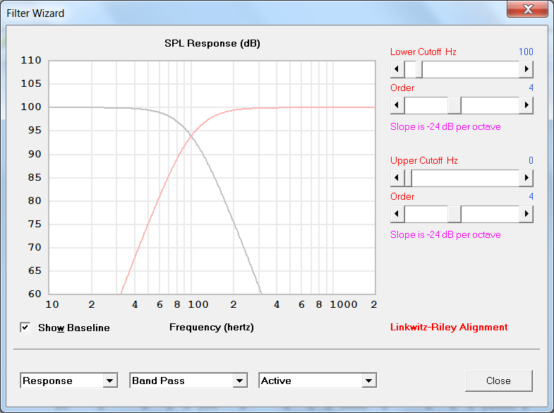

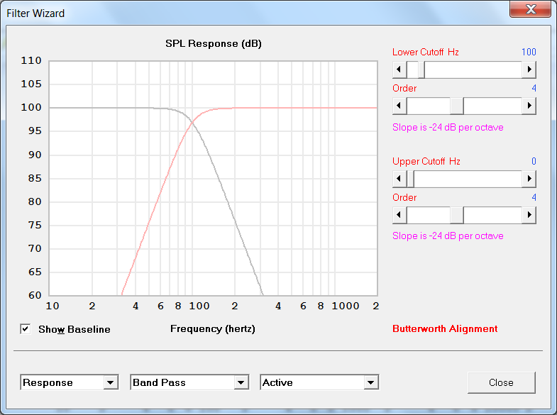

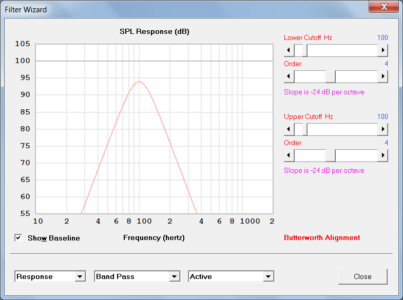

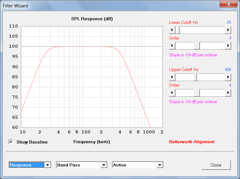

"Red trace - 4th-order Butterworth, 2 x -3dB = -6dB at fc (94dB - 100dB)"
Imagine a 4th-order Butterworth band-pass filter being applied to a 100dB signal:
Attachment 1 below shows the un-filtered 100dB signal.
Attachment 2 shows the filtered signal when lower fc = 25 Hz and upper fc = 400 Hz.
Attachment 3 shows the filtered signal when lower fc = 50 Hz and upper fc = 200 Hz.
Attachment 4 shows the filtered signal when lower fc = 100 Hz and upper fc = 100 Hz.
Attachment 4 is the same as the red trace referred to above.
Kind regards,
David
Ah, I get what you have been trying to describe.
A bandpass filter that has NO passband !
Why ?
Why ?
