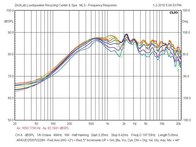

Don't know about you, but that's how I typically listen to speakers. 😀
You listen at 44" distance? That's ... unusual 🙂
2 Ears + brain ≠ 1 mic
Measuring each loudspeakers individually makes more sense (especially at frequencies above the Schroeder frequency) due to interference effects. Is the impulse response gated? Thanks for the data.
Best, Markus
MLS with a 5.06 ms window, 197.53 Hz it says; I guess so.... 😉Measuring each loudspeakers individually makes more sense (especially at frequencies above the Schroeder frequency) due to interference effects. Is the impulse response gated?
It's a miniature of how we do listen, actually. Double or triple the dimensions, and it might be typical, even.
It'd be cool to do it with one of those dual-mic'd head models and sum the results to see the one-toothed comb. 😀

I don't believe you're in the far field at 44" hence the sound field will look different when measured at 2 or 3 m (6.6'/9.8').
If you measure with a dummy head, you won't be able to derive anything useful (in terms of loudspeaker performance) from the frequency response.

Why not give it a try at 2m? Your space looks like you can get the necessary mic and speaker distance from boundaries.
"It's a miniature of how we do listen, actually."
It doesn't miniaturize the vertical dimensions of the woofer and horn, which I don't believe is accounted for just by noting the angle from the mike to their geometric centroids.
IOW I agree w/Markus, you're not accounting for nearfield effects.

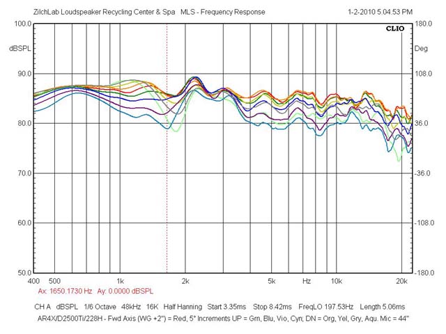

Here it is, one only, in 5° increments to 20° both up and down about the forward axis, at 22.5° horizontal, same as your Nathans, except 4.63" further into the farfield... 😉
