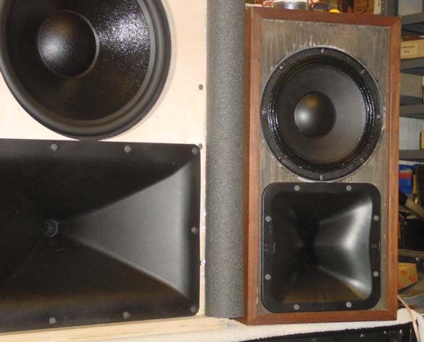

Jackgiff has built with similarly flush-mounted waveguide and woofer snugged up a bit using DE250, and is just now working on an LR4 passive crossover.
Skywave and I do not have them mounted on baffles in boxes yet, but have done preliminary measurements with DE250. I'm rear mounting the woofers experimentally to reduce the offset and C/C distance, and also trying the bolt-on version of D220Ti in the interest of retaining "Econo."
eWaver ROSSO has built them into Altec Valencia cabs with LE14A woofers, but has not done measurements.
I have done preliminary testing with free-standing XT1086 and DE250.

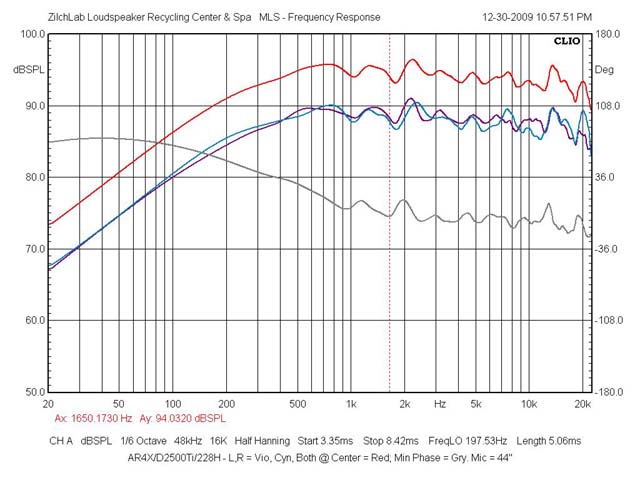

System Vertical Polars
Two sets of vertical polars showing system response of 8" square eWaveguide (JBL PT-D95HF-1) with Selenium D2500Ti-Nd compression drivers and 8" JBL 228H woofers in AR4x cabinets using modified EconoWave crossovers, the pair playing concurrently and measured at the acoustic center between them varying the vertical axis +/- 15° from that of the waveguide, two plots, one toed-in and one not, the latter presenting horizontal off-axis response at 20°, 44" mic distance, 32" separation between the devices under test.

Cursor at 1.65 kHz crossover as determined by the inverse null at waveguide center +2.6°, the system forward axis.

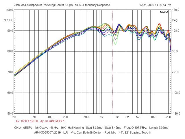

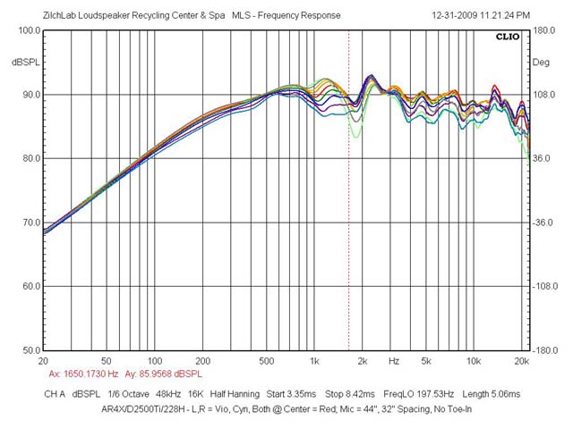

What's the target response and set up of the Econowave?
Flat on axis with uniform power response. I am illustrating the actual response with this waveguide (one of several "approved" by the collaborative) in performance as a pair, both on axis (toed in) and 20° off-axis horizontally (not) within a +/- 15° vertical window referenced to the waveguide axis.
The forward axis in this instance is 2.6° above the reference center, or 7.77° above the midpoint between the drivers, and thus we see the lower null just beginning to affect the system response at -15° below the waveguide axis, the upper null not being manifest within the measured performance window....
The two speakers are on the test stand, 32" apart. The mic is at a distance of 44", midway between them. Aimed straight forward, the angle from the centerline of each to the mic is arctan 16/44 = 19.98°. The measurement is thus 20° off-axis.
Toe the speakers in toward the mic, each 20°, keeping the same centerlines, and the measurement is on-axis.
For each of these two conditions, raise and lower the mic from the waveguide axis (height) incrementally, 3" at a time, and measure at each, to a total of 12" in each direction, or arctan 12/44 = 15.26°, mapping the vertical polar response through a 30.52° vertical beamwidth window centered at the waveguide axis.
The color code for this pair of determinations is:
Waveguide axis = Red
UP = Green, Blue, Violet, Cyan
Down = Orange, Yellow, Grey, Aqua (light cyan)
The lower null is seen beginning to intrude upon the forward lobe at Grey and Aqua, in part because the actual forward axis (located via inverse null) is 2" above the waveguide axis. Note that intrusion is stable between conditions.
For these determinations, the acoustic center is found at each height, and the measurements made from there, with both speakers playing concurrently.
Don't know about you, but that's how I typically listen to speakers. 😀

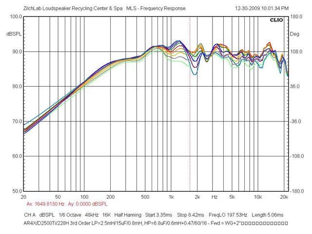

Here's just one, measured conventionally, using the same protocol, except the colors up vs. down are reversed:
attachment.php
Can you tell which one it is in Post #1594, supra?
