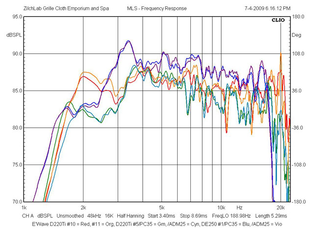

Brandon said he's going to do the JBL and the Pyle again with a BMS 4540 when Thomas brings one over. That said, I don't think it's going to fix everything. I think Earl's 1/3 octave curves are hiding a lot of sins that Brandon's unsmoothed curves reveal in all their glory. It's that pesky old physics thing and what happens when you have a sharp edge at the mouth and a throat that's quite a bit smaller than 1".
What has a throat that's smaller than 1"?
We have a discrepancy:
ADM25 = Selenium, PC35 = P-Audio throat adapters.
Only the thread-on D220Ti shows a shallow notch @ 10.5 kHz with no smoothing.
With throat adapters, D220Ti bolt-on shows similarly high-Q notches at lower frequencies.
DE250 shows no notches.
These are freestanding; I'll see what happens on a baffle....

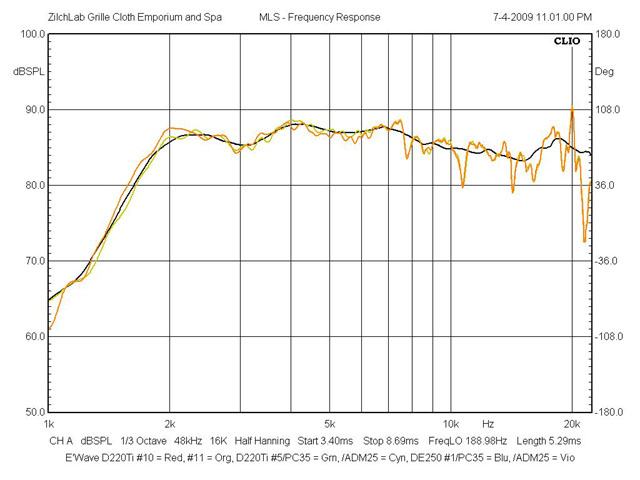

The worst of them, orange, mounted 1" down on a 17" x 21" baffle, yellow, then smoothed 1/3 octave, and the familiar EconoWave response curve appears.
I've got to wonder if there isn't some heretofore unrecognized anomaly in the Pyle PH612 metal insert throat. I'll have to order a pair to see, apparently....
