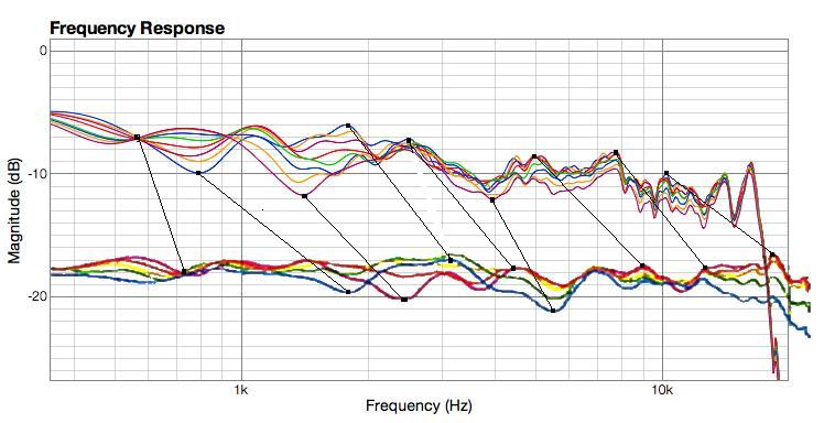

What are the measurement conditions of these two plots? Mic postion? Mic distance? MLS? Swept sine? RTA? Gate length? No gate? Nearest boundary?
Don't tell me I'm going through all the trouble to compare the two when one guy is using an ungated swept sine and the other a MLS signal with a 3ms gate and 1/3 octave smoothing. And being 1m for one and 2m for the other would ruin it for me too.
I did start horn testing last night though so at least we can compare these under the same measurements conditions. I'll be using the B&C DE250 for all them, but may run additional measurements with a BMS or Selenium screw on CD for that type of horn as the B&C with adaptor may unfairly penalize the screw type horns.
Mine are at 44", and Markus's, 1M, according to the record here. Pics of ZilchLab are plastered in a half-dozen forums; it's freefield, basically, but rare that I clear the room.
Tweeter height was ~53" as I recall, with a 10' - 6" ceiling height, or close to that. I adjusted the window for each measurement as the first reflection varies with mic height, and the one in the legend would be for the +30° curve, last taken but not shown. Yes, I have that plot, also, but my intent was to capture +/- 10° about the lobe center, and those curves had more like a 5 ms window, with resolution to ~200 Hz.
I smoothed to 1/3 octave because that's what Earl does in all of his plots and it allows visualizing the underlying trends, but I can show unsmoothed as well. I typically work at 1/6 octave, given the measurement conditions here, which are somewhat less than ideal.
Markus's plots are at 22.5° horizontal, and mine on the horizontal axis, though I posted my first look at the Geddes recommended angle earlier. As everyone now knows, Earl measures but does not publish the vertical polars for his products; this was the first independent look at the behavior, and it's clear that the system must be EQ'd at a particular vertical angle to define a desired listening window.
I doubt you intend to measure system verticals, which would require configuring a standard configuration for each horn or waveguide studied, but those are the caveats -- find the center of the vertical lobe in the particular complement and alignment (the anti-phase null gets it precisely), EQ the system there, and then measure the polars. Anything outside +/- 5° is likely to exhibit significant variability due to driver interference effects....

The Zilch Effect:
It's a nefarious intercontinental HOM conspiracy, obviously, either that, or the Mona Lisa in a grilled cheese sandwich:
You must be a hit at parties...
See this is where the whole thing goes off the rails. With no standard position it's easy for one set of plots to look good and another to look bad. I'm not real clear what axis Markus actually measured his Nathans? It's either on woofer, on tweeter, or the center of both, the last two of which would be reasonable as most people would set them up to have those axes at ear level. To be fair you need to pick one of those conventions, because finding the center of the lobe and then going +/- from there does not represent a typical listening axis. It's cherry picking. The main lobe could be pointed at the ceiling for all we know, but if you use it as your axis and then measure in a tight window vertically of course it's going to look better-but it's not representative of what a listener would hear in a typical installation.
That said I think it is possible that yours may be smoother through the crossover, simply because you are crossing close to the horn cutoff and my bet is that the flaring response is filling in what should be a null. You didn't intend this effect, but it is probably whats happening. After all for two non-coincident drivers using textbook slopes there MUST be a null vertically, if there is not then your response is not following any of the standard filter slopes. Where this gets hazy (to me) is what this means. This goes back to my stupid idea I posted in this thread a week or two ago. Clearly the lobing will not be predictable based off the standard filters. Could be worse or more uneven as listening position changes, which is what usually happens. But maybe not. If you have full polars and it shows the ripple to be fairly smooth, then I guess that's the proof in the pudding. Back to my idea what if you crossed right at the point the horn response flare peaks vertically? It's like a variable directivity filter that offsets the nulling effect of non-coincident drivers.
No system measurements as I have no systems to measure. I'm not measuring whole speakers, just the horns themselves. When I do build a speaker I'll do full polars, but not referenced to the main lobe as that is not accurate IMHO. I'll measure from the design axis which will probably be just below the tweeter center.
Another thing about the horn flare filling in the null, if the vertical response is smoother that's a good thing, but there must be a corresponding increase in the amount of energy directed at the ceiling/floor which will end up interfering at the listener position, no? How will this impact sound? I don't knwo if this is good ro bad yet, I may have to experiment with my loudspeaker to see, unless someone can tell me why I'm completely offbase with this whole idea, which is more than a little possible!!
The ironic thing is that as you push the nulls far apart and/or fill them in you actually increase the floor/ceiling reflection energy. Which is the exact opposite of what you stated as a goal Zilch. This was the point I was trying to make weeks ago.

augerpro said:
Lay the speaker on its side on a stand and you wouldn't have to change gates.
Yes, of course, with a rotary platform, but Earl was making a big deal of how difficult that is at 22.5° horizontal, even after we suggested some simple solutions, so Markus and I did it just by moving the mic up and down, and got useful results.
"Very hard" being the case, I have to wonder how Earl managed to obtain the 45° oblique measurements in his original study of the Econo Waveguide, topic of this thread. I believe we have smoked this one out.
It doesn't matter if the reference is the center of the forward null, which is the case in the overlaid plots. Markus's was at -10° and mine at +10°, relative to what doesn't matter, as we both show +/- 10° from there.
Yes it does matter. The lobe could be anywhere, but there are only so many listening axes. I don't even know you say such a thing when you follow it with this:
