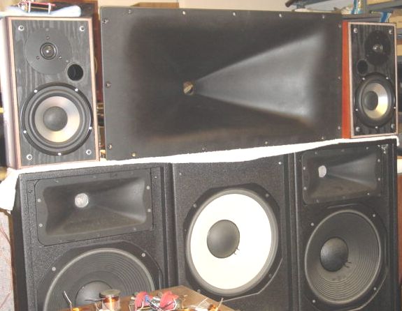

That is indeed a very cool site. The driver openings appear to be 1.4" and 1.75" respectively for the two horns though, which changes my usage (I was thinking of using a JBL 2426H)
Any adaptor is naturally going to compromise the throat geometry.
I am sure those measurements are for the voice coil and not the exit aperture. The 1.75" (44 mm) looks to be a standard 1" bolt-on diver.
The 1.4" is also a 1" bolt-on driver (apparently from Celestion), but the two-bolt pattern is backwards from standard. ie. you thread into the horn, not into the driver.
[edit] .... oooohhhh, beaten to the punch!

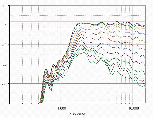

Earl Geddes at gedlee.com said:
The first two plots are the horizontal polars. The next two are the vertical polars and the last two are an an oblique angle of about 45°. Rectangular horns often have poor response along this oblique angle.
The JBL actually outperformed the ESP12 at this angle in some significant respects:

Well, we'll see how the QSC does. MY WAG theory is that most 'rectangular horns' have a problem on the oblique because they are using two different methods of pattern control for the horizontal and the vertical. I don't see why it should be a problem if there's a nice smooth 'waveguide' transition from round throat to rectangular body. But I've been wrong before. Whatever, the JBL is too small and cuts off too high for my taste. I'm looking for something to use with a 15" like the AE TD15M. Size matters. 😉

In any case, adapting these to the 2426 (which, being the quality of driver it is, I'd really like to use) is going to be problematic. Since the mounting bracket can be removed for screw-on horn usage, I'm going to give that a try with Zlich's econo waveguide 🙂
Having a solid crossover to start with doesn't hurt, nor does the presence of bass cabinets under construction that would mate perfectly 😀
I'm also playing with casting throats for an OS waveguide and I have the throat geometry pretty well worked out, I just need to get the large conical section figured out, and how to blend the two..... Suffice it to say I may have found a solution to our challenge with OS manufacture. I'd not mind the geddes units, but the cost is high (though fair, given the limited market and PITA factor).
