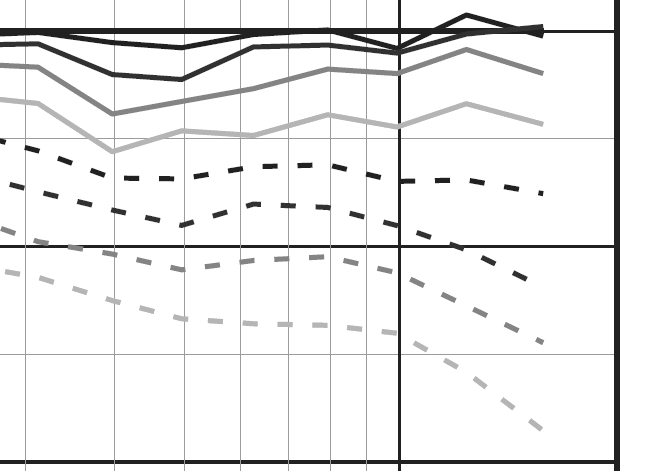

pos said:
some of them do:
http://www.jblpro.com/catalog/support/getfile.aspx?doctype=3&docid=1078
see "Horizontal Off-Axis Frequency Response" on page 2, aligned for 0dB on axis. The 10° curve is louder than the 0° curve around 12khz
Actually, it's not if you zoom in on it, although you could say it's an RCH louder at 16K. 🙂 And this is a 90x90 which should be a 'worst case.'
The 0° curve is aligned to 0db, so what appear as a peak around 12khz for all the off axis curves is in fact a dip in the on axis one.
By the way, this dip can be seen on the on axis response curve:
I do not say that this waveguide is bad because of that dip!
In fact I ordered a pair and I am going to use them as a tweeter.
I find its directivity control very impresive in the UHF.
