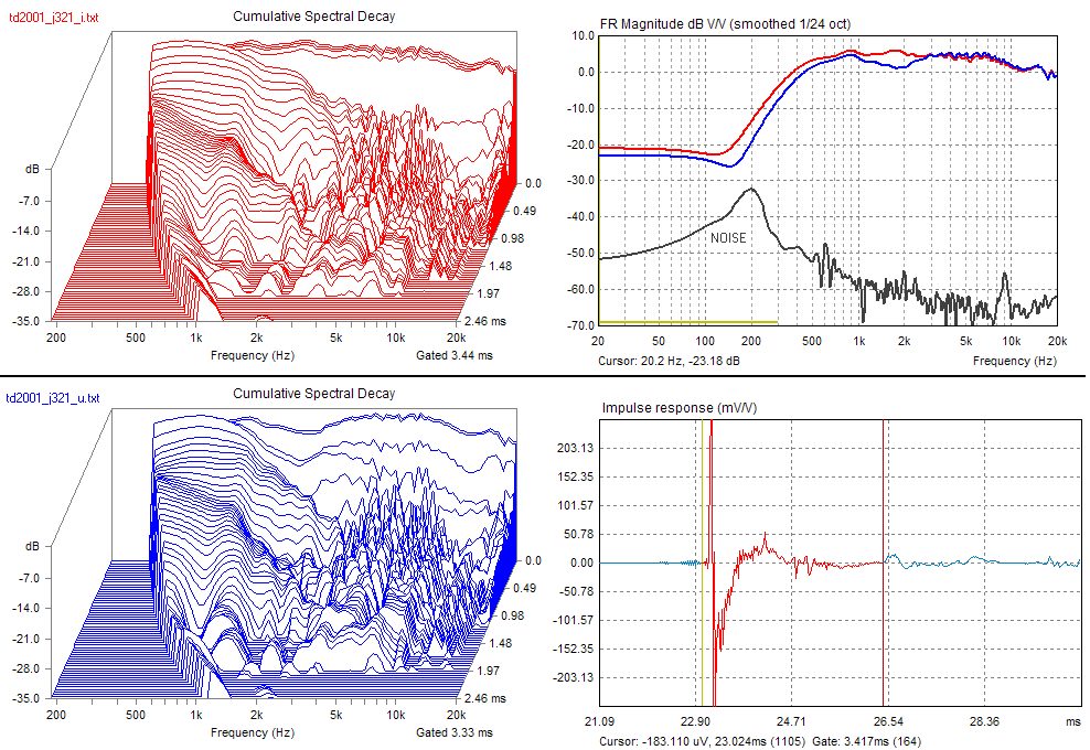

Hello,
Few of you may ask why I use my TAD TD2001 current driven.
First they should analyse the attached pulse response obtained at the same moment, in the very same conditions as for the pulse response of the current driven TD2001 on J321 horn. I just uses for that mesurement an amplifier with a very very low output impedance (a Bryston PP120). The level was set at 94dB at 1000Hz. Measurement is still made at 1 meter.
Attached file: pulse response of the TAD TD2001 voltage driven on Musique Concrète J321 horn (Fs = 48kHz, 16 bits)
Best regards from Paris, France
Jean-Michel Le Cléac'h

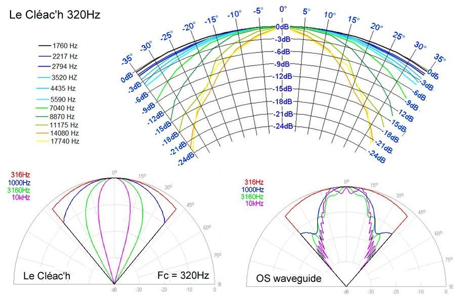

Hello,
The Le Cléac'h horn is not a device designed to control directivity but to insure the best resistive load to a loudspeaker within a very large interval of frequency. No equalization is needed for a good loudspeaker if used with a Le Cléac'h horn.
Many audiophile use Le Cléac'h horns having low frequency cut off as small as 160Hz, 250 or 320Hz in 2 ways system (eventually some equalization above 4000Hz may help). But if you want to retain the best resistive loading as a factor of quality (many do despite what is often said here) and if a low directivity or a controlled directivity is very important for you, you have 2 solutions:
- don't use a ( single ) Le Cléac'h horn
- use several Le Cléac'h horns (low-mid/mid + high-mid/highs...)
polar chart measured by me on a Le Cléac'h horn Fc = 320Hz
+ simulation under Hornresp and compared simulation for an equalized waveguide of same dimensions.
Note that below 6000Hz the Le Cléac'h 320Hz horn spreads the sound over an equal or larger angle than the OS waveguide and over 6000Hz it spreads the sound over a smaller angle than the OS waveguide (well this is using -3dB points for what it worth).

JoshK said:
Do the Le Cléac'h horns beam? Do you have any polar response charts anywhere?
Jmmlc said:
Hello,
So basically any comparison between the Leclech horn and my waveguide is rather pointless because they are designed to do completely different things. One is clearly Constant directivity and the other isn't - intentionally so, as you say.
The the real discussion then should be whether constant directvity is desirable or not. I would have thought this discussion to have been resolved already.

tinitus said:
How do I construct a LeCleach horn ?
Are there any essential speciality to look out fore ?
"Do the Le Cléac'h horns beam? Do you have any polar response charts anywhere?"
From the posted DI plots yes they do. You can't get flat on axis response using a compression drivers without EQ. You can use electrical EQ or use the DI from the horn. To me electrcal is the way to go with a CD type horn/waveguide. That way you get good power response and a much larger and more consistant listening widow. Less than 30 degrees for -6db points is tight. That is one small widow.
