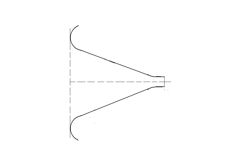

I will try from memory
Horn length is NOT important
Throath and smooth transistion to "hornpath" is important
Mouth rounding is important
Mouth size determines lowest FR
Other than that I dont recall any other information
Does it look like this ? ... well, throath need reworking, but its hard to draw

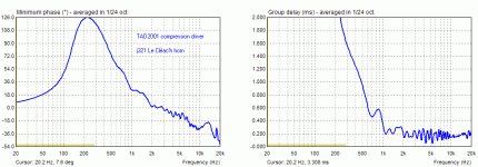

Hello Jzagaja,
The minphase curve and the group delay curve you obtained on the pulse response I measured are similar to the ones I obtained with my own Matlab routine.
I presented such group delay curve I mesured on an older Jerzual 320 Le Cléac'h horn in the conference about "phase distortion" I gave at ETF in 2004 (too bad the document is no more downoadable on the website http://www.triodefestival.net )
But the same group delay curve can be seen in page 46 of the document of the conference in French I gave in March 2005
at the French association Melaudia: http://www.melaudia.net/zdoc/distorsion_de_phase.pdf

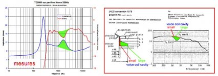

Hello,
Most horns create reflected waves from mouth to throat. If you see the pulse response of such horns (+ loudspeaker) you see small pulses delayed from the main pulse by the time for the wave to go from mouth to throat and then come back from throat to mouth (= more or less the double of the time for the sound to move along a distance equal to the double of the length of the horn.)
How can you imagine that some equalization can make disapppear those delayed pulses? It is impossible and this explain than most horns cannot be considered as minimum phase device.
There is no such reflected waves in a "complete" Le Cléac'h horn which one behaves more accurately as a minimum phase device (at least above 1kHz if Fc = 320Hz)!
Reflected waves may appear as tails parallel to the time axis at different frequencies on CSD graphs. You can see those tails on the CSD graph of the JBL horn (and of the waveguide eventually), you can see only some noise but no such tails, on the CSD graph of the Le Cléac'h horn. Also some elements on the group delay curves may be interpreted in the case of the JBL and the waveguide as due to reflected waves from mouth to throat...
When the Le Cléac'h horn is mounted on a compression driver the impedance of which obeys to a simple equivalent model ( this means: without parasitic phenomenons leading to delayed energy release), then it is benefitial to feed the driver by a current source. You cannot do that with bad drivers. The result is that the response curve of the compression driver mounted on the Le Cléac'h horn becomes independant on the impedance curve .
Give a look to the attached graph:
On left (my measurements), the blue curve shows the very smooth impedance curve of the TD2001 when mounted on a J321 Le Cléac'h horn. In red you see the response curve of the TD2001 monted on the J321 horn when source impedance is very very low (voltage control).
Please note:
Every shape element on the response curve (for F >450Hz where the horn behaves like a nearly pure resistive load) possess its "inverted" equivalent on the impedance curve (this is not a coincidence, this has a meaning!).
On right: according to Ken Kinoshita (in JAES, 1978), the hole in the response curve of the TD2001 when voltage driven is due to the cavity beneath the coil. The resonance in that cavity is translated on the impedance curve as a peak in the frequency interval 1000Hz - 2000Hz. If you use a voltage source to feed the driver the current through the coil will then be reduced in that frequency interval and there will be a dip in the response curve (the famous 1600Hz or 1900Hz hole in the curve of the TD2001). A current drive will avoid this problem (this is not a simple equalization as one could eventually say...) .
Best regards from Paris, France
Jean-Michel Le Cléac'h
jzagaja said:
Dear Jean,
I was told by the experts that horns aren't minphase devices and cannot be corrected with minphase filters. Well I've tried them (digital) with good results. Does it mean that minphase component cannot be used for an ebaluation - I don't know.

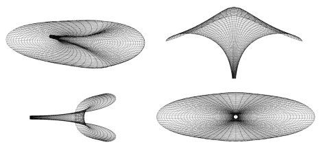

Hello Earl,
In fact, my reponse for a better control of directivity (at least in the horizontal plane) will look more or less as the attached image.
