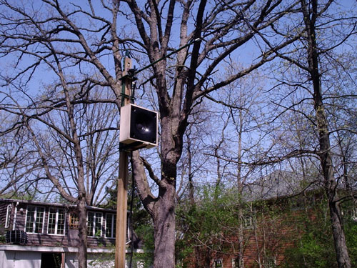

For what I do, measuring speakers (usually for the purpose of gathering data for crossover development) I use 2 meters most of the time.
Even with the TDS system, at 2 meters, it is desirable to use a tower to reduce the magnitude of anything other than the direct sound as much as possible.
Here is a shot of a speaker on a tower with a mic at 3 meters.
In this case, 20 feet high is sufficient.

Yes, I used many different techniques to obtain as large of a time window without reflections as possible. Unfortunately, outdoor measurements can be very problematic due to temperature variations. I suppose if you live in Southern California it might not be too bad. But many suspension components are very sensitive to temperature, especially many of the commonly used ferrofluids. When I first used Dynaudio tweeters with ferrofluid 20 years ago I found that only a few degrees F could make a big difference in the T/S parameters.
Indoors it is difficult to find a large enough space. Our building had one section with a 20' ceiling. Putting the DUT and mic in the center allows roughly a 20 msec window.
But as you can see from the article in Stereophile, this is still only giving good results down to perhaps 500 or 1000 Hz.
