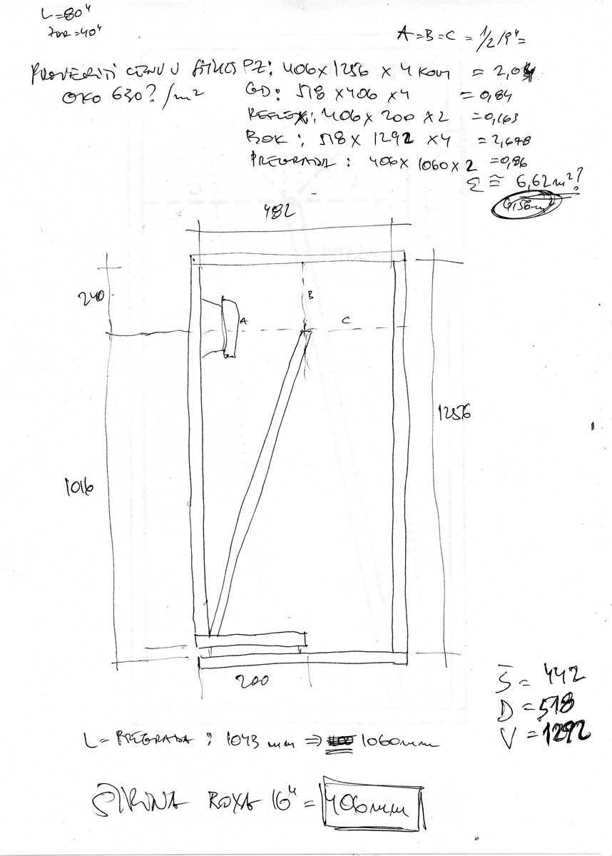

whatever you do , you'll end with some big honker in big tall TL box , with horn on top
one 15" per box will make your life easier
if you were satisfied with your present liliputan spks , that will be certainly more than enough
anything bigger than that will overload the room , meaning exactly what you wrote - that you'll need to back up more , to ensure blending of all drivers

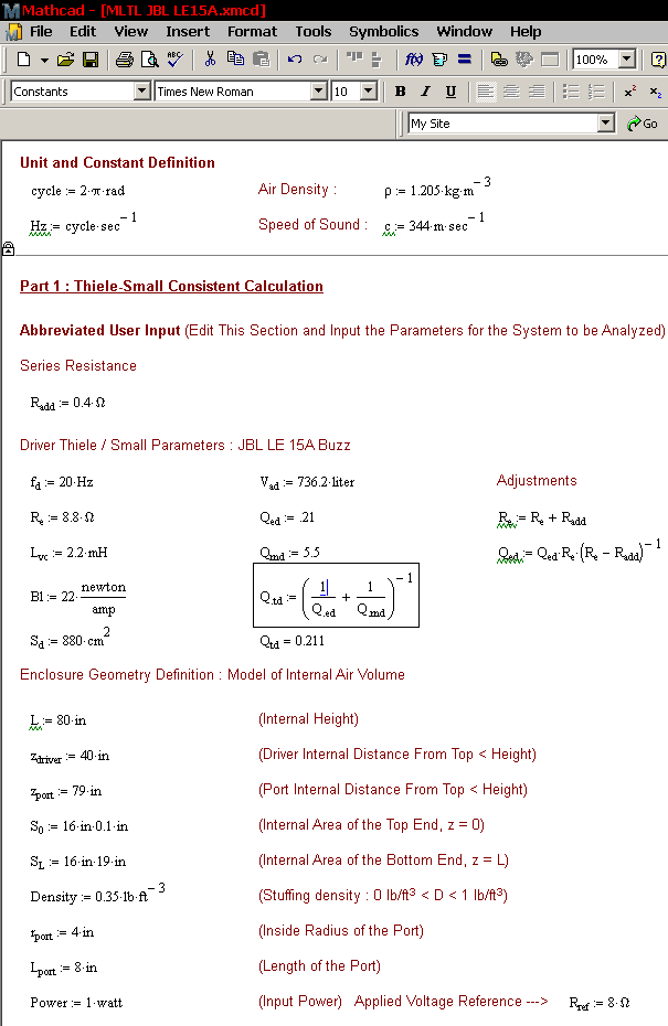

I was thinking that I could try dual 414's in individual boxes similar to what you calculated, conected side to side, ( maybe single large version). I could try the single 15 route with the JBL. It is not an altec but has very similar parameters, big VAS, low fs, low Qt.
we'll know more when you give us exact measured T/S , but I'm not expecting small boxes however ; what's dictating size is F3 and , combined with certainly not so low Vas ......
so - with 2 per side , it will go bigger than with one 15" , most probably , while I'm not expecting that solution significantly superior to one 15"
remind me ( yakyak , multitasking & multithreading , while I'm dumb ) where in thread are T/S for these JBLs ?
what I'm urging you all the time , is to go TQWT or MLTL ( whatever , I'm too dumb to differentiate them properly
) and leave plain BR for non-unitiated ones

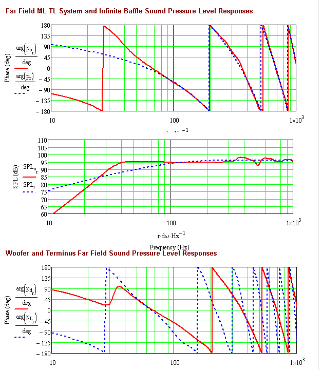

something's wrong
while inputing data in MJK ML TL sheet , I'm getting Qts of 0.334 from rest of data

Fs-20
Qts - .202
Qms - 5.5
Qes - .21
Vas - 736.2
re - 8.8
Le - 2.2
BL - 22
MMS - 97
Which driver? Sd used?
