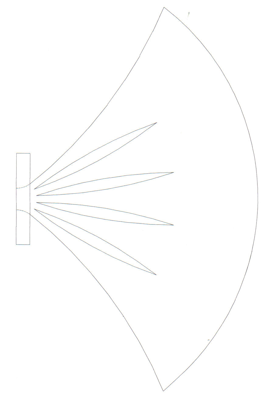

Here is cad of the 290 with some alterations.
THe fillets are extended slightly to be a mirror or symmetrical image of the side walls. It may mean fancy wood work, but with all the talk about symmetry, I thought I wold give it a try.
The mounting bracket has also been contoured, i.e.poor mans cantenary to accommodate the exit angle of the 288. I also plan to try having the intersections of the side and top of the horn be a rounded so that when it all comes back to the entrance, it will mate well with the driver. Probably stupid when you considered he was using a hand plane to make his versions, but what the hell, this is DIY and I am ignorant.
I decided to go with 290 because the 480 is suggested to cross too high and seems a waste of the ability of the 288 drivers. If this is incorrect thinking, fire away.

The fillets are extended slightly to be a mirror or symmetrical image of the side walls. It may mean fancy wood work, but with all the talk about symmetry, I thought I wold give it a try.
Please clarify: Are you referring to the fins inside the throat? I think of fillets as the concave transition (cove) between one surface into another...in this case the area between the horizontal and vertical surfaces in the horn.
The fins. Fillet is the wrong word.
The fins were centered on radial lines at 19 degree intervals. The outside curve is plotted from one of these radial line. With the outside radial line remaining, and the curve plotted over top of it, youhave part of the curve to the outside of that line and part of it to the inside. If you were to take the interior half and mirror it on the outside of the outer line, you would get a fin. This fin is very similar to what he has included in the drawings, being only slightly longer. I decided to keep this shape rather than use his simply because I liked the idea of symmetrical walls. It would seem that a wave passing along the two dissimilar shaped would be more problematic than that same wave passing across symmetrical walls. I look at it like the two main sides. What would happen to the response if one was different than the other? Completely uninformed opinion, BTW.
My reason for asking:
The fins appear to me to be straight. I think I understand the intent for this from a builder's perspective. However, the outermost fins enter into the throat region where the wavefront is still rapidly expanding and wrapping around a corner. I think more diffraction will be generated by their presence than any good they will do.
I question whether I would want fins at all...just thinkin' out loud...
While I have yet to post the side view of the horn, in the original, you are correct, the fins are limited to the straight section of the horn throat. Mine would extend to the point where the horns begin to open up. My description above pertained to the overhead view of the drawing. From this view, the only difference between mine and his is the length and shape, neither being drastically different. I am unsure of the fins as well. My prototype will be screwed together, so they can be removed. Both ways will be tested. I worked on the guides for the router today. I hope to shape the horns tomorrow.
Edit:
I wonder if the theory is that the wave will expand as it leaves throat, it shape is changing and will encounter the fins at the same time. If not, I agree with you that it would seem to do harm in that it would interact in an uneven way with the wavefront.
