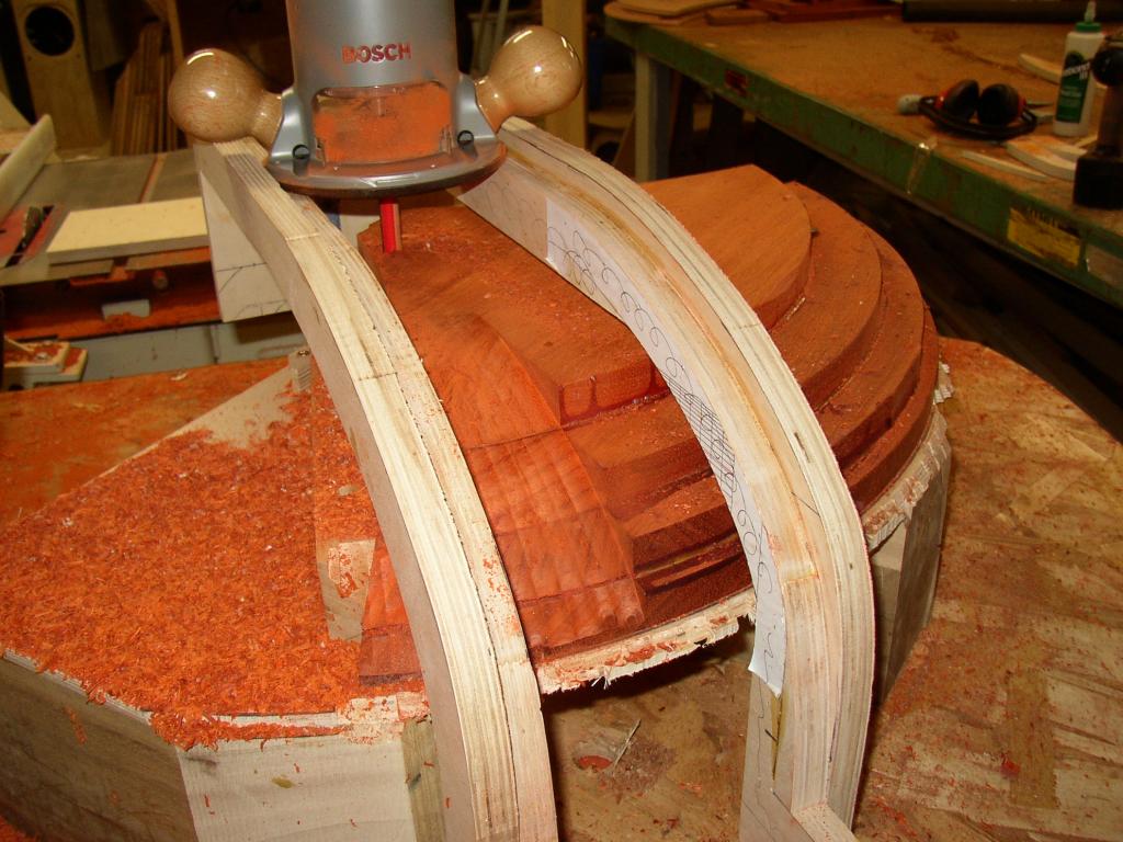

Here is what my jig looks like. Mine is not as deep.
Routing begins tomorrow.
One thing I have already learned is when preparing laminated pieces of wood, you should cut decreasingly smaller forms so that when glued together, you have a stair step effect. Because i did not do this, I will have to eat away at top corner before getting jig in place for final form. BAsically reduces amount of material that has to be removed.
Second pic is a good idea for horn over single 15.

Thats a blow 🙁
Could you cut a 10cm wide block to the horn contour, cut it into several equal slices, glue/screw them to a base in a fan. Then cut some ply petals and stick 'em over the resulting frame? (maybe even papier mache it)
big up for the effort though. I'll be buying in my horn. I'd to damn stupid to be let loose with a router 😀
I sanded the top of my fingers down to the bone on a vertical sanding disc at school. Showed the teacher, who passed out. Had to walk myself to first aid.

I moving head in stubborn fashion. The jig problem is no big deal. I will work it out. Be gone most of next week, so will be a while.
