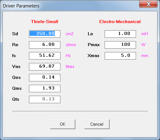

For entering driver data: enter Sd first / double-click on Cms and enter Vas / double-click on Mmd and enter Fs / enter Re and Le / double-click on Rms and enter Qms / double-click on Bl and enter Qes /// to check: double-click on Sd, and a window will show what was entered, and what Hornresp calculated, also, here we can enter Pmax and Xmax.
Alternatively, simply double-click on the Sd input box in Edit mode and enter the Thiele-Small parameter values directly into the Driver Parameters form, and then close the form by clicking the OK button. The driver electro-mechanical parameter values on the main input form will update automatically to reflect the entered Thiele-Small values.

Hi Jesperino,
You are designing a whole new enclosure. You could try to simulate this in Hornresp using the TH1 Driver Arrangement. I'll attach a quick stab at this, I made no attempt to arrive at a design or accurate numbers, just move the sliders around in the Wizard, and see what happens.
The results match that of mine where the saddle shape FR emerges when using an extension. It appears the mouth size of the final exit somewhat affects this but not completely. Curious what it takes to fix this. I suspect a sub with a rising FR would do better but have not simmed any YET.

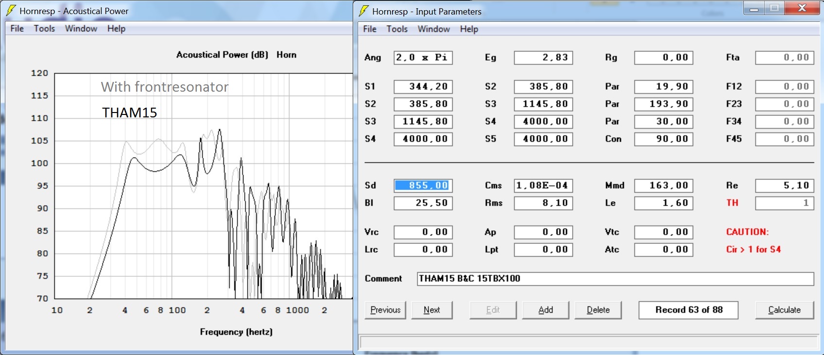

If you add a front-resonator to the THAM15, the resonator can be detachable and hinged in the corners and foldable for transport. It is just a huge duct with a large cross-section and the right length to create a quarter wave resonance centered at the dip in the midbass respons of the THAM.
The quarterwave resonator has a wide enough resonant bandwidth to increase the efficiency of the whole bandwidth of the tapped horn - and even widen it somewhat which you can see in the simulation I posted in my previous post.

Here is a better balanced version of the resonator-enhanced THAM15.
A shorter resonator with larger cross-section.
It adds 7 dB efficiency at 80 Hz, the center of the midbass "kick".
Many THs have a dip in the response in the midbass, where you usually would want a small peak to accentuate the midbass "punch" and energy.
