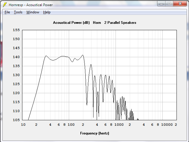

Oliver/TB46 did a great job explaining how to sim an extension in HR and I wanted the info in this thread:
SNIP "here is what I did:
1. file name: TH1T_org - pick a TH simulation (this was a SS15/xoc1 style for the 18TBX100)
2. file name: TH1T_th1 - change from TH to TH1 (using EXP instead of PAR was closer in volume)
3. file name: TH1T_2x - double drivers/areas
4. file name: TH1T_2xE - add extender"
He even posted the HR files.
http://www.diyaudio.com/forums/subw...30-ft30-pa-th-awesomeness-89.html#post4819794

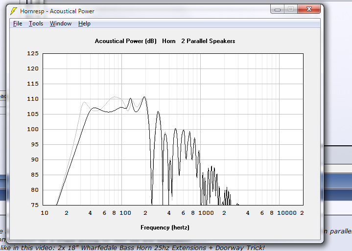

So based on these files here is 2 cabs with a shared horn extension vs 2 cabs. Shared horn in black and 2 cabs in grey. One thing is interesting is that FR changes a bit and I didn't expect it. A pair of the shared extension systems (4 cabs) looks pretty menacing if you ask me.

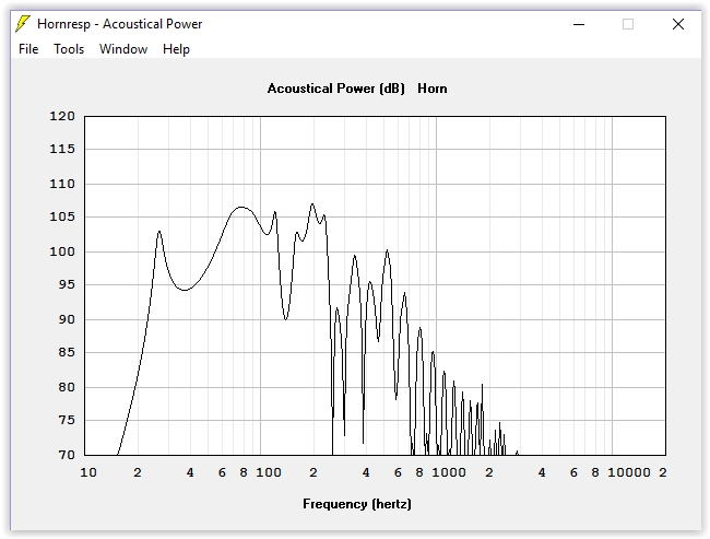

You are designing a whole new enclosure. You could try to simulate this in Hornresp using the TH1 Driver Arrangement. I'll attach a quick stab at this, I made no attempt to arrive at a design or accurate numbers, just move the sliders around in the Wizard, and see what happens.

Hi Jesperino,
Let's see, I just answered a question regarding the use of Hornresp, so here are some links/hints:
http://www.hometheatershack.com/for...scussion/36532-hornresp-dum-hmm-everyone.html
DIY Speakers and Subs - AVS Forum | Home Theater Discussions And Reviews
These are the two that immediately come to mind. David McBean has improved the Help file a lot, and the above tutorials are a little behind.
First try to get a hang of entering driver data, and then get the ideas of what goes where (chambers/ducts), do a few simple examples: sealed/vented/1/4 wave pipe then go on to the tapped horns.
For entering driver data: enter Sd first / double-click on Cms and enter Vas / double-click on Mmd and enter Fs / enter Re and Le / double-click on Rms and enter Qms / double-click on Bl and enter Qes /// to check: double-click on Sd, and a window will show what was entered, and what Hornresp calculated, also, here we can enter Pmax and Xmax.
Look at a few known good Hornresp simulations, and there you go... .
