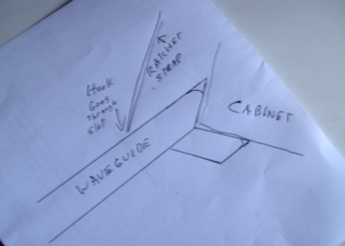

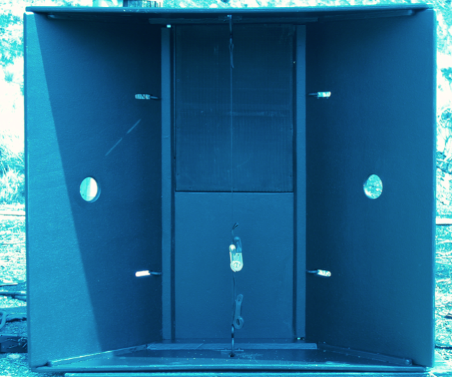

Hi Art,
Do you have any up-close pictures of how your extension comes together and designed for ease of setup, sealing & transport like mentioned earlier in the thread?
The pictures below show how the waveguide is made.Hi Art,
One ratchet strap goes through a slot backed with a metal plate "T" nutted to the top and bottom piece. The top and bottom pieces have two pieces of 3/4" x 3/4" in front and behind the waveguide to form the channels it fits in.
Two ratchet straps are used through slots in the wave guides.
Takes only a few minutes to set up, adds 3 dB forward SPL output with no power compression, yee-ha!
