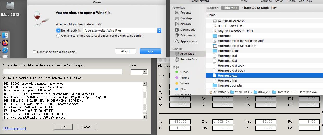

Side note, I unfortunately cannot run Hornresp because I own a mac so these dimensions aren't concrete or based in anything. Don't kill me haha
You can use Wine to operate Hornresp on a Mac.
Have fun!

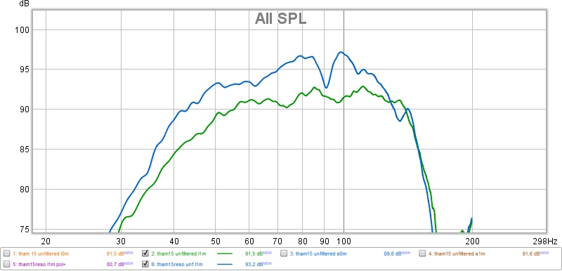

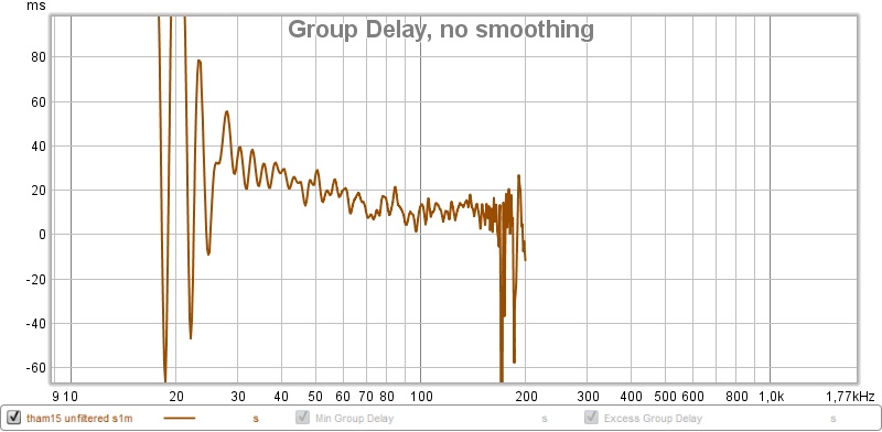

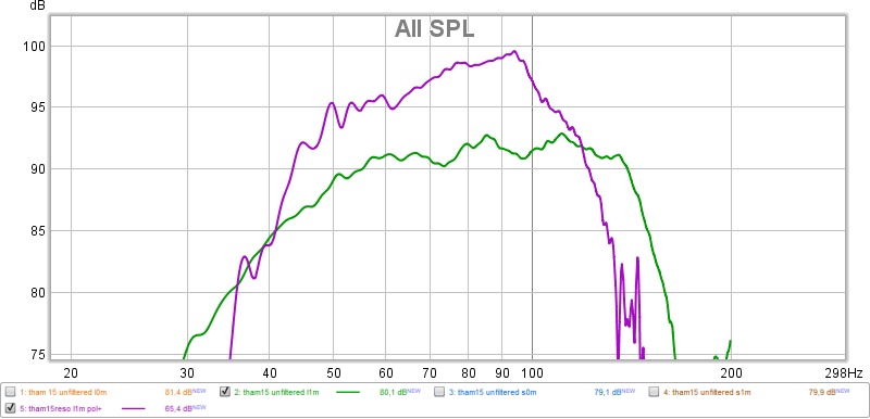

I set the THAM15 and the resonator up in the garden yesterday and tried to make some quick measurements. As a first result, the resonator seems to work. Subjectively, it boosts the bass quite noticeably, adds chest punch and a bit of character, the bass seems rougher. maybe "tactile" is the right word.
Not sure, how reliable the measurements are really, due to background noise and nearby walls (at 6 meters approx). I couldn't specify the voltage, so matching the curves by signal was a bit complicated. Will repeat together with a friend, who is an experienced semi-professional with better equipment.
Driven at aprox. 1kw, the resonator enhanced THAM15 played against two of these Jobst JL-Sat10 tops. Not sure, if two resonator-enhanced THAMS wouldn't outplay them. Seems like I need stronger tops....
For now:

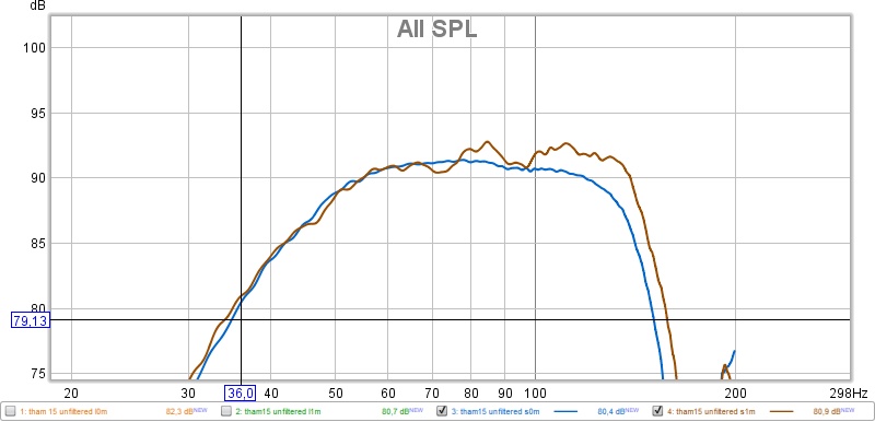

Measurements were taken using a miniDSP UMIK-1, without filters applied, at 0m and 1m distance, in standing and lying position, with and without the resonator (with resonator only in lying position).
Standing at 0m (blue) vs. 1m (brown)

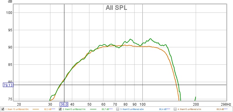

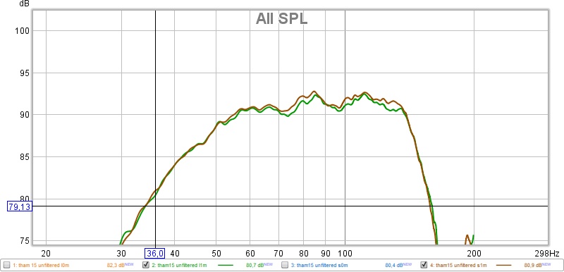

Lying at 0m vs. 1m:
attachment.php
attachment.php
Seems like in lying position it looses a little bit of power:
attachment.php

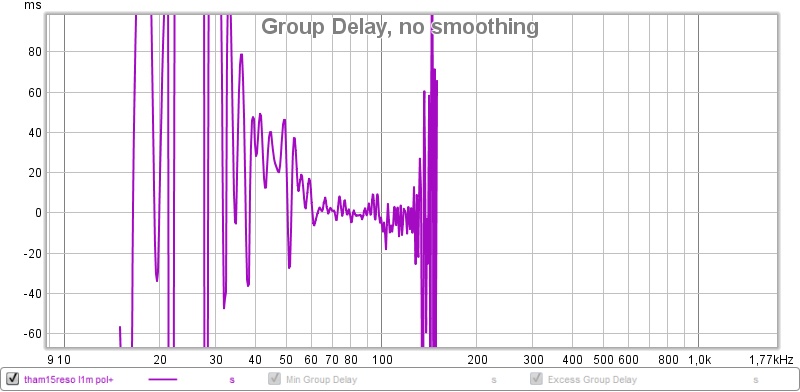

First measurement of the reso:
attachment.php
Weird notch at 90hz. Didn't make much difference at 0m, 1m and 3m. I was a bit disappointed. Resetup and measured again:
attachment.php
attachment.php
Not sure, were the notch went, but it didnt occur again. Any Ideas?
I am aware that this measurements can only serve as a starting point. Next up is better measurements, also in stacking.

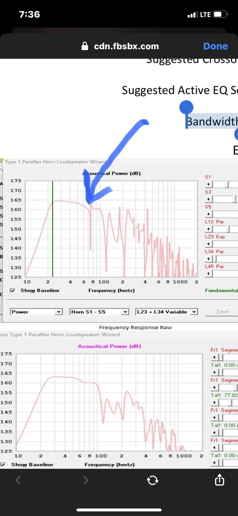

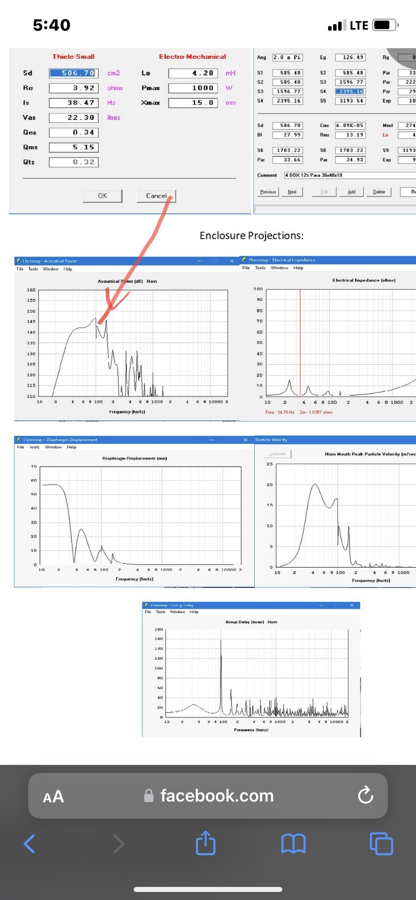

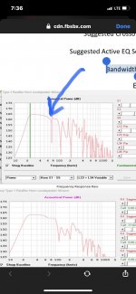

Is the notch a discontinuity between The resonator up front and the rear path? This iis easy to seee/ more obvious in a parallel version where horn response exposes it nicely, if not 3:1 in lengths from both closed ends.. or in OD TLs trying to ‘fix’ the 3Fb notch
